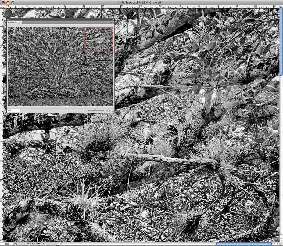

I just had a 44X60" print made from a 6X7 cm Acros negative. The print is stunningly sharp, and is virtually grain free.
For development I used two-bath Pyrocat-HD, 5+5 minutes at 72F, 1:10 dilution.
The attached file may give you some idea of how this combination works. I think the result is pretty much impossible to beat with any other ASA 100 film/developer combination.
In the attachment you are looking at an image file generated from a scan at 5080 spi with a dedicated film scanner. The tree trunk is at approximately 125 feet away from the camera. On the original file you can clearly see all of the veins in some of the leaves near the top of the crop.

Hello Sandy,
Which camera/lens/scanner did you used for the shot?
Thanks!
Armando.
Hello Sandy,
Thanks!
Armando.
Hi Armando,
Mamiya 7II on tripod -- 65mm lens at f/11, 1/15 second exposure -- Leafscan 45, (with two passes and stitch).
Sandy

Hi Armando,
Sandy
Thanks for the quick response! Quite sharp. I can almost touch the leaves.
