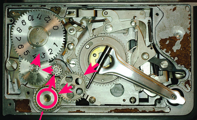

It's an adjustment issue. I don't have time to redraw this but- (not a late model Rollei but the basic ideas are the same)
Look at 3 o'clock, right side. There is a black bar with a knob and silver screw in the middle. The other end of this black bar is inside the film chamber, the little foot on the side that you can push forward (no damage if you push it). At the left end of the black bar is a rivet holding a silver dog leg piece that has a hook on the top end. When you close the back, the black bar pulls this hook 'down' to the back of the camera against a thin piece of metal. You can adjust how much the hook is hanging onto the thin metal edge. The original Rollei adjustment was to have the top of the hook grab the full width of the skinny edge. By making it grab about half of the thin edge instead, it makes it react to thinner material.
As with most mechanical systems, there is variation in how they get set up, wear, etc. And people working on the camera can do these adjustments just because they knew it could happen decades ago. I've had many Rolleiflexes and almost never had a problem with Acros specifically. NB23 is unlucky enough to have a camera sitting on the wrong of the variations.
