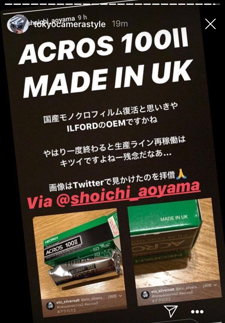

Was doing a late round of IG browsing and stumbled upon this story, Japan being on the 22nd already.
Interesting surprise

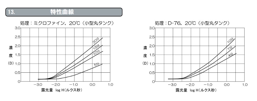

"ACROS II will offer slightly higher contrast gradation in highlight areas when compared to the conventional ACROS film"
Sounds like the shoulder will be even more gentle than Acros, which is already exceptional in this regard.
On the contrary, they are saying that highlight contrast will be steeper, not shallower.
The set on the top is Acros I, on the bottom is Acros II. The Acros II curve set on the left is for Fujifilm Microfine developer.
Yes sorry, I wasn't very clear there. I meant the straight line portion of the curve would be even longer, in effect.
The contrast bump seems to be even bigger with D76, interestingly.

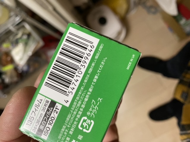

So... the film was made in the UK?
Normally the box would say "Made in EU" but with Brexit coming and going it was probably safer to say "Made in UK"
So Harman Ilford is making the film for Fuji, just like they did with 400CN. It really shows that Ilford is the experts in making B&W film.
View attachment 235052 View attachment 235053

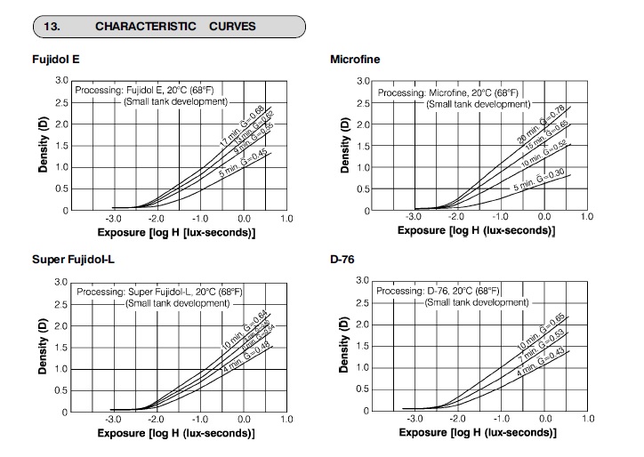

Can you link us to the complete Acros II data sheet?
[edit]
Got it!: https://fujifilm.jp/support/filmandcamera/download/pack/pdf/datasheet/ff_neopan100acros2_135_001.pdf
Looks like it has retained its wonderful reciprocity failure characteristic.
