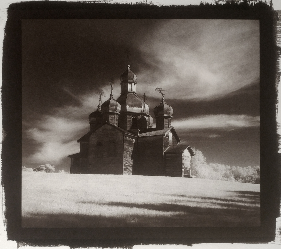

I have 4x5 HIE expired in 1967. I've had it for a few years. Works great at EI 12 with a #25 red filter. That is all I ever used when this stuff could still be bought fresh. With an 89B, I'd give it a couple more stops exposure. A #25 is all you really need, though.
This was expired two summers ago. Developed in Pyrocat-HD. There is base fog of about .30. Easily printed through.
Amazing pic for that age of HIE. It is even more amazing that you are Eastern Orthodox that far West :D

Yes, I am surpised too about the resting IR sensitivity.
