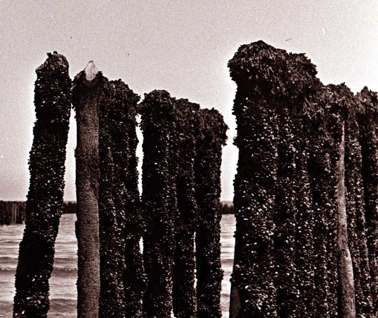

I think this is a good example of possible edge effects.
There is a distinctive glow, noticeable in the around the darkest poles in the attached image.
TriX 320 developed in Rodinal 1+150 for 50'. First 30" agitation, another 30" agitation at 15' (straight negative scan)

Interesting....thanks for taking the time and effort to post the scan.
