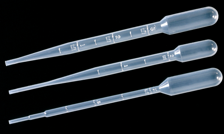

I generally use pasteur pipettes, not syringes. Easier to use. This type:
I bought a box of...IDK, 2500 or so? This will last me several lifetimes. I've included it in my last will & testament.

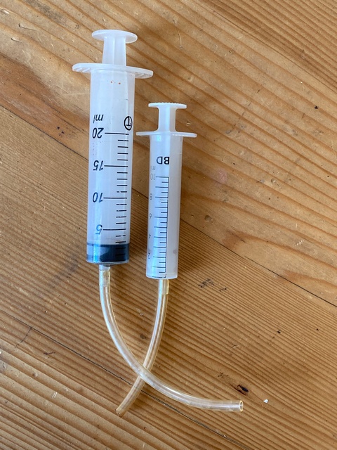

I have a couple of syringes where I fitted a ~7-10cm length of clear flexible pvc tubing on the tip of the syringe. The ID of the tube is ~2mm. This allows pumping viscous liquids, like HC-110 or glycol-based devs. And reaching to the bottom of a 250ml bottle.
I do not push the plunger to the bottom when measuring, because the liquid in the length of PVC tubing might be dispensed as well if there is an air bubble trapped below the plunger. Measure by the meniscus. Dispense between two lines, the final one being not at the bottom. Then return the contents of the tubing to the bottle.
I believe the accuracy for a typical 6ml volume is 5% or better; good enough for amateur work.
