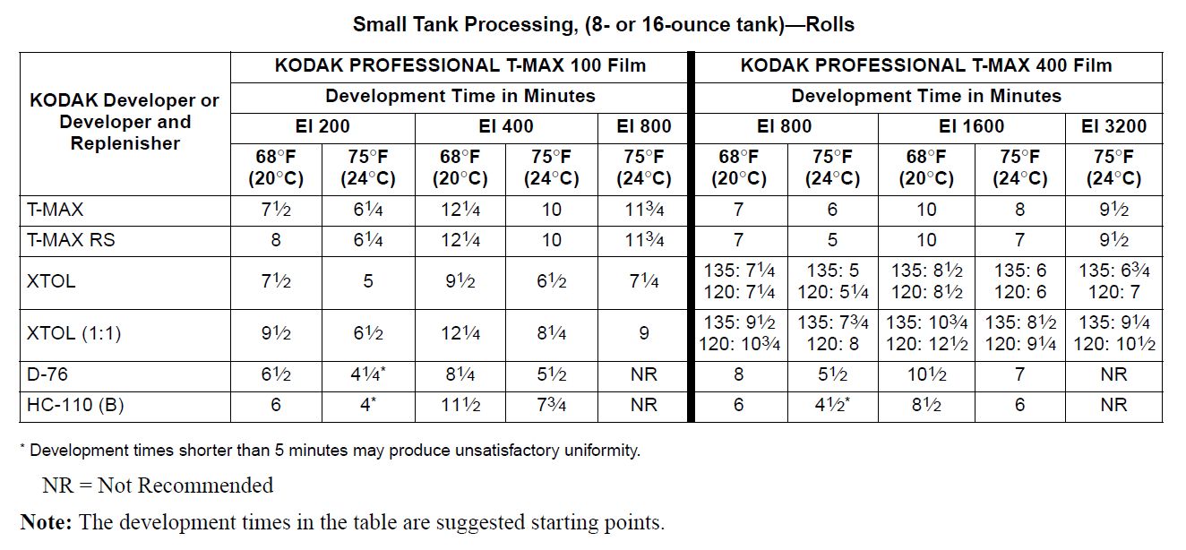

In any case 8.25 is the time Kodak themselves recommend for pushing TMax 100 to 400 so I guess I'll go with that. Thanks again for your time!

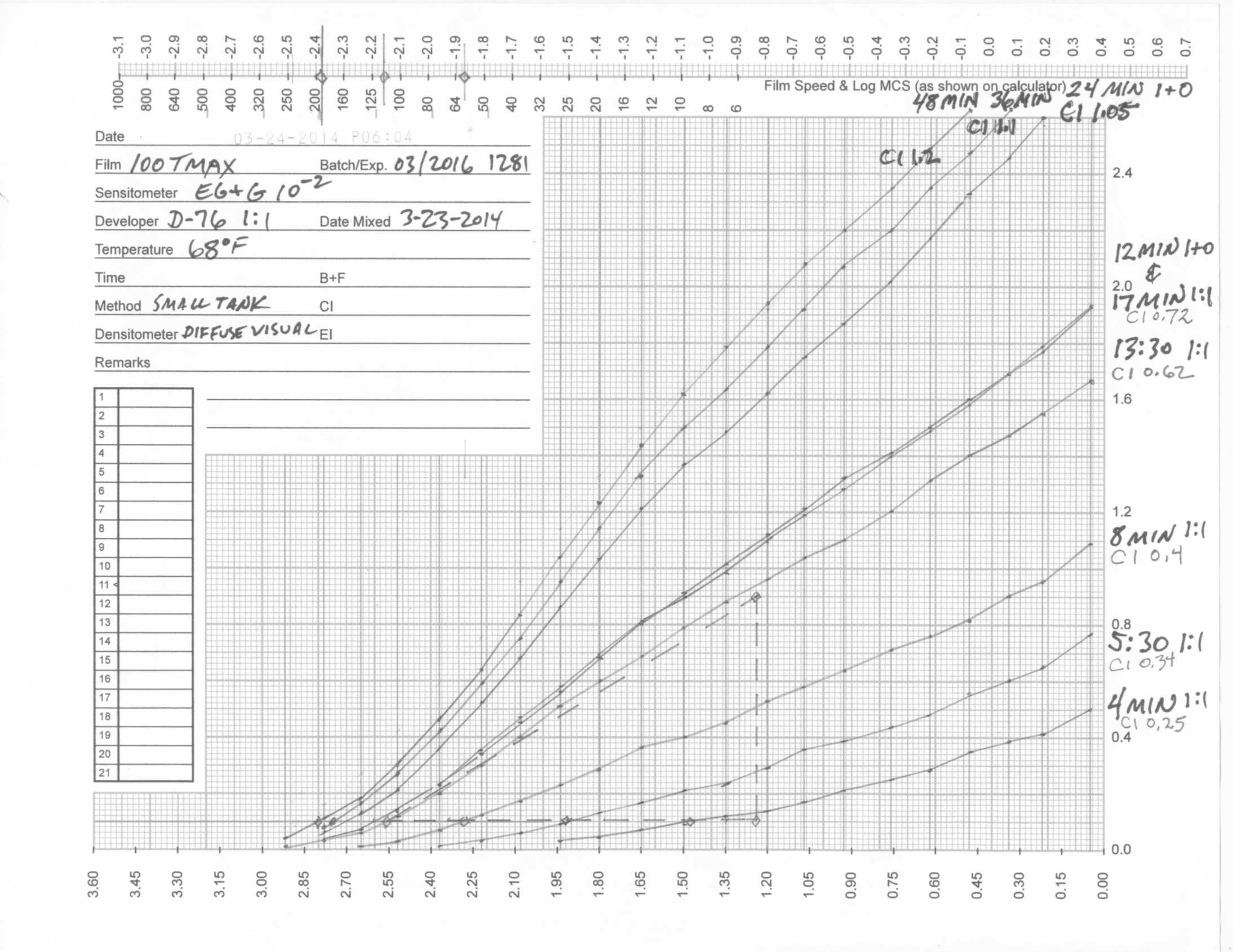

Here's my graph of 100 TMAX where you can see there isn't a gradual toe, it drops straight down.
If you strike 100 TMAX with -2.6 log MCS of light, you will not get any measurable density above B+F no matter how long you develop it. That's "no shadow detail" in plain terms.
If you shot the film at 400, then the light meter reading would have placed exposure at -1.7 log MCS
If you shot the film normally the meter reading at -1.1 log MCS would give density of around 0.7 and if you wanted to get 0.7 from a shot taken at 400, then an appropriate development time might be 24 minutes D-76 straight.
