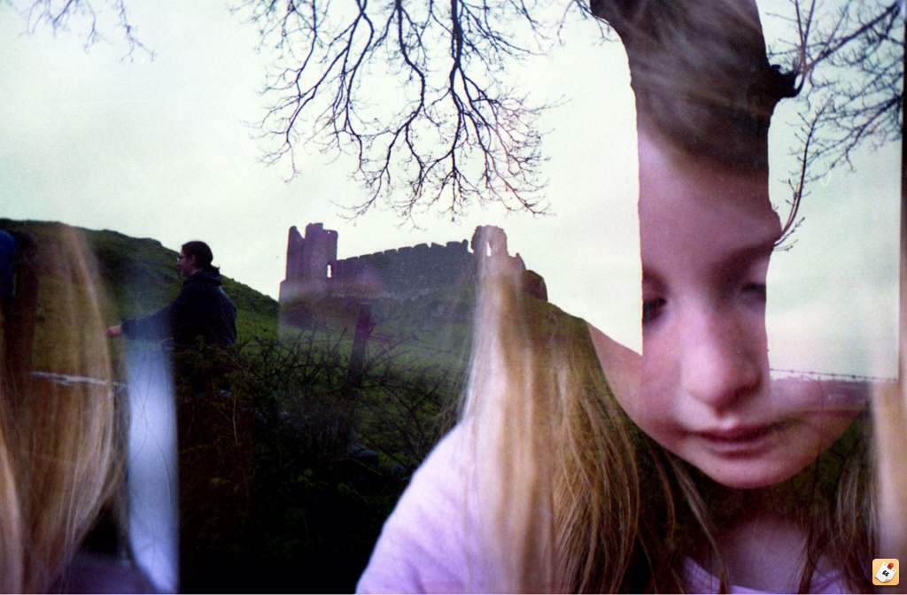

I think I might be on to a record here, my mother in law found a few old undeveloped films, two of them looked like they weren't shot (leader was sticking out) so I shot them this year. Turns out my now wife shot them in university some 15 years ago and now there's pictures of our kids on the same film.
Goes to show how great the longevity of kodak consumer films is.
