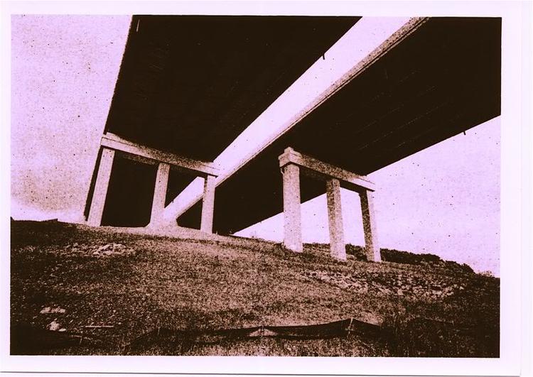

This print is from a 4x5 negative,all the grain evident is from the paper.
Or maybe more accurately, from the combination of the paper, the printing procedure and the process used to develop the image.
The artifacts that make the print appear grainy are fundamentally different than the grain inherent in the paper itself.
No additional silver was added to the printing paper to make the print in post #20, all the grain evident is from the paper; huge visible clumps of silver. Nothing but the grain inherent in the paper is visible.
