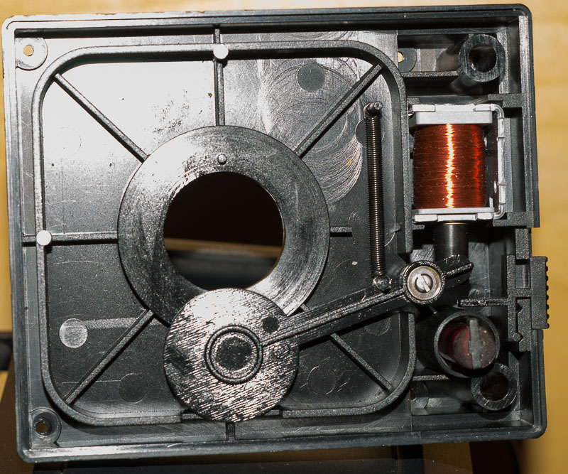

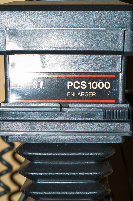

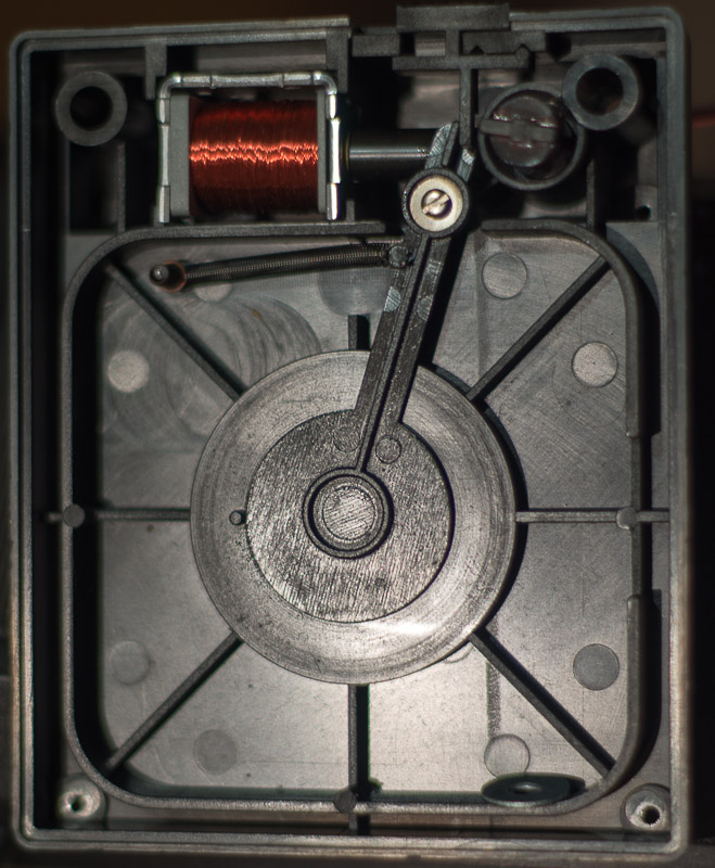

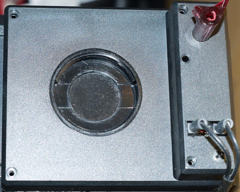

Here are 4 photos on the 'lensboard' on a Paterson PCS 1000 Enlarger
Note the washer that fell out of somewhere :smile:
OK. If you can't get a cheap extension tube, a simple option would be to screw a thin sheet of plastic to the underside of the lensboard and then glue the appropriate mount into that sheet. If your lens has a nut on it, glue the nut onto the back of the plastic sheet and then you can just screw the lens in.
You need to be careful enlarging 35mm since the lens-to-film distance isn't very large so you don't want to extend the lens too far downwards otherwise you may lose the ability to make very large prints.
I think it would be easier/cheaper to find a more common and (probably) more sturdy enlarger than this one. Something with a tungsten+dichroic head, made of metal and with standard lens mounts will serve you better in the long term.
