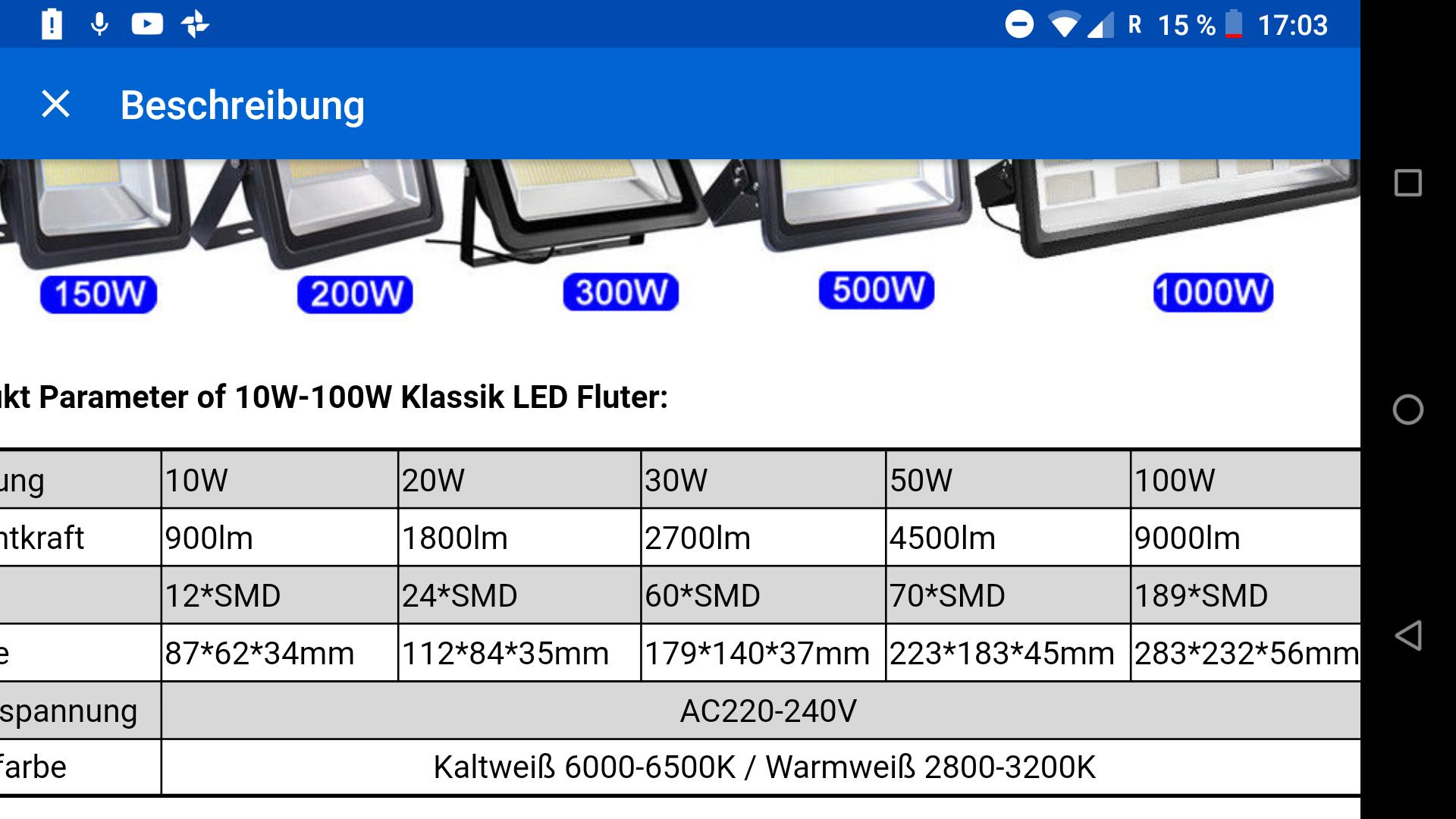

i am making prints 70x55 cm up to 140x75.
And i use a 100w led panel (approx 1000w).
exposure times are around 20-35 seconds.
works out pretty well :smile:

Thanks Chris.
May I know what type of LEDs you are using.
Appreciate photos of the mixing box from inside.
i use the 100w cold white version, i have modified the panel, cut it smaller to fit into the head of my durst m800, but beware of the electricity. needs isolation and cannot be turned on for too long, as it gets pretty hot. i use glass carrier. and two layers of diffusing pergamin paper.
magnifying 6x7 10 times @ f5.6 gives about 20 seconds max for a medium dense negative.
cannot show you right now, im on vacation.
cheers
