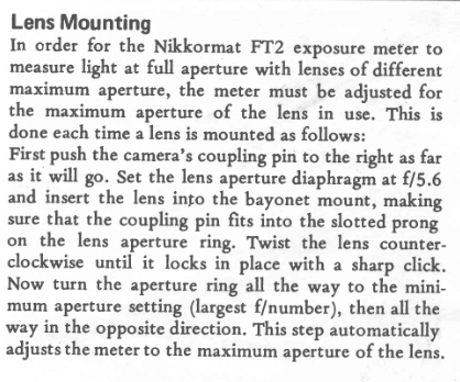

I have a Nikkormat FT2 with batteries installed. Whenever I pull the film advance lever, the meter needle points to the plus sign. No matter how I adjust the aperture and shutter speed, the needle does not move. Does this mean that the camera's metering system is broken?
Have you done this:
I'm afraid that's what it means.
With this generation of cameras, many prefer to use Sunny 16 or a handheld meter anyhow, a nonfunctional in-camera meter is often not considered a dealbreaker.
I remember going on "shooting adventures" with my brother-in-law years ago. He had a Nikon F2 and I had a Minolta SRT102. When he would change a lens, it was a rather complicated, time-consuming "ritual" (see Post #2, above), while my Minolta lens changes could be done in a FLASH -- in the dark! For some reason, he felt his Nikon was superior.
As suggested, make sure you follow the "Nikon Boogie-Woogie", exactly as described. I hope that's the problem.
While I don't have a pre AI body to confirm but I believe if you don't index the lens correctly it would still not do what the OP said. So yeah I think there is something wrong with the OP cameras. When I use a camera with a Cds based meter I tend not to care about the meter but rather use it as if it has no meter. I do want to get the meter working if it's a camera I bought since new. It's not so much functionality but sentimental.
Nikon bring back the Boogie-Woogie when they introduced the F6, D2 series and D200 cameras. They require you to enter the maximum aperture of the lens you use if it's a non CPU lens.
You're not clear. If I recall, until you move the advance lever a little, the meter stays off. Just moving the leve a little allows the meter to come on. What do you get? Explain what you do.
