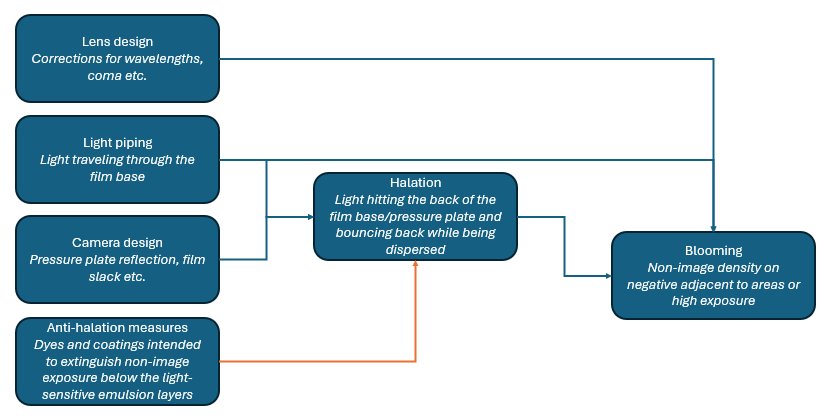

Not AFAIK. It's also wavelength-dependent, and for any given film, it'll make a massive difference whether it has anti-halation measures built in or not. For instance, popular films like the Fomapan series have quite decent anti-halation in sheet film and 120 roll film, but lack this in 35mm format. Yet, the datasheet is the same for all products.
Btw, going out on a limb here - I'd say that 'blooming' is the visually apparent effect/outcome, and 'halation' is one of the mechanisms that can be responsible for it (imperfect lens optics being another obvious mechanism). Furthermore, I'd say 'halation' and 'light piping' are comparable effects, although the latter is more often associated with choice of base material while the former is used in conjunction with descriptions of film stack design. The way I see it, light piping in the base will contribute to halation, which will show up as blooming. You could make a conceptual model out of this, describing the different causal relationships, and use that to further explore the topic.

No doubt; the gist of my message was to stimulate you to conceptualize how the different effects relate. How you define each of them - well, that's debatable and some desk research should be able to clear up most of it. And in the end, it doesn't really matter how you define things, as long as you're consistent.
Here's the kind of thing I'm thinking about:
Notice how I define (my own, subjective definition!) Blooming here as an image effect. As contributing causes I discern Light piping and Halation as separate, but also causally related effects. I consider Blooming as a single construct, because in the final negative, it's often impossible to determine what the specific causes were for the non-image density to form - it all tends to show up as a halo around an area of intense illumination, and only through rather subtle and sometimes indirect clues can we figure out what may have caused it.
Now, I don't post this to say that the above is the only correct representation. The message here is to try and bring conceptual clarity to your thinking, and then use that insight to decide how you want to model this behavior in your simulation. Also note that the conceptual model above is far from complete, plus the existing parts could be refined (split up into underlying factors & relationships). How far you want to take this depends on what's needed to get the job done, and that in turn depends on the goal you've set for yourself. You'll have to make your own choices there.
You could even expand the diagram to include other aspects of image characteristics such as grain etc. - but I understand you have already tackled those, so perhaps you have little interest in going through a conceptual phase for them. It may still be valuable for the documentation of your project, though.
Just my $0.02; see if you can take anything useful from this.

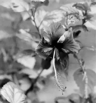

My point of view is, the simulation of an analog process using digital means doesn't have to be 100% correct if the result looks faithful. There's always a way to make it better, after (do you know about the wheel of improvement?). That's what I am experiencing with my desire to make my simulation better. At first sight, it looks silly to add defects, no? But finally it showed the limits of what I had achieved so far.
For example, I'm at the point where the simulation is already good as it is, and is at least as good as several commercial products. I could compare several scenes taken both with digital and analog cameras (and several types of films). I applied my method to the digital pictures, and the results were comparable to the analog pictures.

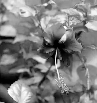

Here is an example found here.
On the left the digital version, center the Ilford Ortho+ version of the same scene, and on the right my Ilford Ortho+ simulation. The digital version has much less details in reds than the analog version and impacts the simulation, but if you look carefully: the gray levels look good, as well as their distribution. And this was just from a little JPEG file, without color calibration!
With several examples like that, with different films, I knew I was on the right path... and it's not finished.

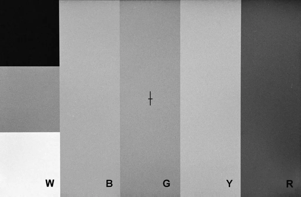

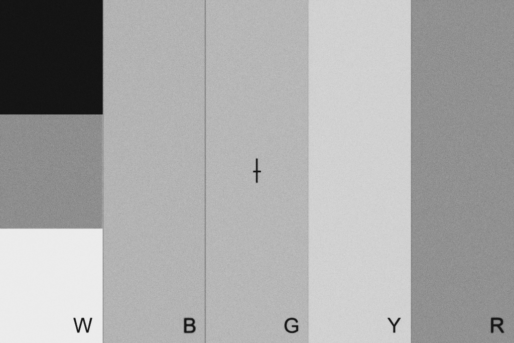

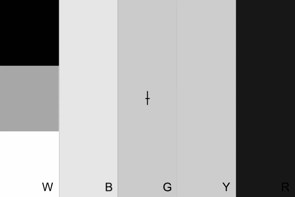

Another example: from the same website, I used the test target:
Ilford Ortho+ on the left the analog version, on the right my simulation (without grain).

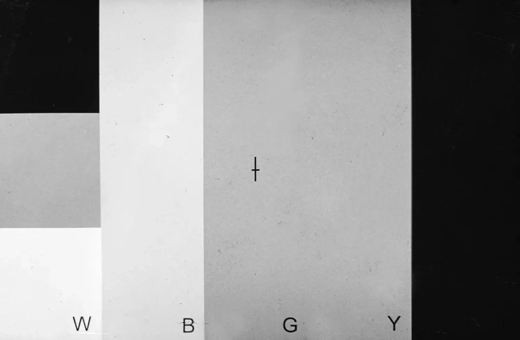

Now Ilford HP5+ (with grain)
This one looks a bit different: grays and blue and yellow look good, green and red are too light - maybe more control on the development would help
