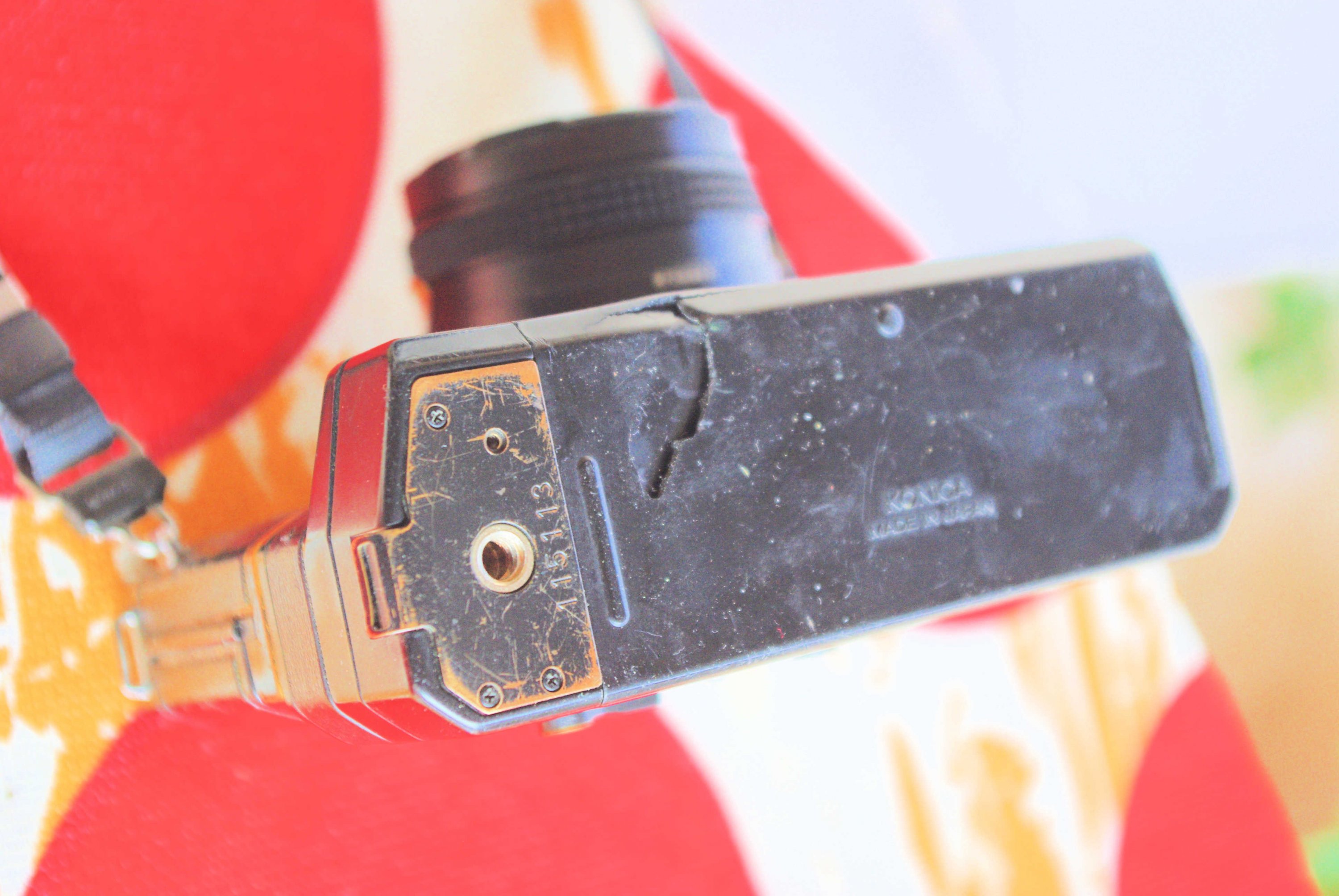

This morning I was shooting with my Konica T4 with winder. I had just finished a roll and swapping bodies for a T3 when there was a bang, it took a while to figure out one of the 6 AA batteries had exploded. There some sort of battery fluid all over the batter compartment and the bottom of the drive had been blown open. I was shooting with a monopod so I didnt feel the battery getting hot. I used many motor drives and winders over the years, Nikon, Minolta, Konica, Chinon and never had a battery explode before. Attached is an picture of the damage to the winder.

Mine sure did, was at the Desert Botanical Garden at the time, I had just rewound the film, manual rewind, I did test the shutter and the winder still worked on 5 batteries. I have a second winder, so I will swap out, or might just repair the plastic with epoxy and keep using this drive.
Was in your case the cylinder torn open?? Or "just" and end cap went off?
The cylinder or body of the battery split open, I did not have a plastic bag so I tossed all the batteries out as they were coated in the gel from the exploded battery.

The batteries were new, right out of the box, had shot a roll of film a few days before, had taken the batters of the winder and camera. I use hearing aid batteries for the camera, the T4 takes 2, I put tape over the holes on the + side of the battery so they will last a little longer. The AAs I keep in the same bag as the Konica Kit, T4, winder, T3, 28, 58, 135 and 200 with small flash. As I shoot with a number of different 35mm I remove all the batteries as it may take months before I shoot that same camera again.
Never had a lithium explode, had one that hot really hot in a Pentax IQ Zoom that I could feel the heat so I was able to remove it. Has a rechargeable Lithium get so hot I fearful that it could catch fire, it was on Sigma SD 17 which is know for hot bottoms. I take all my batteries out, film and digital.
