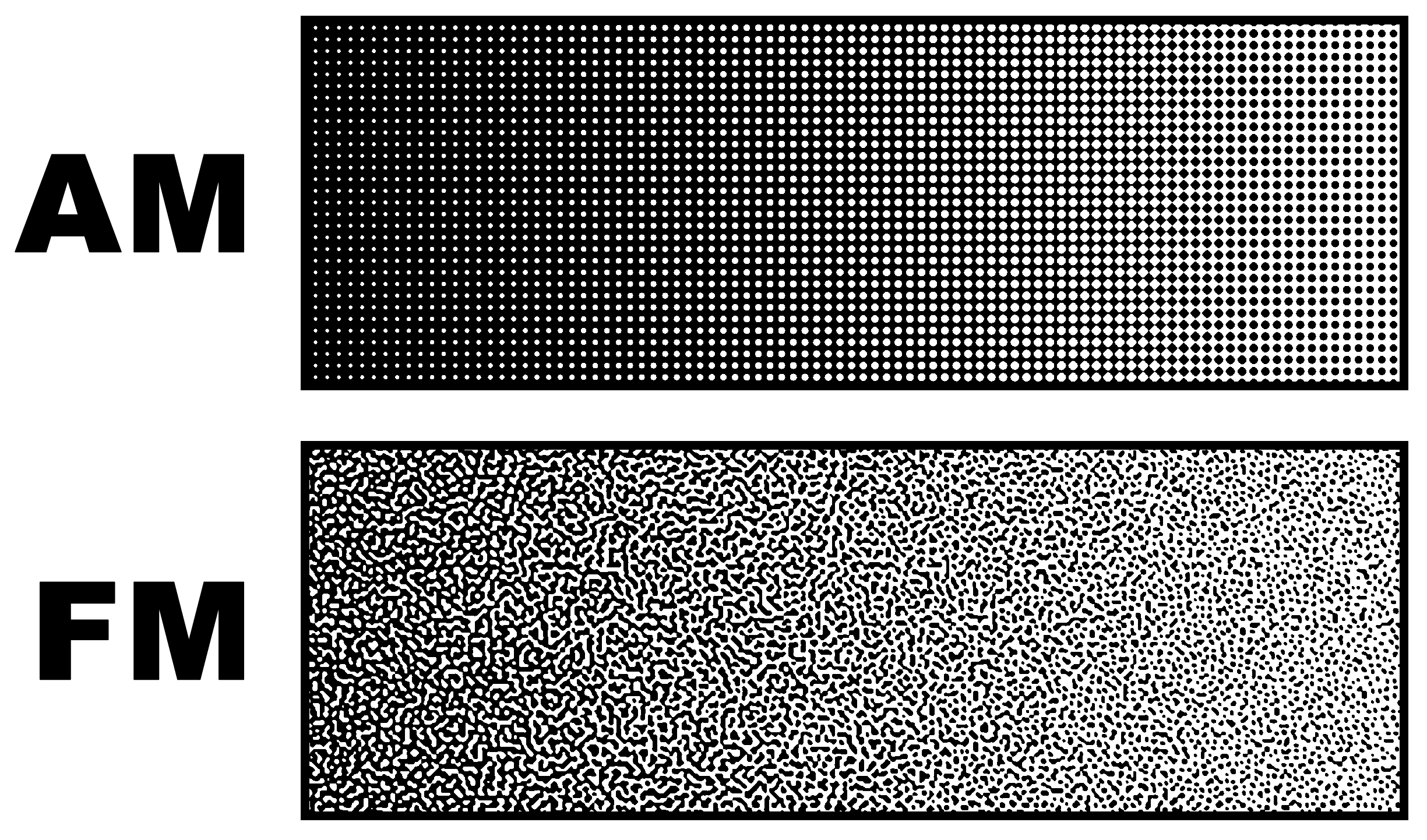

To understand the real resolution in terms of PPI from the 1200dpi laser printer, let's assume the printer needs to be able to create 256 shades (including white) by clustering small dots in a grid pattern. Since every dot is either white (unprinted) or black (printed), this means that an 16x16 (=256) grid is needed to create all required shades. This means that the effective ppi of the laser printer is actually 1200/16 = 75ppi. That's a pretty abysmal resolution, and in practice it isn't quite so bad since the grid approach I just described is only a very crude and simplistic way of arranging individual dots; it's what you get when you use a typical 1990s laser printer with AM (amplitude modulation) halftone screening (see example below; taken from here). So your typical HP LaserJet II from 1994 or so may indeed be limited to about 75ppi prints. However, printer manufacturers adopted FM screening (frequnecy modulation) which, very simplistically put, scatters dots in a quasi-random fashion instead of printing a neat little grid. The results is the little wormlike patterns you may have seen when looking at a laser print from up close. Inkjet printers also use FM screening; moreover, they rely on dots bleeding together a little as the ink fans outward into the paper a tiny bit, making them blend together a little (this is not possible with laser prints).
To cut a very long story short, it turns out that most of the desktop printing systems we generally use have an effective imaging resolution of around 300-360dpi - although a concrete number is impossible to give when FM screening is involved. However, resolving power is somewhere along these lines in a best-case scenario, although for inkjet digital negatives, you often end up at a little less than this. I frequently print cliche's for PCB manufacturing on my Epson 3880 inkjet printer and the smallest features it will reliably image are around 0.12-0.15mm or so, which means that the real resolution of the black ink channel used in that application is around 200-250dpi.
