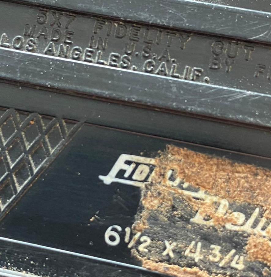

At least 2 UK sellers on eBay have listed Half Plate 6½" x 4¾" DDS often also marked as 12x16.5 cm, as 7x5 (5x7). These holder will not take 7x5 film only Half plate.
Modern Half plate, European 13x18cm and US 7x5 (5x7) DDS Film holders all have the same outside dimensions, so all fit International backs (for the formats). However, they can only be used with their marked film sizes.
