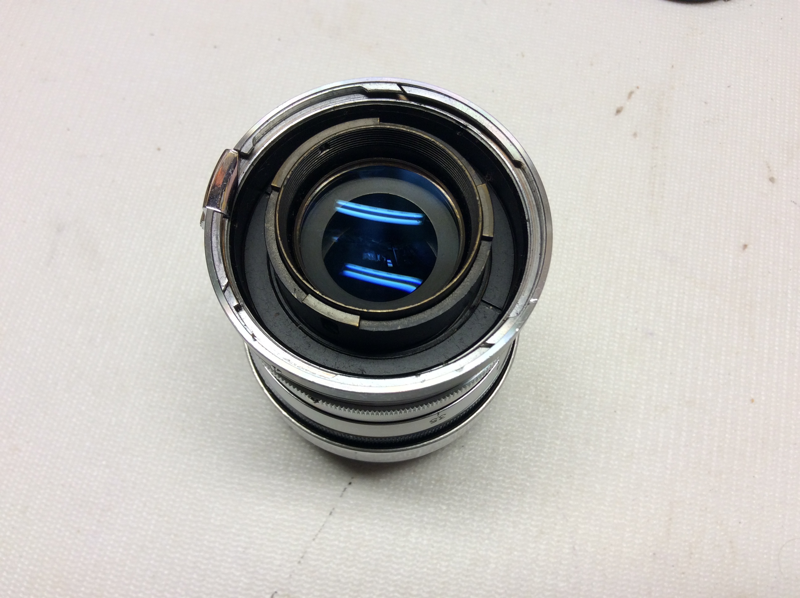

That looks all wrong. I’m attaching (if it’s not too large) a photo of the rear mount of a chrome Nikkor 85mm f/2 lens for S-mount. As you can see, the internal part with the three “ears” on the end is designed to engage with the focusing mount on the Nikon S2 body. You’ll see that the three ears on my lens are different from what they’re selling. That rear mount looks like an adapter to me, maybe for Nikon F mount — it wouldn’t couple and it wouldn’t turn to focus. And as you note, it entirely lacks the outer mount for the Nikor S.
I’d pass, if I were you. BTW, how’s that R2S body working out for you — nice to use? Thinking of getting one...
Many thanks! Your post shows the "latch" present on my Voigtlander 21 and 35, and my Nikkor 105 and 135. and absent from the EBay pictures. I feel that their presentation is deceptive; my search string was for the Nikon RANGEFINDER camera.
