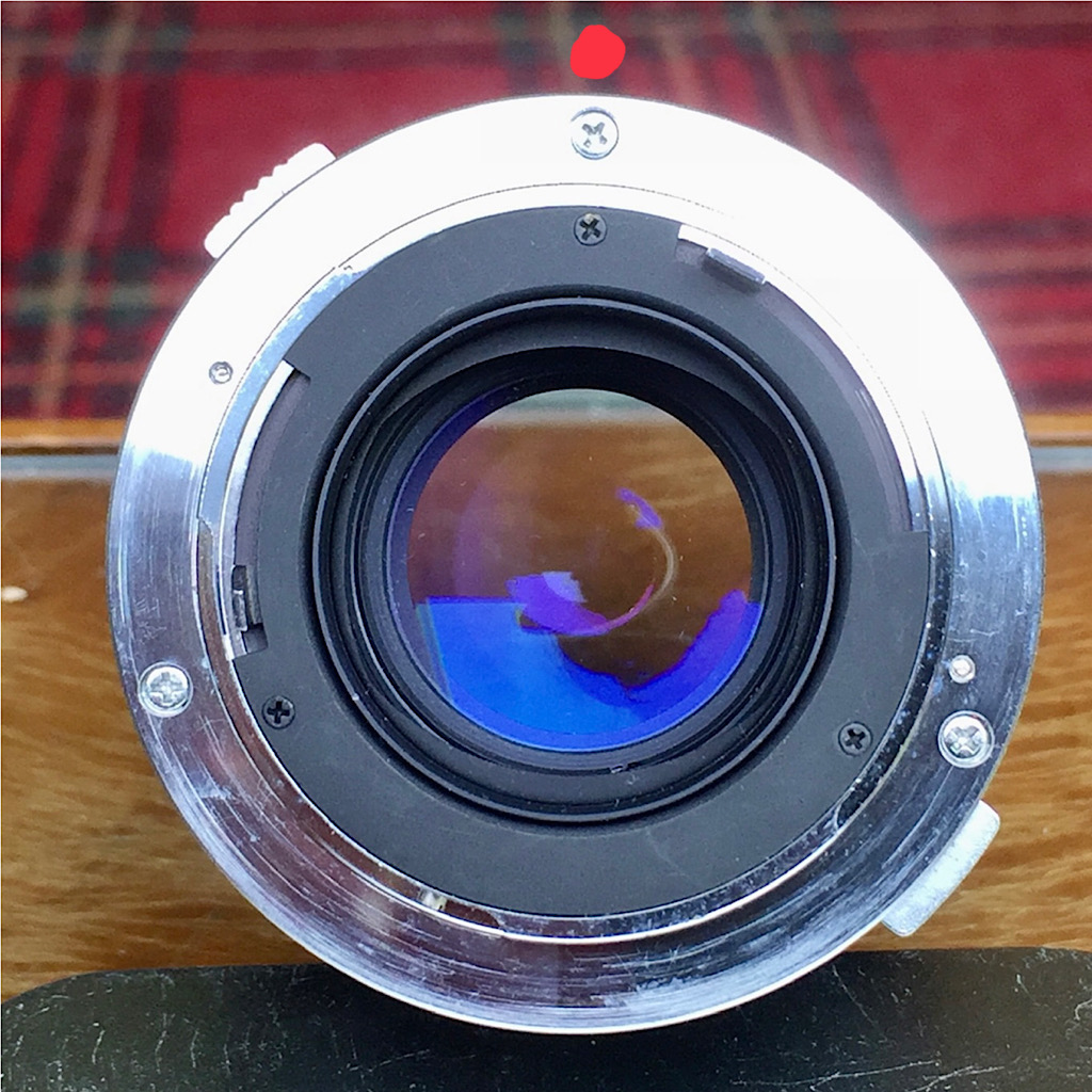

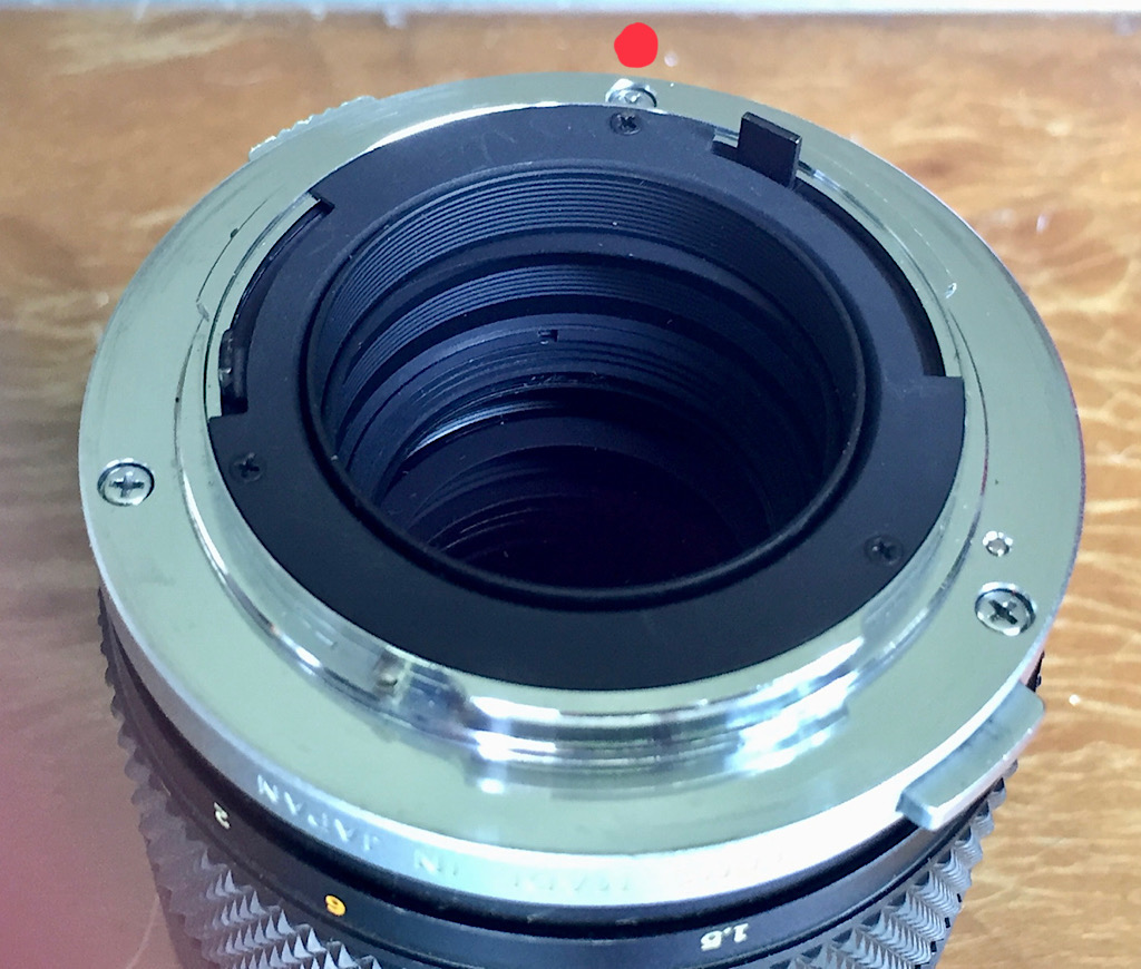

It looks like a light baffle of some sort, the thicker parts of the ring are positioned top and bottom so roughly following the rectangular shape of the exposed negative. The red spot on the photos below is the top of the lens when mounted on the camera.
It's difficult to tell from the exploded diagram but I think you may be right that it is CB095100, nothing else seems in anyway close to the shape.
It looks like a light baffle of some sort, the thicker parts of the ring are positioned top and bottom so roughly following the rectangular shape of the exposed negative. The red spot on the photos below is the top of the lens when mounted on the camera.View attachment 338906View attachment 338907
Thanks, I see now... I'll try to fit it back the way it should be
Looking at the lens from the rear, it seems to sit at the end of the ribbed section of the tube that moves in and out as the focus is adjusted, so about 5mm in from the end of the tube. Good luck.
