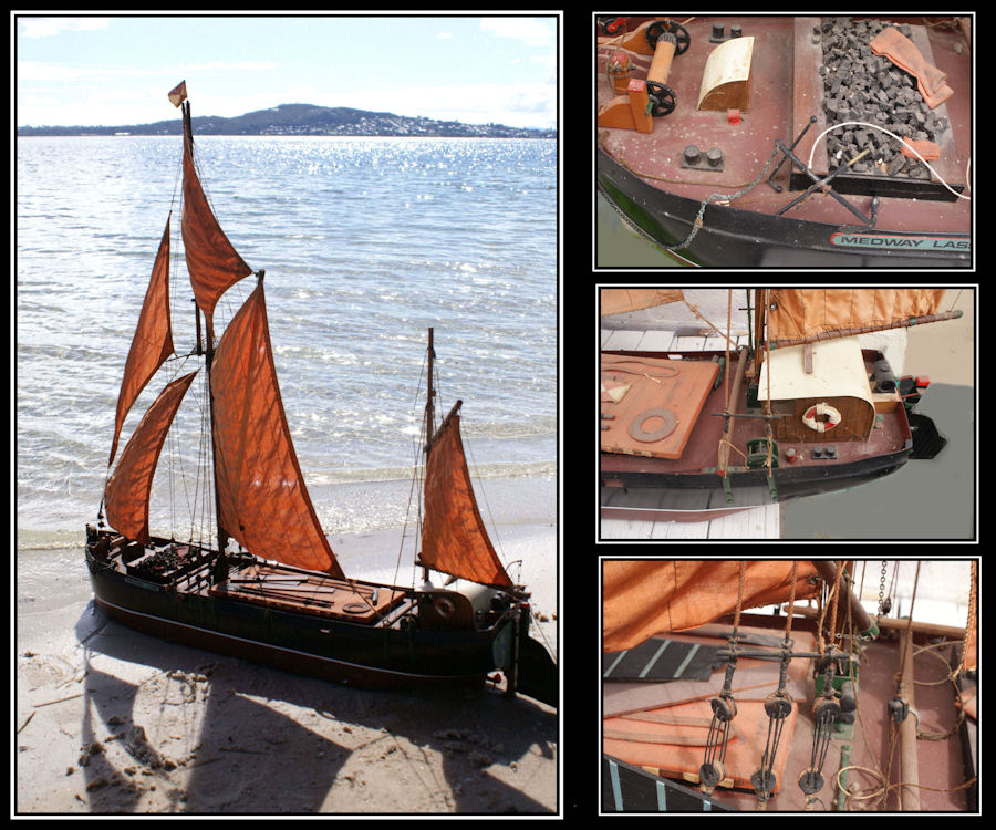

My 40 + year old model Thanes Sailing Barge that was under going a renovation once all ship shape a pinhole camera would be fitted .

The barge take a few years back before it was in need of a little work,
The original camera on the deck of the barge.

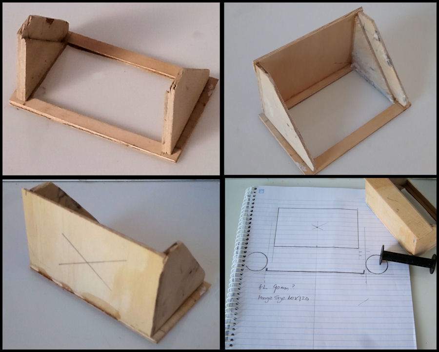

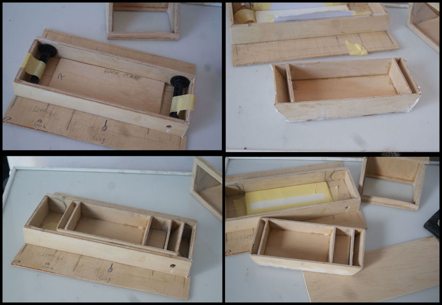

Work has started on the new reflex pinhole

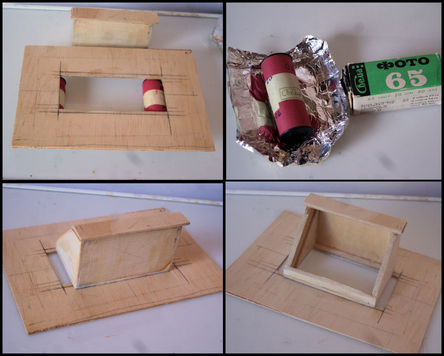

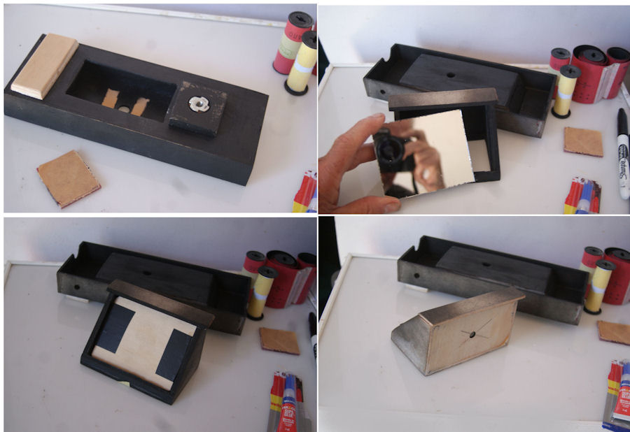

Working on the film deck
I found a roll of Siberian film squirreled away

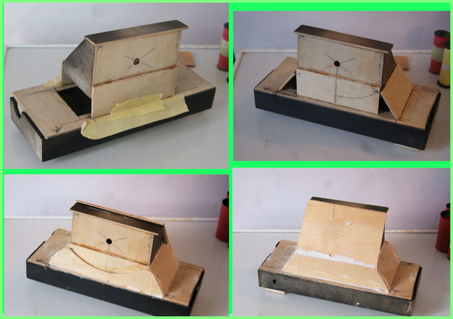

Paint the film deck and start on the top

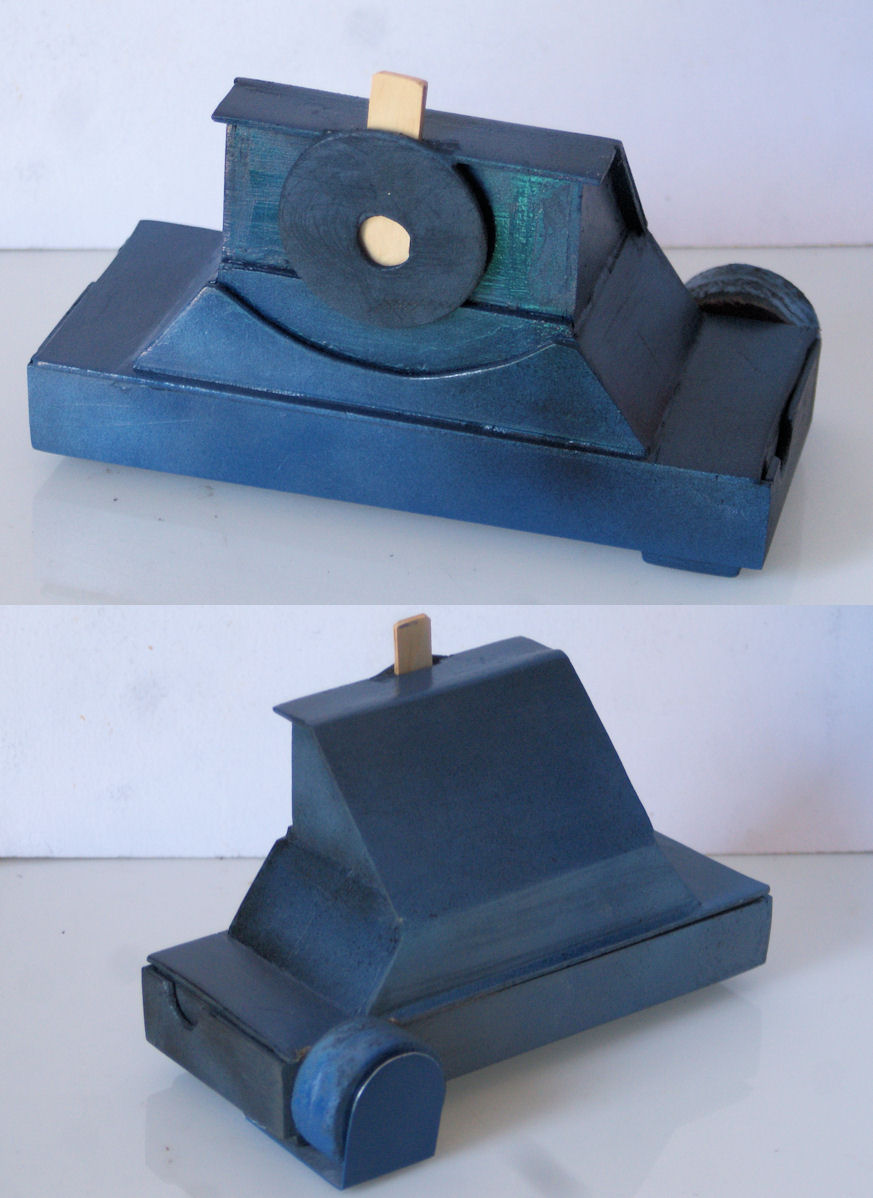

Add a dab of paint and it's looking very smart

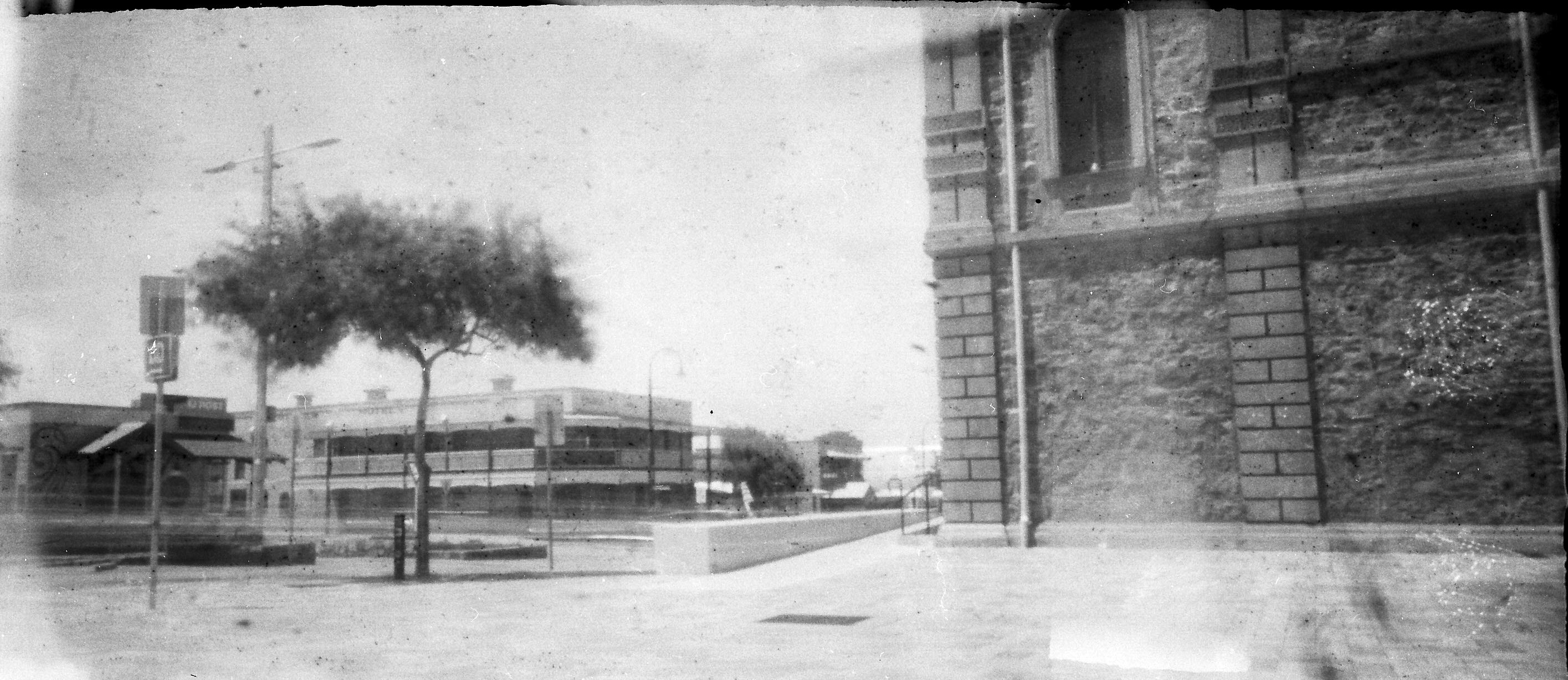

I thought why do a film test.
The film was very old so I rated it about 50 asa and processed in coffee.
Well the negs where so dense , dip 'em a farmers reducer should help
I must order a few rolls of fresh film and developer.
The new Foma it any good?
Okay the question could I be happy... what do you think Col.
