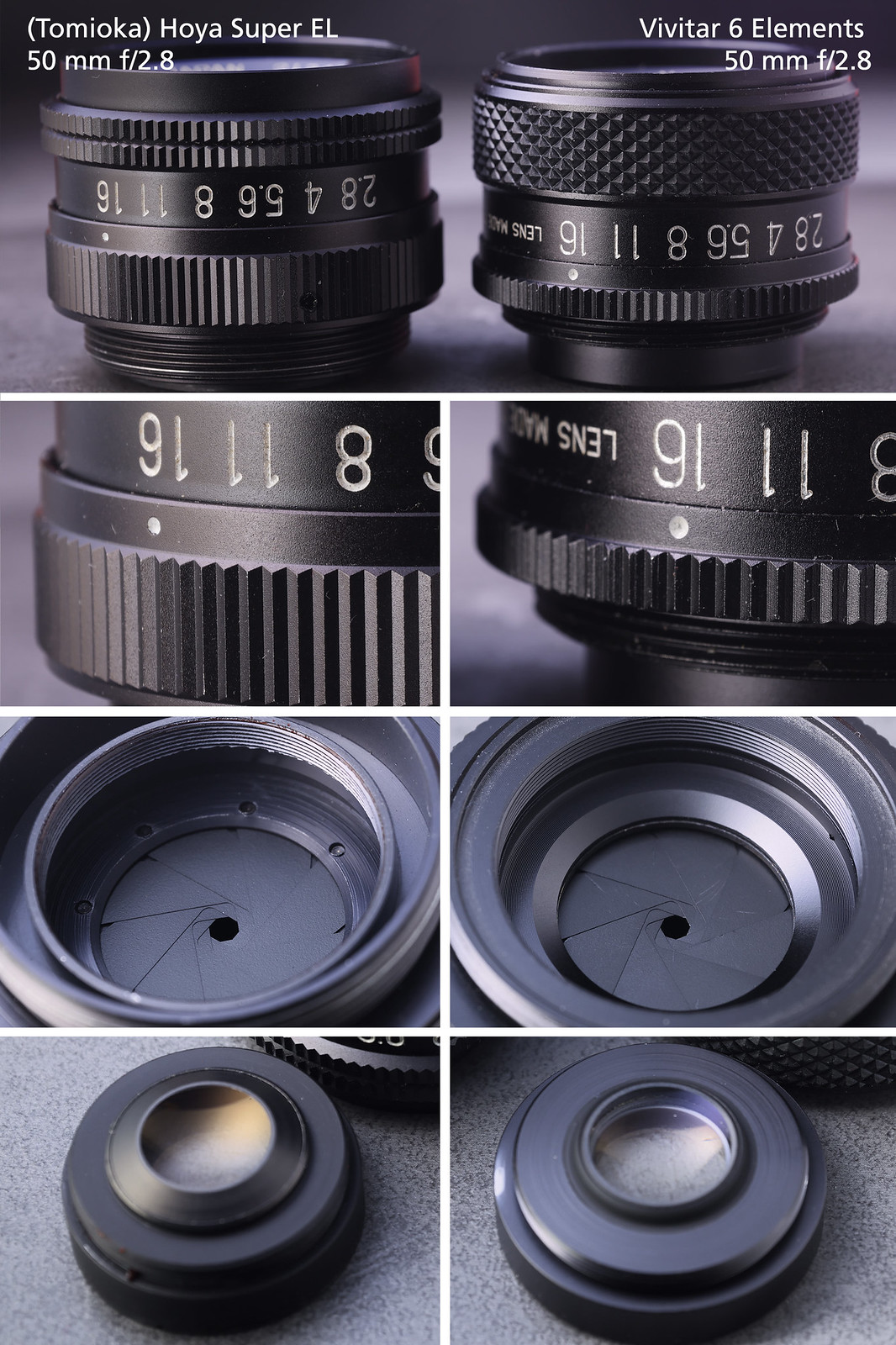

BTW. I found the image where I compared the Vivitar 50 mm f/2.8 6-element one to the (Tomioka made) Hoya EL 50 mm f/2.8:
Is it possible that there is a connection? Perhaps... but I don't think the similarities are overwhelming. I'd rather suspect that those are different lenses/have different manufacturers. Also Tomioka doesn't seem to be the first production house that comes to mind, when I'm thinking of Vivitar.
And this lens is definitely different from the Series 1 design you found in the photokina reference. Also it's not a 'line' of lenses. As far as I know there's only this one.

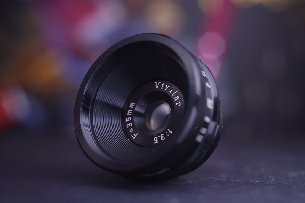

8. Vivitar 35/3.5 were triplets: it's printed on the packaging.
9. The six-element 'fast 50' is tantalisingly similar to the Hoya EL, but can't be conclusively identified as such. That lens came in two versions, [V2] superceding [V1]:
9a - Version 1 (pictured above) was AKA Spiratone Resomax, Jessop, Vivitar, Fujimoto, E-Lucky and Phago - all were serialled. All have straight-8 diaphragms. They date from c.1980-1984. Vivitar marketed it as part of their 'Flat Field' range.
9b - Version 2 (likely upgraded and post-1985) was AKA Spiratone Resomax, Jessop, Vivitar, Fujimoto, Durst Optar and Cambridge EL Pro Cambron - none were serialled. All have straight-6 diaphragms.
19c - I'm still finding new versions of these lenses under different names, and still not sure of the manufacturer. If you have any theories or find any variants Delta doesn't yet know, please let me know.

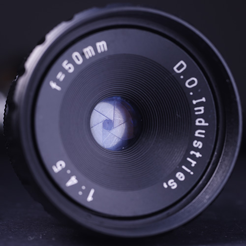

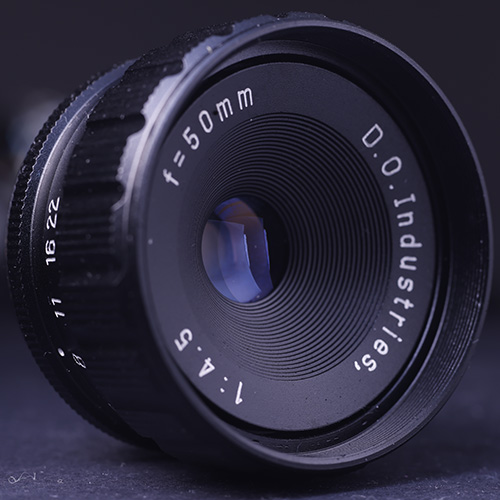

I own a D.O. industries version, albeit a simpler 3 or 4 element f/4.5 lens.

As I've mentioned, I only have a 50 mm f/4.5 one:
I wasn't aware of the fact that Fujimoto had lens production capabilities. I only knew of them as being responsible for producing the enlargers and assumed they were buying their lenses elsewhere, but I've honestly never looked into their history. Of course they might be the most likely candidate then.
