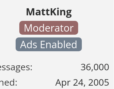

For posterity, since it will change very soon :smile:
Thanks Ned - I think!
(don't mention this to my wife)bandit:
