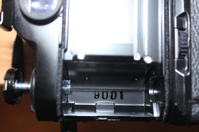

Essentially, you want the latch for the back at the bottom when you're reading it. The 6 might be a C. In any case, camera was a January 2000 build. That is, unless the 1 happens to be a somewhat worn 7. If you can, could you grab a pic of the date code?

James-EG
Sep 27, 2012
100
Surrey, UK
-J
Ah okay, here's a picture of the code. Hope that helps!
