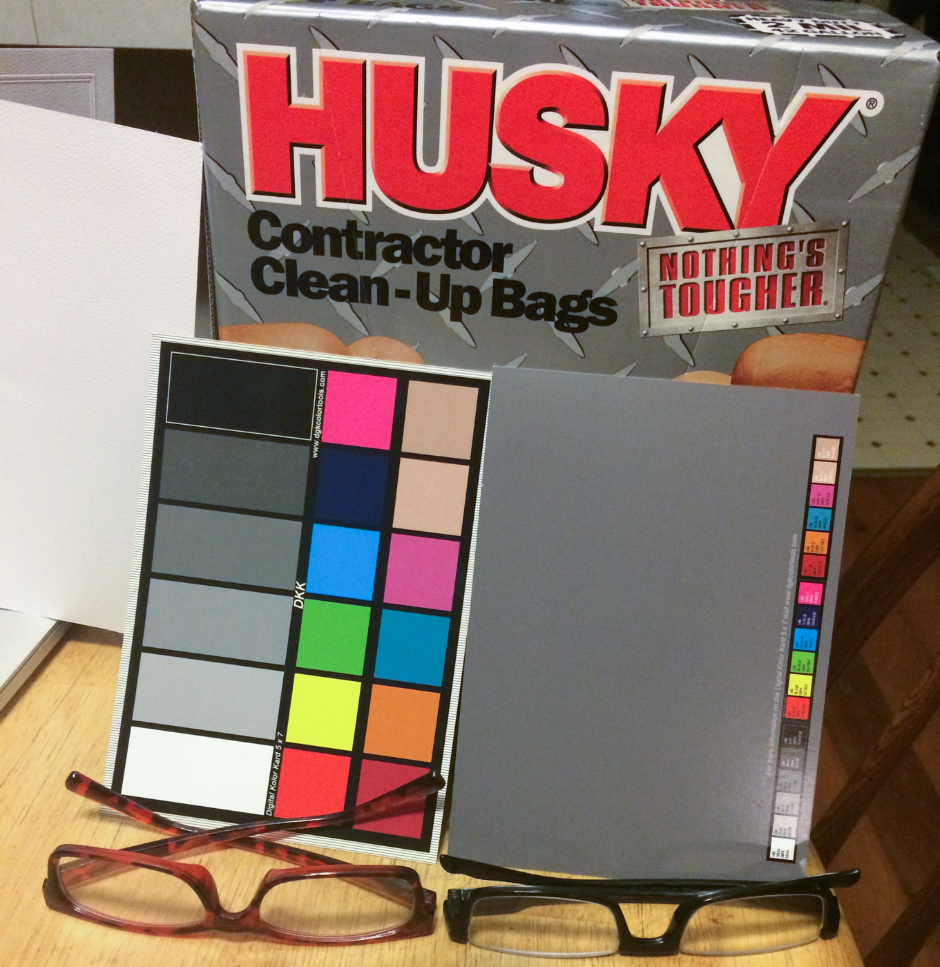

This is what I was shooting at just now. The left size has several zones (3 to 8) and the card on the right is a giant zone V card.
rpavich
rpavich
Aug 24, 2015
1,520
West virginia, USA
Well...I think that this mystery is just about solved.
I shot this as I said, spot metered for zone V with the grey card you saw above and for the metered reading of 1/30 at f/2 I got the following density numbers:
All metered from the zone steps on the left side of the card with V metered from the large 5x7 area:
V = .95
VIII = .34
III = 1.37
With setting the camera for 1 stop UNDEREXPOSED (based on the spot meter of the grey card) I got the following:
V = .75
VIII = .13
III = 1.22
It appears that I'm overexposing or said another way, for "stock" development that underexposing 1 stop gives me a zone V that is dead on the money...right?

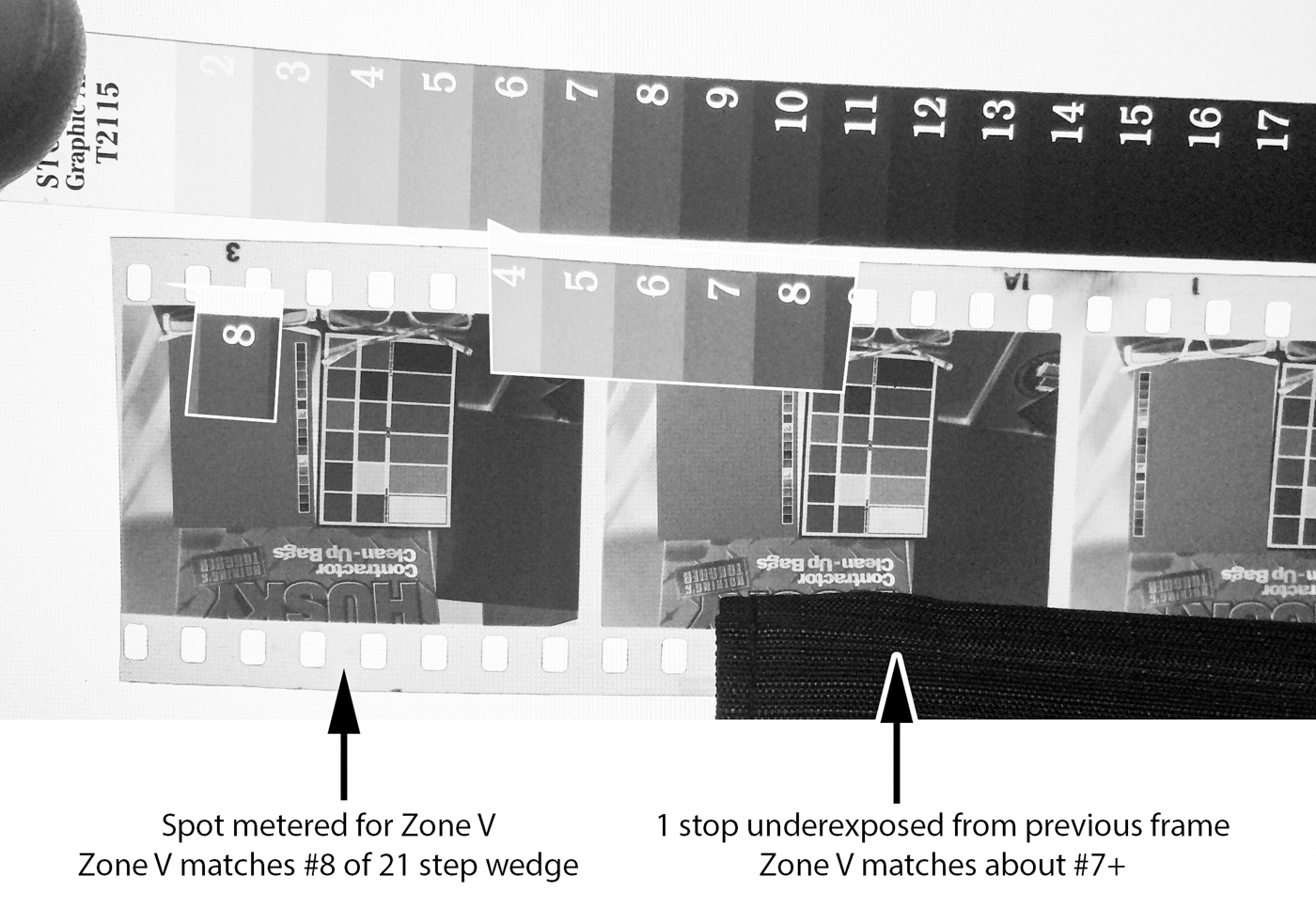

And here is an iPhone shot of the negative and step wedge.
are we SURE that zone V should match the #6 step and not the #8?

About zone 7 is looking good possibly more development need for increased contrast density in the highlights - Zone 8. Placement of zones V & III I reckon is on the money. But, just to clarify, you measured using the spot meter with your camera in manual mode you either increased the ISO (400 to 800), increased the shutter speed - to 60th sec or increased (closed down) the aperture for an under exposure result? Fred

I measured using a pentax digital spot meter for all of this.
For going "one stop under" all I did was use the same exposure as previous shot and increased the shutter speed one stop.
I'm very surprised.
Both the "box speed" on this last test and the "one stop under" printed very well at grade 2 but the "one stop under" printed better. I'd have never predicted that in a million years.
For both prints I metered the Zone VIII for the highlight and the Zone III for the shadow and then increased the time until they were at the very ends of the Analyser pro "grey strip" (about 1/12 or 1/6 of a stop)

Grin.. QED! It appears you have come down the 2 stops originally over exposed to this stage. Your 15th sec @ f2.0 has become 60th sec @ f2.0... Next time, if you still have more of this film, try a little extended development or more agitation to increase the contrast a little more... Lastly, are you using Xtol diluted? If so you would gain a little film speed as a result. Fred

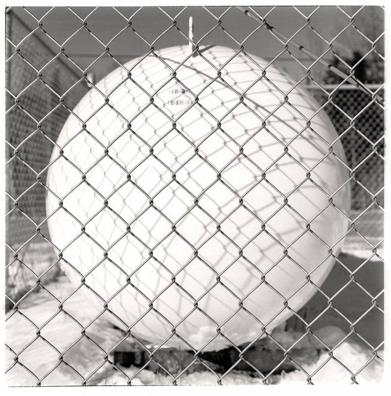

This is the image I used to base my exposure/development on:
PanF+ at ISO 40, developed in DD-X 1:4 for ten minutes. This image prints super easily at grade 2.25 or 2.5 in my darkroom with my usual materials. I read the highlights on the snow in the lower right corner, and this is what I've been using to fine tune my subsequent testing. The white on the tank is slightly less dense. In printing I burn in that corner a touch to keep the circle stronger.
Highlights: 1.55
Film Base + fog: 0.08
If I find my step tablet I can post a shot of the neg with it, but I've not seen it since my move here 6 years ago. Emailed Stouffer to see what they have left.
