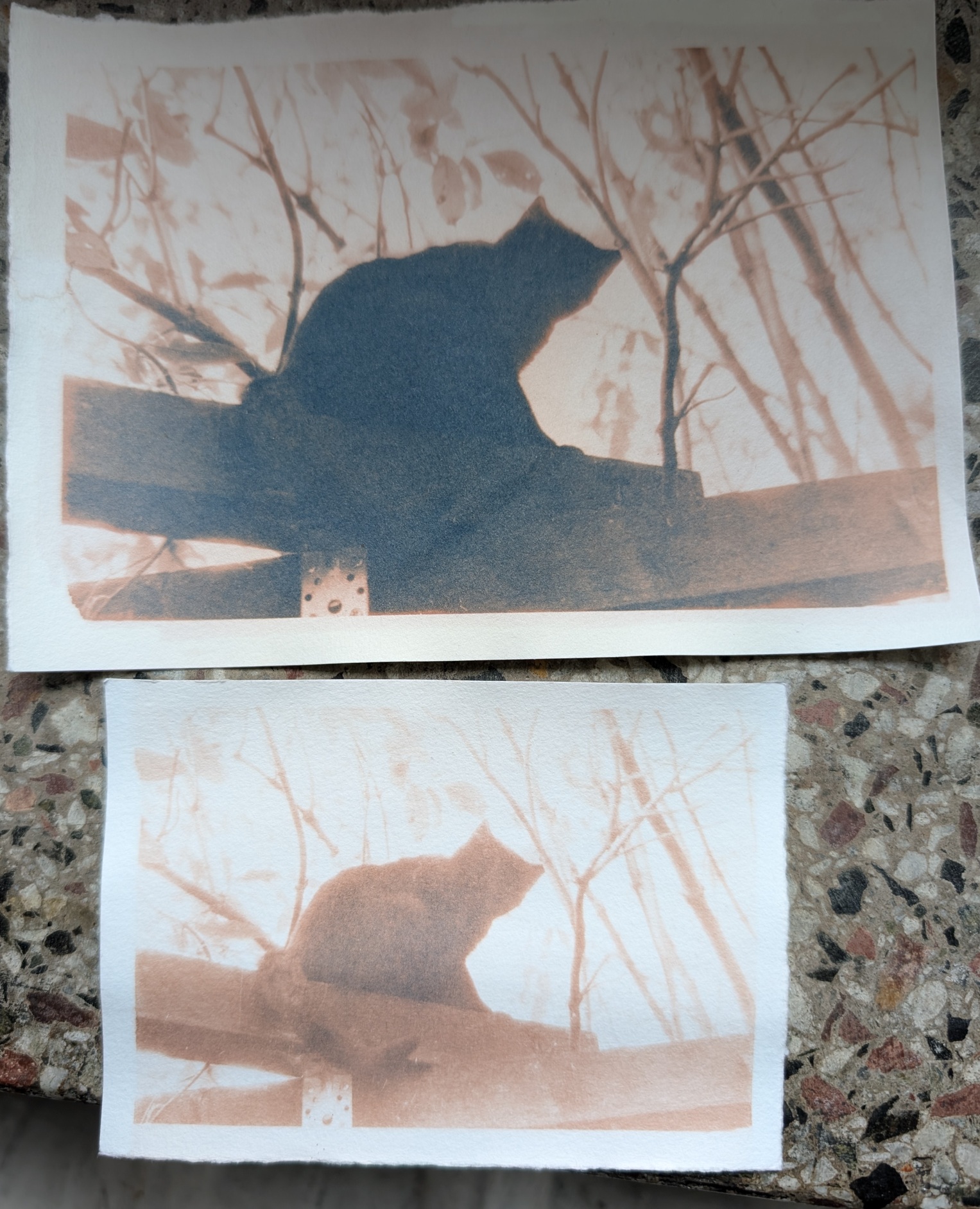

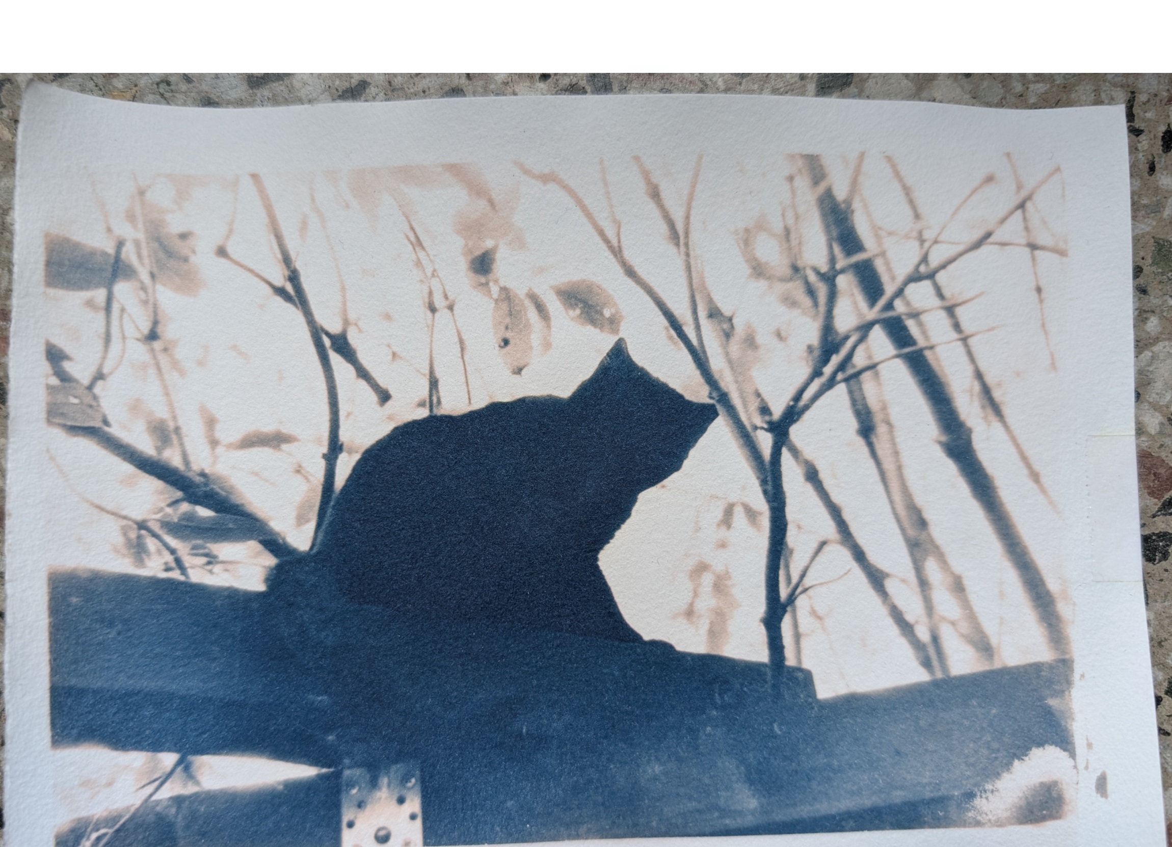

实验结果如下:
这种方法也可能适用于其他过渡金属。

The experimental results are as follows:

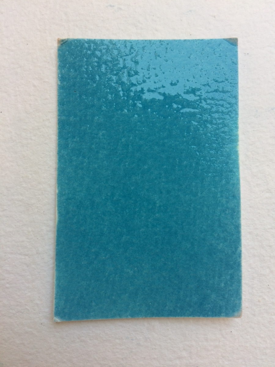

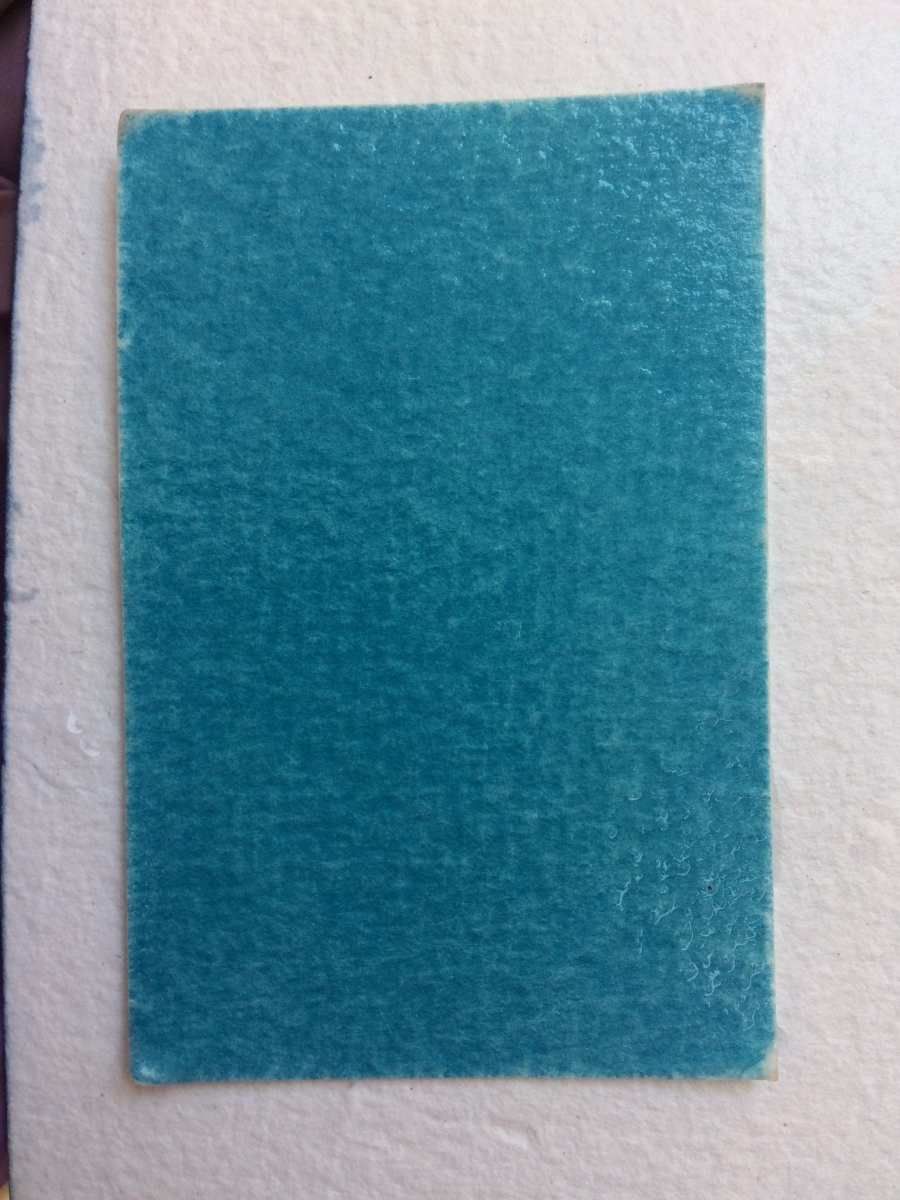

@xiaruan: very interesting idea! I gave this idea a try (well.. three tries actually). But I think I need your help in figuring out if I am missing something. I followed the steps given in your post and couldn't get the reddish brown colour that you got.
Cyanotype:
After reduction with Ascorbic Acid (+Citrate) and subsequent wash to remove residual Ascorbic Acid:
The print was much paler than seen above immediately after bleaching. However, the subsequent wash brought back some of the blue as expected (PW gets oxidised to PB by air in the presence of water).
After treating with Copper Sulphate + Citrate:
I gave a good wash to remove residual Copper Sulphate from the print after the above step. Next I cut the print into two halves - treated one with Hydrogen Peroxide and the other with Potassium Ferricyanide. Here are the results after oxidation, wash and drying:
Peroxide treated one is at the bottom and Ferricyanide treated one is at the top. Notice that neither of them have the yellowish brown tone seen in your tests. Since I got very similar results in three attempts, I am at loss about what I missed in the steps detailed by you.

Thanks for the quick response @xiaruan. As I wrote in my earlier post, the print after bleaching in Ascorbic Acid is quite pale in colour, but it gets back some of the blue immediately after washing in water to remove the residual Ascorbic Acid. This is quite expected because PW is oxidised partially by air and water and happens even when a Cyanotype print is water developed after exposure. As far as Potassium Citrate is concerned, I used Sodium Citrate in about the same amount mentioned in your post. Do you think Potassium Citrate is absolutely critical and Sodium Citrate wouldn't be a functional substitute? In any case, the print after oxidation with peroxide doesn't show any hint of of Copper Ferrocyanide. So I am at loss what could have prevented the toning even partially. I'll give another try if I can think of something or wait till others have tried and learn from their experiences.

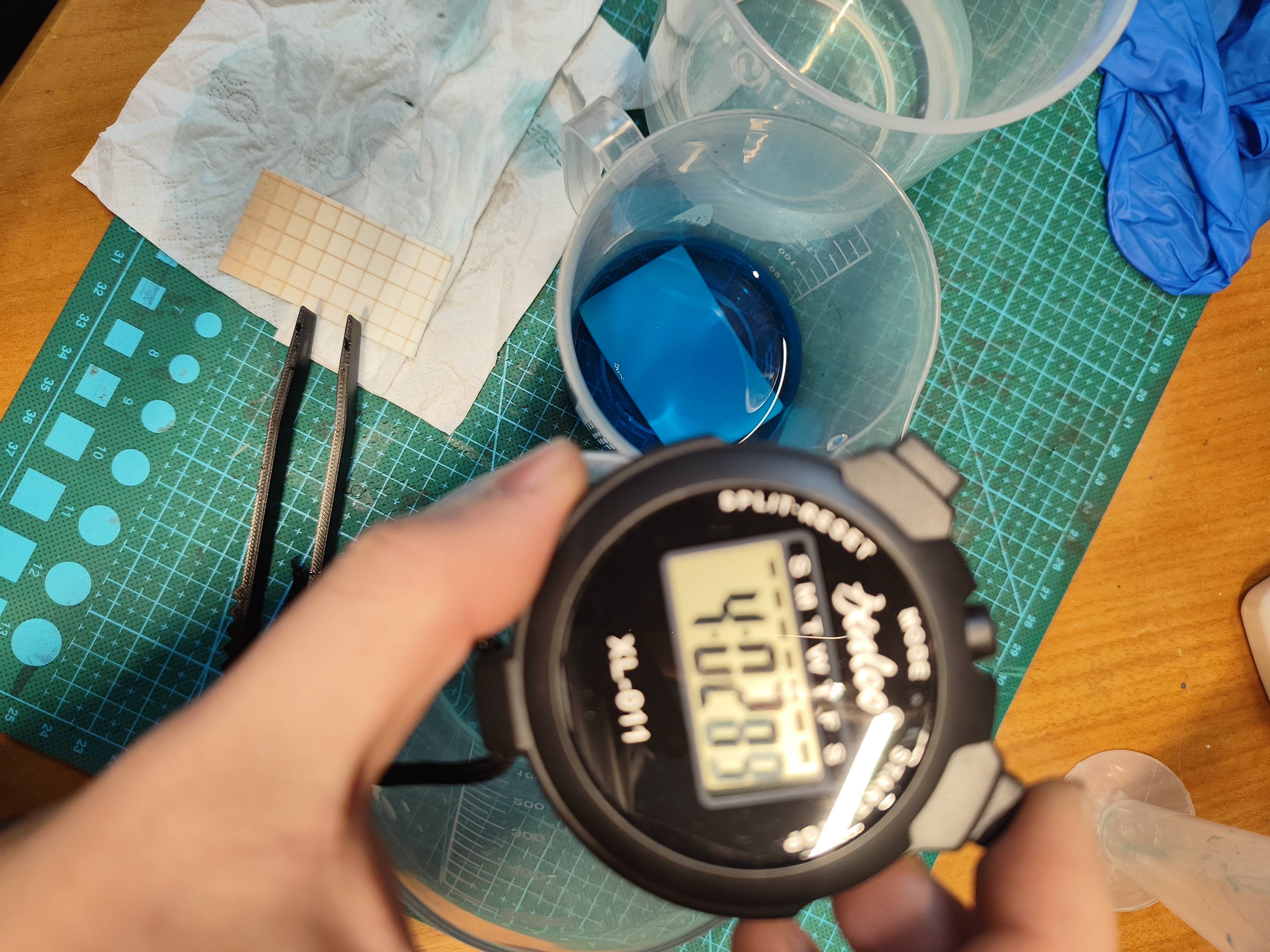

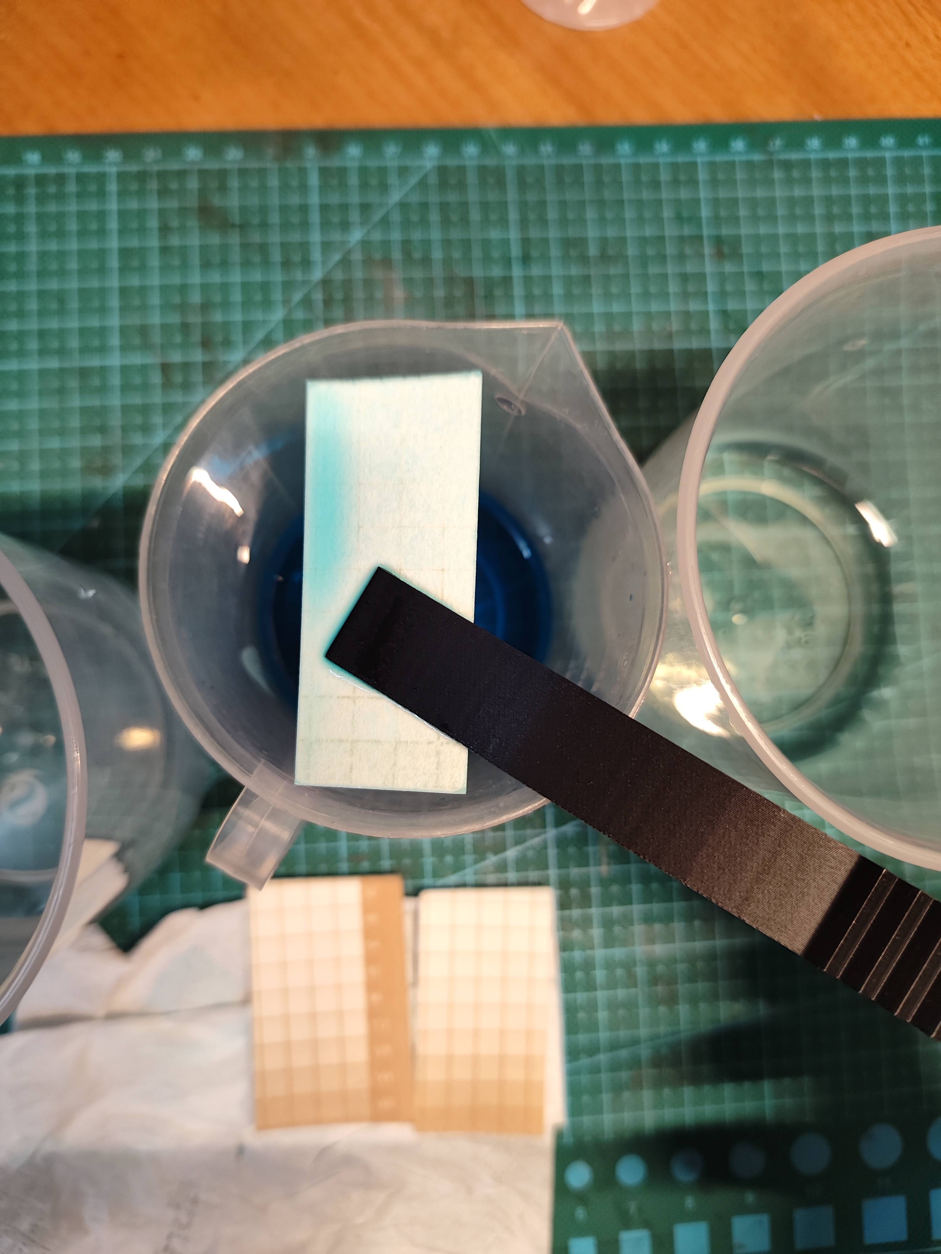

The sodium citrate I ordered finally arrived today. I tried replacing potassium citrate with sodium citrate in the formula, but it turns out potassium citrate is essential.
In the image above, the beaker on top contains sodium citrate and ascorbic acid, while the one below holds potassium citrate and ascorbic acid. It is evident that the sample in the lower beaker appears significantly whiter. Additionally, the bleaching process was observed to proceed at a remarkably rapid rate.
In this image, the left side shows the staining with sodium citrate and copper sulfate, while the right side demonstrates the result after adding a small amount of potassium citrate to the staining solution. It can be observed that sodium citrate and copper sulfate alone fail to convert Prussian white into copper(I) ferrocyanide.
Therefore, I conclude that potassium citrate is indispensable in this formulation.
