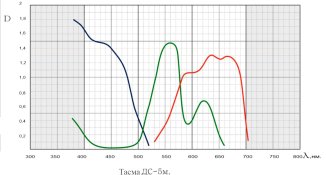

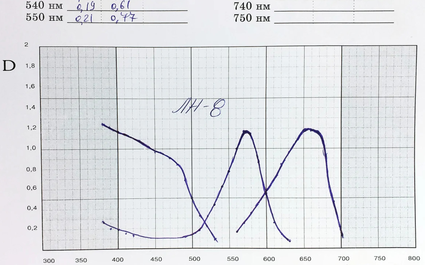

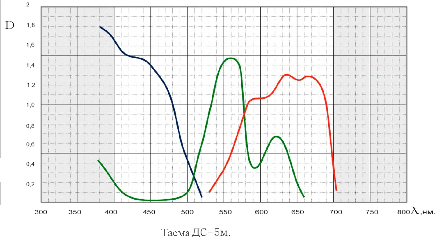

Sooo, how many layers did Agfacolor Neu have? Since it was the first film of this type and since it had a very narrow exposure latitude, perhaps, it had one layer per color too?
I know that couplers are completely different and that Adox will try to recreate Color Mission I palette, but I'd love to see the color palette of the first chromogenic monopack film 'reincarnated' in C41. Maybe even sensibilisation  bugs  features of the green layer could be added too?
Most colour materials (and especially those running on Fischer coupler technology) before slide/ curtain coating came into widespread use (1955-1980) were running at a layer per colour (because they could essentially only be coated at a layer per machine pass with dip coating - and slot die might have been 2-3 at most - more often possibly just one per pass) + filter layer + supercoat etc - so about 5-7 layers total. They also seem to have used much more polydisperse emulsions - which have strengths and weaknesses (read Ron's posts on emulsion system design in the emulsion making subforum) - and the 'very narrow exposure latitude' is really just a characterisation of pretty standard reversal film behaviour - which will have been far more important in an era when exposure meters (as we would understand them) were very new.
It took decades, before the industry started splitting colour layers into sub-layers.
I think it happened pretty steadily across the C-22/ E-4 to C-41/ E-6 era - C-22 Kodacolor seemingly being 9 layer (3x machine passes on slide/ curtain). Certain Kodak machines (pre Room 13) seem to have been able to be threaded up in specific ways for multipass coating for colour or for single pass coating for B&W.
