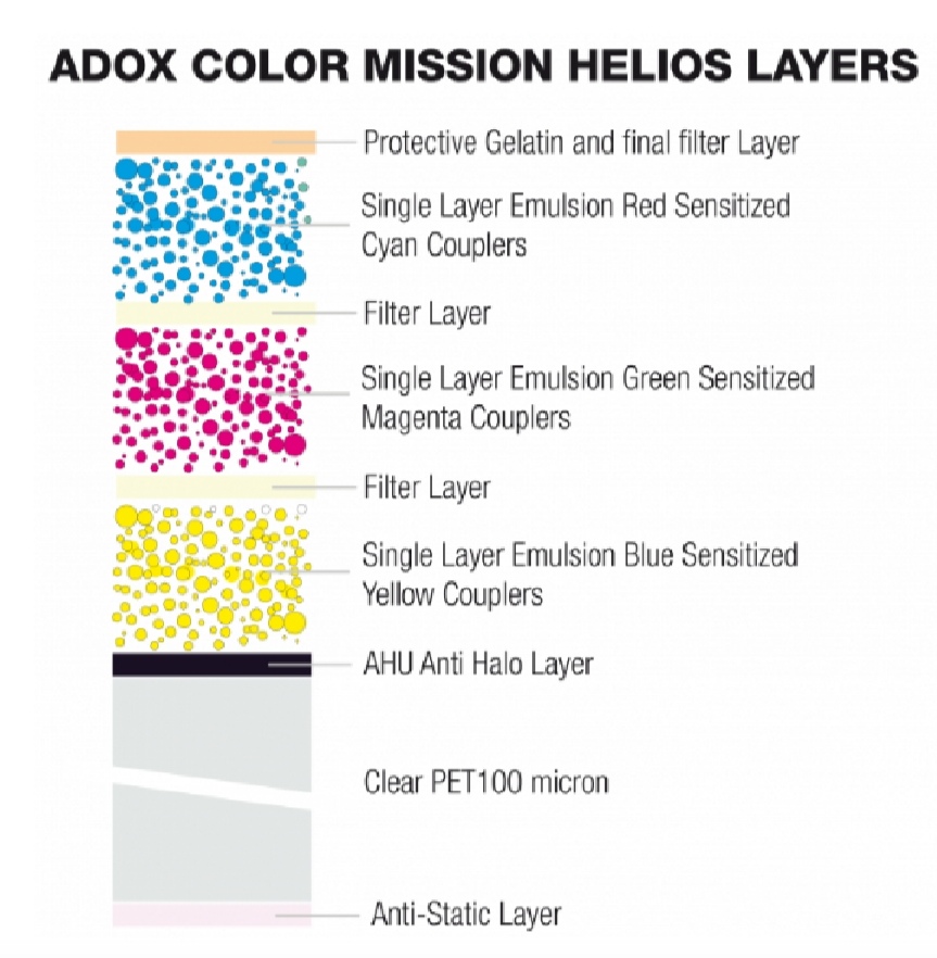

So, do I read this correctly? https://www.adox.de/Photo/elementor-13690/
Does Helios really have this weird layer layout, exact opposite of a typical color film? Why does it have two filter layers? I wonder how it will look "redscaled", since example photos do look red, which would make sense if it was coated in that order by accident

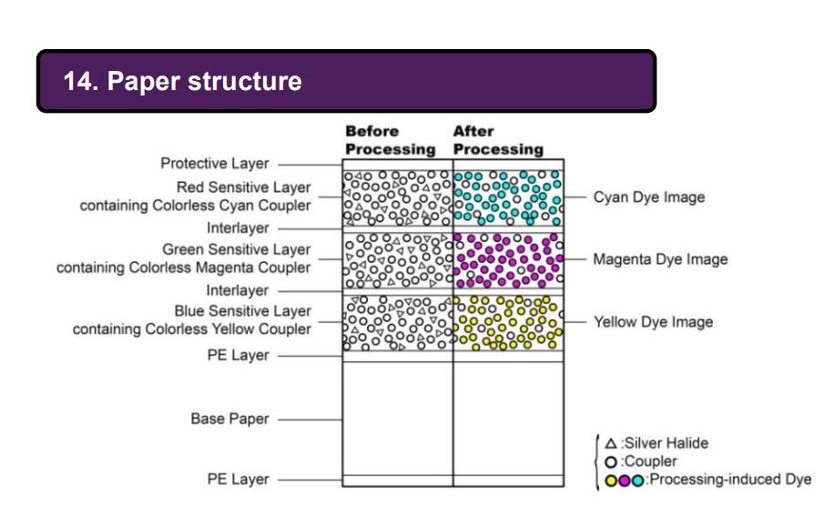

It is the structure of color photographic paper that uses tungsten balanced bulbs, I think it has no filter interlayers. Very strange for daylight color film taking into account that green and red silver layers are said to have some blue sensitivity, putting the blue layer the lastest seems like a bad idea. In a standard color film, blue sensitive layer is the first one and then blue is filtered in a yellow interlayer to prevent exposure of the remaining emulsions.
It's remarkable, for sure.
Like @halfaman remarks, this layer order is reminiscent of color RA4 paper. But this doesn't have (or need) filter layers. Btw, I've written about that here: https://tinker.koraks.nl/photograph...r-film-and-paper-are-fundamentally-different/
At this point, I suppose we can only guess why this layer order has been chosen for a color film product. If I were to go out on a limb, I could imagine it has something to do with making a sufficiently fast cyan/red layer. In a regular color film stack, with red/cyan at the bottom, this layer needs to be comparatively fast. And since red-sensitization AFAIK is already fairly inefficient, maybe (maybe!) the rationale was in it being easier to put this layer on top so it doesn't suffer from the further light loss of filtering through the other layers. Speculation, speculation.
The example images do make more sense to me, now. I can only see this layer order work under two conditions, which to an extent form a tradeoff among themselves:
1: The top filter layer (which typically already has a UV filter) would have to filter out a considerable part of the blue spectrum. This is because of the inherent blue-sensitivity of silver halides. By simply lopping off that part of the spectrum altogether, you could prevent crossover, i.e. formation of cyan and magenta dyes in response to blue light.
2: Or one might simply accept this crossover and take it for what it is.
Given the examples with the decidedly pink skies, it seems that a hefty dose of #2 has been thrown into the mix. We've only seen a few examples, evidently, but I expect that this film will be essentially incapable of imaging a pure blue and it'll struggle with greens as well. So far, the examples are in line with this.
If @ADOX Fotoimpex could shed some light on this (any color you like, Mirko!), I'd be very grateful. Not that it matters all that much in the end, but you know, just curiosity. In particular, I'd be interested to learn what the challenges have led Adox to opt for this layer order, and what this means for future color films.
It is clear that this choice has resulted in a unique product in the market today.
Hm, never noticed it in datasheets
Do you have any articles as to why? In duplicating film, AFAIK, magenta forming layer goes first to improve percieved sharpness, placement of the other two makes sense too, but the RA4 paper layer placement seems odd
Edit:nvm, I've read the koraks's article. Still, this layer order doesn't make any sense for a film
I don't think any film, in 1930s or in modern day had any issues with mottling though
No, that was (and still is) a paper-specific problem.
you still need to make the bottom layer fast, the only difference is in what dye it produces
But I suspect it's a lot easier to make a fast blue/yellow layer than a red/cyan one. It's not just about which dye it produces, it's about spectral sensitivity mostly. And blue photons just have more punch than red ones, which means there's just a lot more energy to be easily captured at that end of the spectrum. There's a reason why silver halides are inherently only UV-sensitive.
I think Adox said somewhere that they have all the sensitisers and couplers figured out, just can't coat enough layers at a time

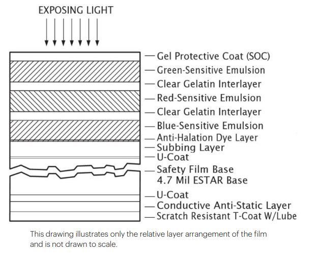

Some old movie print films have a similar structure, though current Kodak 2383 color print film has green sensitivity layer first. They are also designed to work also with tungsten light. No filtering interlayers either.
Interestingly, there books that mention svema duplicating films with "inverse" layer order (meaning magenta on the top) as far back as 70s. And it is benefitial for a technical film. But the "paper" layout for a film seems pointless and even harmful. I really want to see what Adox will say
As @koraks said it before, it probably has to do with the current limitation of the speed they are at. ISO 1.5 is pretty borderline for general photography already. If they need to sell this film to finance further R&D starting with a film that has even three or four stops (guessing here) less sensitivity might prove to be a deal breaker. Better to sell something with "character" that something only a few will be able to use...
What does 'figured out' mean, though?
No idea. I even may be misremembering, Helios was announced a long time ago, after all
And how does the number of layers coated in a single pass relate to the layer order stack?
It doesn't
What I was trying to say is, if I remember correctly, Adox said that this film is the way it is due to limitations of their machine- "1 layer per color", etc.
1.5 with filter, 3 without(According to google translate) and I suppose it was higher before the additional filtering layer was coated
I figured that that's what you were implying, but I don't yet understand how it would make sense. Hence my question; hopefully Mirko will come along at some point and clarify. Not that he's obliged to do so, of course.
Turns out, there's already an answer, back in 2022
HELIOS has less latitude than COLOR MISSION I because of its low speed. Any given fine grain emulsion is lacking polydispersity over a coarser grain emulsion because you do not have the larger grains inside. Exposure latitude is defined by this.
The fact that we have only three layers does not necessarily affect this. The many layers are more for color separation than overall latitude but ofcourse these things can cross when e.g. colors desturate and "fall" into brown. If you had a separate semi transparent booster layer there for a given color, it could add latitude as well.
I still don't understand why they went with monodisperse emulsions, perhaps it's "training" for 1/3 emulsions of the future Color Mission III, but then wouldn't it make more sense to still use the traditional layer order? Btw, this explanation helped me a lot with understanding how color films and multigrade papers work, so I'm very grateful to the person who wrote it
