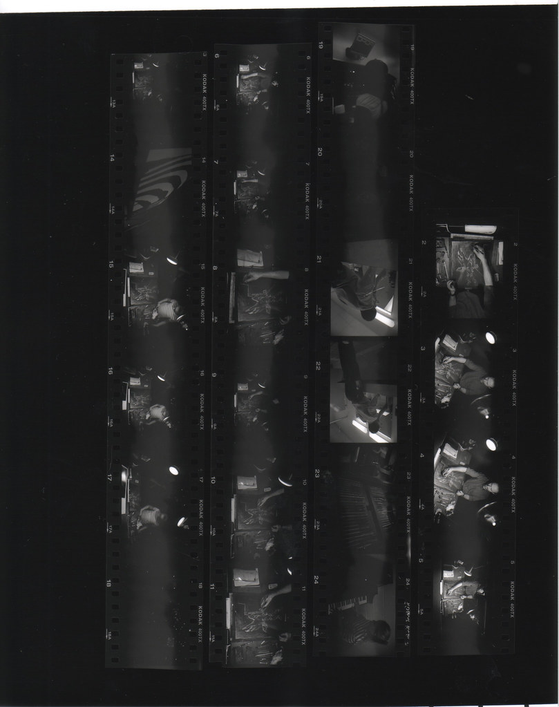

Hey all, back here at the photolab. Here are the facts; work your magic!
- A student came in with a contact sheet like this and none of us can figure out what happened. There's a light strip down the entire length of the film.
-If you look closely, there are ever-so-slight lines going across it from perf to perf...or at least the beginnings of the lines.
-The person she developed with (in a double-tank) had something similar to this, though not as light of a strip (his reel was on the bottom).
:confused: But I figure the lighter strip is so irregular that it can't be an in-camera issue, and it doesn't seem to be a developing issue because it goes all the way down the entire film-strip. :confused:
If you can't see as well or if the picture won't work, go here and see if you can look closer....
I'm all ears...
I would say incomplete fixing combined with inadequate agitation during fixing. You should look at the negs to see if they have a slight milky appearance. Additional fixing should solve the problem.
My guess is improper aggitation for the type of tank causing uneven dev and/or fixing.

Lets be more clear on this please. There is a dark streak down the middle of the film which causes the lighter streak down the middle of the proof sheet strips we see, right?
If so, then the center either got more development or less fixation for whatever reason.

Yes. Absolutely yes. Watch it sometime. It's safe to open the tank after a minute or so in the fixer. If you keep agitation down to a minimum, you will see that the edges fix faster than the center. No, the film didn't stick to itself. That would look a lot worse.
You said this was a student? In that case, they most likely did what all my students do (despite my warnings) and fill the tank, then set it down and walk away instead of agitating.

I'm sure that I don't have as much experience as you, but wouldn't that cause an all-over problem. Maybe not since as was pointed out the center takes longer to fix. Also, it would be an easy catch if the student simply didn't agitate.
I'm guessing the lower reel got more exposure to fresh chemicals. I'm not entirely sure why that would be, though.
