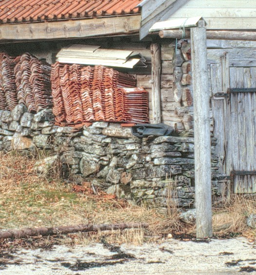

Just off the top of my head, and based on one exposure on colour film with half a 150mm Symmar...
There's a little chromatic aberration, but not enough to be the main problem. Mostly it's field curvature and/or astigmatism!
This is the picture - with two small sections scanned at 600dpi:

Hey Ole - wasn't that the same image you'd posted on the LF forum?? I wasn't aware that it was from a half-lens. Wow. That's an encouraging result! I think I'll re-explore it.

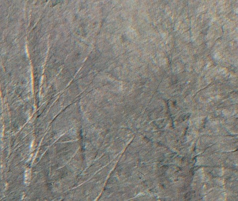

Actually - I just tried something with your tree detail, Ole - this is kind of fascinating. I opened it in photoshop - just to look at the different channels to see if there would be a big improvement with the use of a filter. Seems to be. What's even MORE interesting about this... is that if you click on each of the R G and B channels consecutively, you can really SEE the movement between them... you can see how the lens is projecting each of those spectra at a totally different place on the film!
I was going to try to make an animate gif to illustrate this in photoshop.. but alas.. I don't know how!

Sparky,
I hadn't thought of that! You're absolutely right - there's a definite shift from B-G-R. Red seens sharper too, but that's usually the case. There's still quite a bit of astigmatism to bee seen, but a red filter would certainly make a difference. Unless you shoot colour film, of course...
