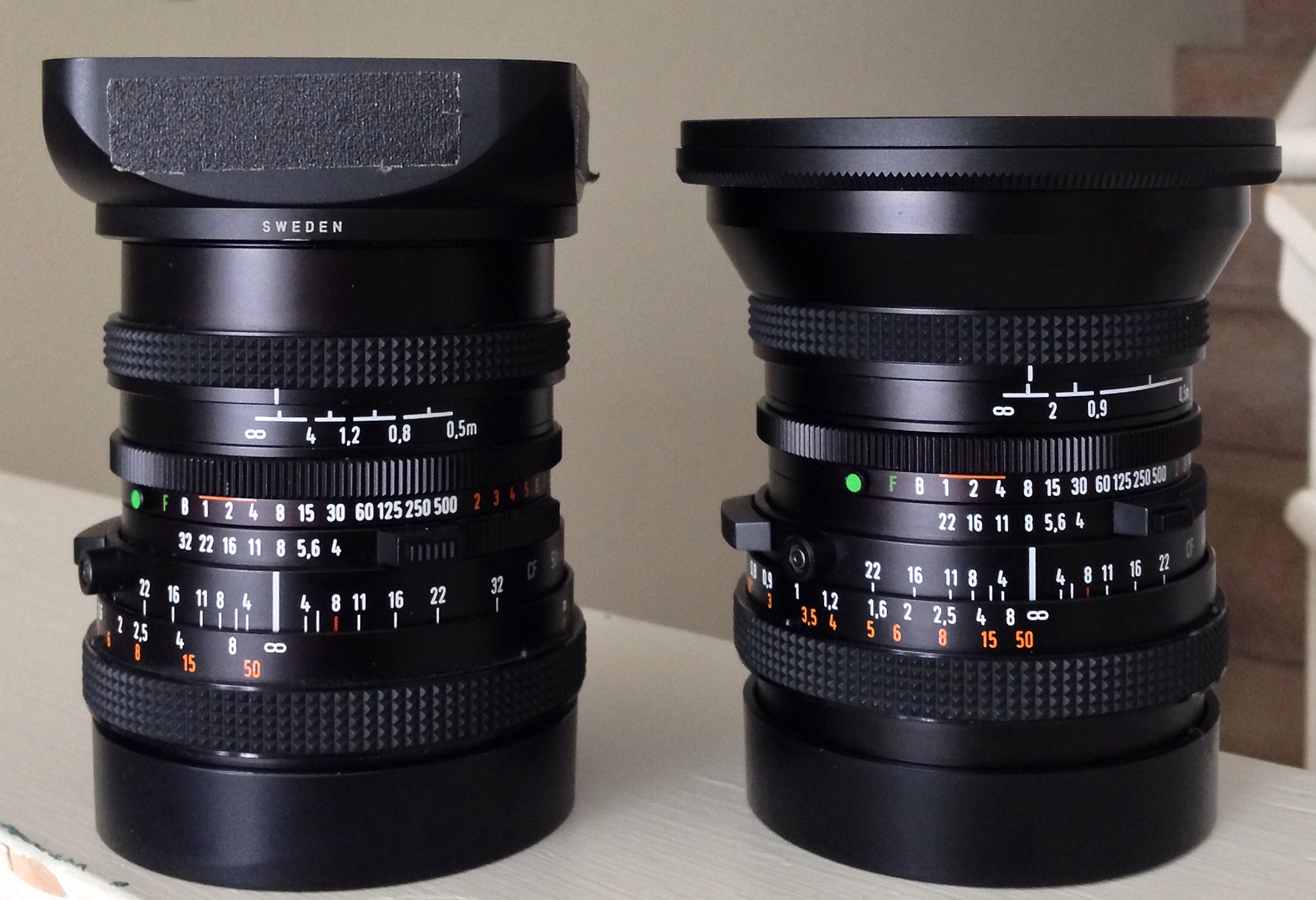

Also, there is some commentary going on about the size of the 40, I used to perceive it as being huge too and the C version certainly is. But I find that in person, the difference between the 40mm FLE and the 50mm FLE is not all *that* great, this goes for weight too. So in these two photos, you can see the difference with both the shades on and off...it's just not a "Deal Breaker" size difference. 50 is on the left, 40 on the right.
Also, check out the difference in field of view...
