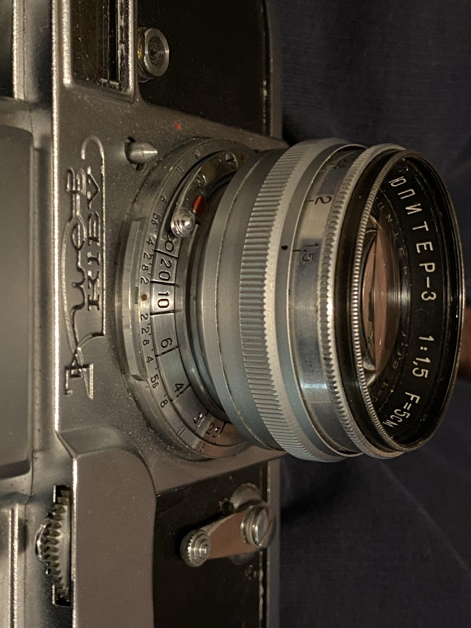

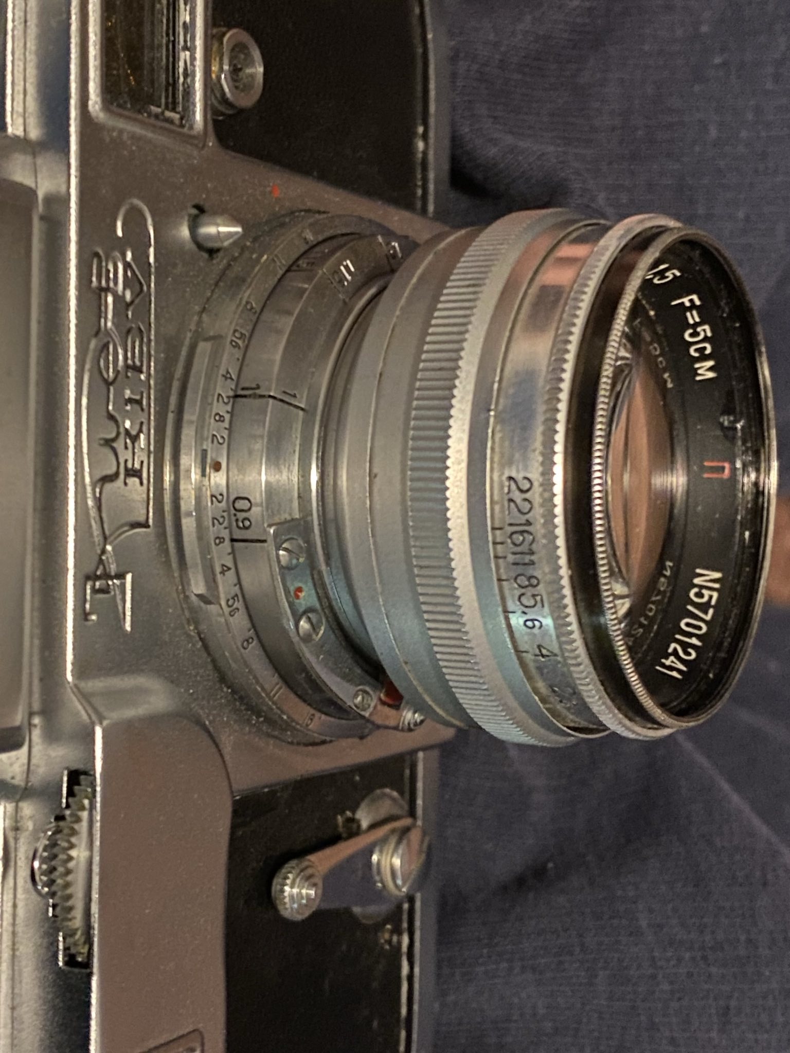

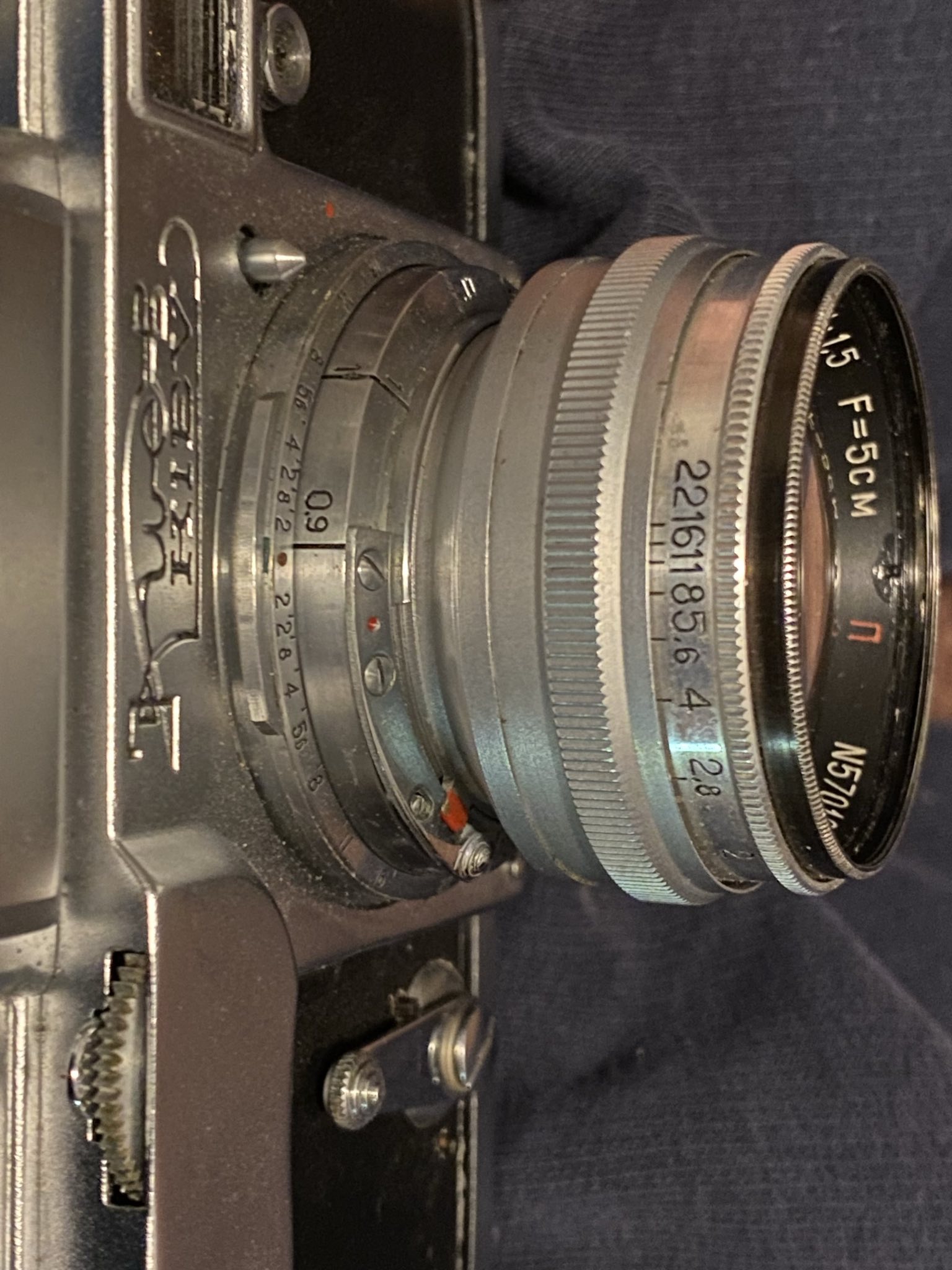

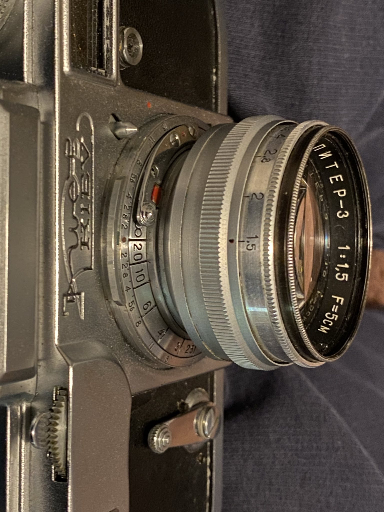

I want to get more use out of my Jupiter-3 50mm f/1.5 lens. I know the ideal is to get it shimmed by a professional, let's leave that aside for a moment.
What I learned about it so far:
1) The lens at f/1.5 front-focuses by approximately 5 cm at the minimum focus distance of 0.9 m with the Kiev 4 rangefinder.
2) The lens at approximately f/4-f/5.6 is focusing accurately (focus shift).
3) I mostly only want to use this lens wide open, for its character. I have a Jupiter-8 when I need a more technically perfect shot, which has no focusing issues.
4) Each f-stop down shifts the focus at the MFD away by approximately 1.5 cm.
The markings for a 5 cm focus shift align with the DoF scale mark at f/4.
I'm thinking I'll focus in the rangefinder, look down at the lens and focus out until the f/4 mark. Then things should be accurate for a wide open shot. Kind of like how you'd adjust for the infrared mark.
That would imply, by these pictures, that when the camera is focused on infinity wide open, it's actually at 15 meters.
Does all this seem to be sound logic?

And how did you determine the 5 cm focus "shift" at minimum distance ?

Test shot wide open at minimum focus distance. The lens focused on something approximately 5 cm closer. My other lenses with this rangefinder focus well.

To summarize: a fixed mark is not really valid (hence the oddity of your last two pictures), and the effect of focus shift becomes less worrying as the distance increases. I suppose that at around 5 m it would be hardly noticeable — though of course, it’s always possible to do a test to find the distance at which the effect can be safely ignored.
Have you actually TESTED?
  • Set lens to MFD and (with wide open aperture) shoot a target (ruler) extending out from focal plane of camera and view 8x final print to determine what distance mark along ruler is truly IN FOCUS
  • Set lens to 10' distance and (with wide open aperture) shoot a scene with objects placed precisely at intervals (in front of, and behind object at 10') and view 8x final print to determine which object is truly IN FOCUS
