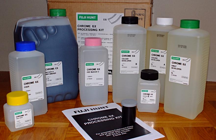

So, I purchased a couple of Fuji E6 5-liter kits ("Chrome 6x") - see attached pic.
I'll be mixing my first batch soon, but I'm still in doubt regarding a few things, namely:
Longevity:
The papers state the longevity of the mixed solution in various storage situations (half-full, tightly capped, etc...), but I still don't know how long the kit can last in its original factory package (unopened concentrates). I think I read somewhere that unopened it would last some 18 months... Possible?
Mixing smaller quantities:
I don't need full 5 liters of mixed chems... It would go bad too soon - besides, handling multiple (smaller) containers will be a problem. So, I'll probably be using a couple 300ml batches, until I get familiar with the process, and then perhaps 1 liter batches for 2 or 3 larger runs (batches of 10-16 4x5 chromes in Jobo 2840 drum, plus some medium format films).
I think the best way would be to mix smaller batches as needed, and transfer the remaining concentrates into smaller containers, to prolong the life of concentrate... and add some marbles to displace air from the smaller bottles with the concentrates.
Reusing solution:
Is it OK to reuse the diluted chems (solutions) immediately for a second run? I.e. preparing 1 liter solutions for all 6 chems, using it for one run (let's say 14 sheets of Velvia 4x5), and then a couple of hours later (or next day, when the drums and the reels have thoroughly dried) reusing those same diluted chems (solutions) for another run of another 14 sheets of 4x5 Velvia? I think I don't need to extend the times, since the data sheet states something like 118 4x5 sheets witout the need for extending the developing times.
I'll be using Jobo CPA2 and smaller and larger Jobo drums...
Thanks for any info...

Photo Engineer
Apr 19, 2005
29,018
Rochester, NY
The original kit has 3 perishable parts.
1. First developer
2. Color Developer
3. Reversal bath.
They are packed under nitrogen, so once you open them to the air, their 1 - 3 year shelf life goes away. That unopened shelf life depends on date of manufacture and how it was kept getting to you (hot, cold etc).
A one part developer is not as stable as a 2 part developer. Therefore the First Developer is less stable than the Color Developer which is usually 3 parts. The First Developer should be light brown to clear.
The Color Developer, if in 3 parts, only goes bad if the small bottle (usually B) turns brown or black. If amber to clear it is fine.
The reversal bath gives no indication that it is bad, other than giving bad results.
All liquid kits can be mixed up in small quantities. Powder kits cannot. After opening, liquid kits usually last as concentrates for about 6 months or less. The mixed working solutions will last about 6 weeks in full bottles.

OK, I developed two rounds yesterday, reusing the chemistry for the second round. I used the Fuji 6x kit.
In the first round I developed two 4x5 sheets of Velvia 100 (outdated in Dec. 2008), in Jobo 2523 drum on a Jobo CPA2, "by the book", i.e. (approx. 300 ml for all chemicals, this Jobo drum calls for 270 ml):
1) Warm-up (drum with no liquid inside, rolling on the processor) = 5:00
2) First developer = 6:45 (I added 15 seconds for Fuji film, as I read somewhere)
3) Rinse = 3:00 (4 exchanges of water)
4) Reversal bath = 2:00
5) Color developer = 4:00
6) Pre-bleach = 2:00
7) Bleach = 6:00
8) Fixer = 4:00
9) Wash = 6:00 (approx. 8-9 exchanges of water on the processor, 300 ml each)
10) Final rinse = 1:00
Step #10 was done off the processor, film removed from the tank and dipped into final rinse in a separate dish...
The results are OK, from what I can say (never did any cromes before, let alone large format). The shots were rather difficult, backlit yard full of leaves, with the Sun in the frame, coming through the tree branches. Not an easy shot to meter under any circumstances... and perhaps not a good shot for the first E6 test run :smile:
Anyway, I wanted to see whether I can reuse the same chemistry, so immediately after these two 4x5 films were done, I dried the tank and did it all again with one roll of medium format Ektachrome 100 - expired in 2001 :smile:
Unfortunately, I forgot about that when exposing this roll - I perhaps should have exposed it at EI80 or even 50, but I used 100 ASA - nominal value... I forgot about it being long expired...
Anyway, I extended the times for the second run by half a minute (everything except rinses). The roll came out a bit too dense, I think. Again, I'm no expert for chromes, but when I showed the results today to a friend who used to run a lab, he said they look quite OK. Maybe a little dense, but still OK.
So, I guess the times are OK - when doing the second run with the same chemicals, it's OK to add 30 seconds. You just need to take into account the quantity of film you're doing.
As for longevity, I prepared 500ml of solutions - and topped the original concentrate bottles with lighter gas... We don't have Protectan spray here, and I've read that lighter gas will do in a pinch :smile:
