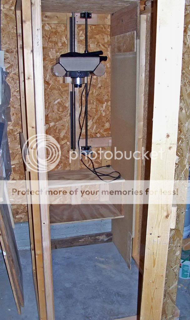

Finally it's warmed up enough to continue my project.I've gotten a prototype opaque enlarger built and most of the construction on a collapsible dry darkroom(just need to light tight it a little).Am going to hold off painting it black inside till I've tested the enlarger a bit.
Another step will be to retrieve my darkroom stuff from a storage shed and that will be more enjoyable as the temperature has gotten above the teens finally.
Am attaching a few pics of the project so far....
This is my first time trying to post pics so hope it works OK...OOPS! the descriptions fell by the wayside I guess.
The first pic is the front,next back,and then bottom views of the enlarger.The first pic of the darkroom is showing it collapsed and the next expanded.
The darkroom is approx 36"wide by 47" deep when expanded,36"by 28"deep when collapsed. My shop is one half a two car garage and it's pretty well packed with the benches and power tools so the small dry darkroom is necessary for my using the opaque enlarger for some paper negative fun.
Don

Finally some progress....
Finished the dark room and shot a paper neg portrait .Turns out it's not a dry dark room in that I can develop the paper negs and also prints up to 11" X 14"(larger prints will have to be processed in tubes outside the darkroom)."Even a blind pig finds an acorn once in a while" LOL!
Here's some pics:

I read your posts for the first time today and I'm impressed. Congratulations! This must be a fun project. I wondered how to make larger prints with paper negatives, without making larger paper negatives. Now I know. I want to learn lith printing this summer, but building an enlarger like this might be something for next winter. It will expand my options for using paper negatives in a homemade pinhole camera.
I've got one question. I'm guessing you put the paper negative on top of the enlarger head. How do you keep the image flat? Or isn't that an issue?
Thanks,
Bert from Holland
http://thetoadmen.blogspot.nl
Bert,
I have a 6"X 10" piece of tempered Masonite with half of a 4"X 5" negative carrier taped to one side so it will hinge open allowing the paper negative to be placed under it.
When on the enlarger the negative carrier is down(of course) the weight of the Masonite holds it flat.It may be interesting to note that the back side of the Masonite is painted medium gray and is used to pre-flash m camera negatives. Thanks for the question,let me know if I can be of further help.
