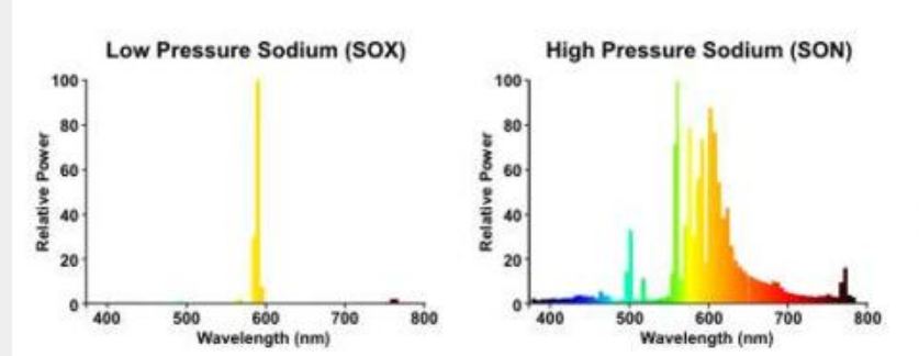

Lights from SOX Sodium lamps are interesting because the eye may see better with "less light", but LEDs also substitute a low pressure Sodium lamps (SOW) with advantage

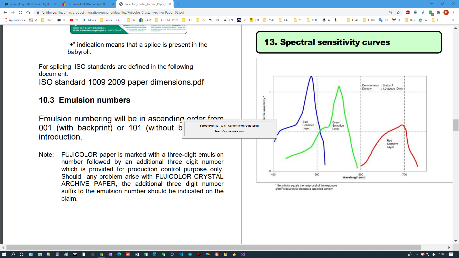

RA-4 paper (Fuji Crystal Ar.) has a deep valley in the spectral sensitivity around 600nm:
but we need a very narrow band which SOX sodium porovides but also LEDs do the same at very low price.
High Pressure Sodium SON lamps are not suitable, only Low Pressure SOX ones are good, but LEDs are an smarter solution

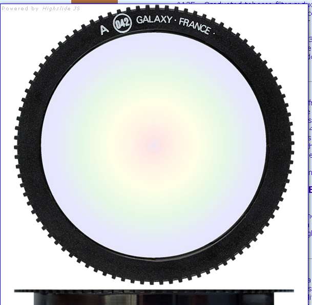

To visually inspect the spectrum of the light we may use a Coking A042 filter or the like
or we may use the reflexion on an audio CD
We'll know the truth from a paper fogging test, but the "rainbow" from the light source will give us a clue about how narrow is the emision bandwidth.

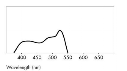

Yes... ilford new RC V is stated to have this spectral sensitivity:
Anyway always a fogging test has to be made to see the light power that has an impact, of course...
