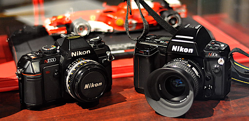

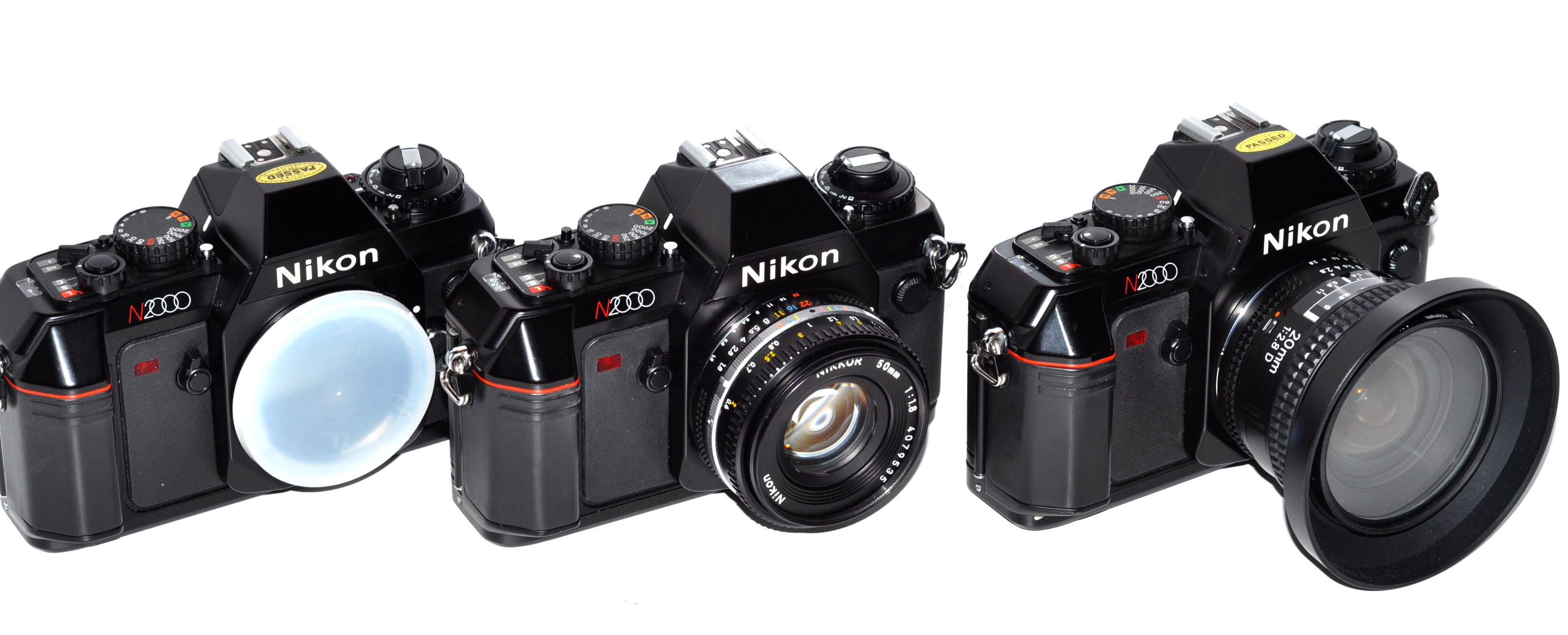

I thought the N2000 would be interesting as it is one of the last manual focus Nikon cameras made. Also, it came with the export version of the 50/1.8 AI-s, kind-of-pancake lens and I thought that would be a nice lens to have.
The N90s...well, just because I did not have one and was curious about it.
The N90s is kind of like a brick. Sounds and feels like it will last forever. In your hands if feels like a 'real' camera. It seems more related to the F100 than the N80.
What advantage over the F100? Mostly cost, seems N90s can be had for much less than the F100.
As I understand it the N90 will only work with G lens in a crippled mode, although D lens work fine. The F100 has more advanced metering and AF. I'm still looking for N90S, have not found one in my price range.
I wound up with more cameras than I needed. The one in the picture came with the lens and cost $25, but was very late in the mail. They said it was lost. So, out of spite, I bid $20 each on two more N2000 auctions the ended at just the same time. Turns out I won both; $9 and the other for $15.
Then, the first one with the lens actually showed up! So, I wound up with three of them.
Yes, so I tried both AI-s lens and G lens on the N90s:
AI-s: works as expected in Aperture Auto and Manual (with spot or center meter) and focus confirmation. I was a little confused at first because, the "F--" symbol stays on, even though it is actually working. Those with later cameras know the "F--" symbol usually indicates it won't work.
I put a "G" AF-S lens on the N90s and it runs the focus motor in the lens fine. Shutter Auto and Program work as expected. It does not give any "Err" in Manual or Aperture Auto but, of course, only exposes at smallest aperture.
And in Program, you can alter the aperture with the wheel; the "Flexible Program" which is useful.
I was looking at that Dandilion chip for the AI-s lens. The AI-s lens will work on the N2000, f100, N90s and F6 without the chip, but it might be nice to have the aperture readout and Shutter Auto modes, which the Dandilion chip claims to offer.

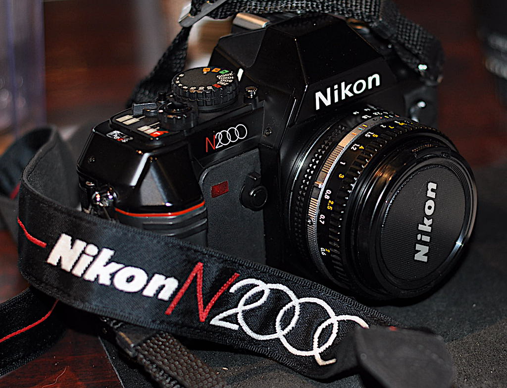

As mentioned, due to a "lost item" snafu with the first N2000, I bid on two more that ended at the same time and won both. Then, somewhat unexpectedly, the first one arrived.

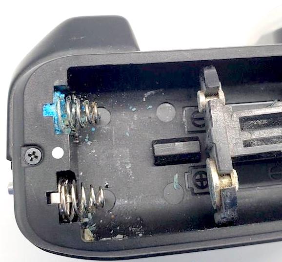

The most inexpensive one ($11) had a battery leak that needed to be repaired. Otherwise they all are in perfect working condition. I tested them with my shutter tester and light meter tester and collimator.

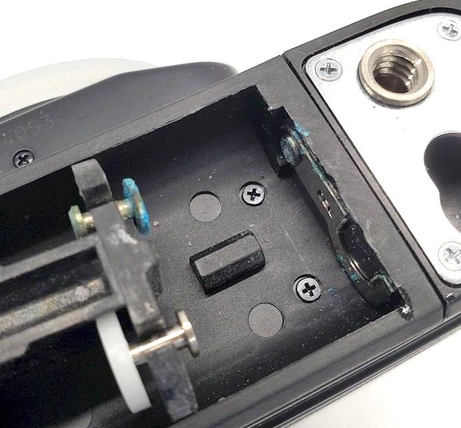

I felt like Andreas Thaler here; cleaning leaking battery damage in a Nikon :smile:
I unsoldered the metal parts, soaked in rust remover and then polished with a soft metal brush.
Afterward all works well!
Yes, those batteries are only in there for testing; I have eight AAA eneloop batteries on the way.

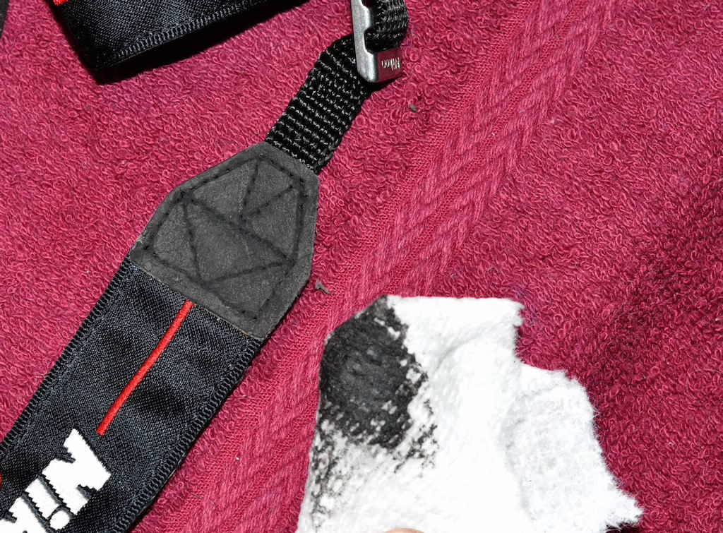

The leather dye was deteriorating on the strap.

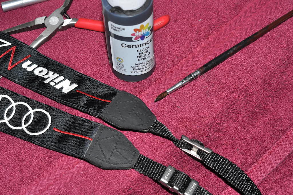

Laquer thinner or acetone can be used to remove the old leather dye.
The leather was re-dyed with latex paint.
