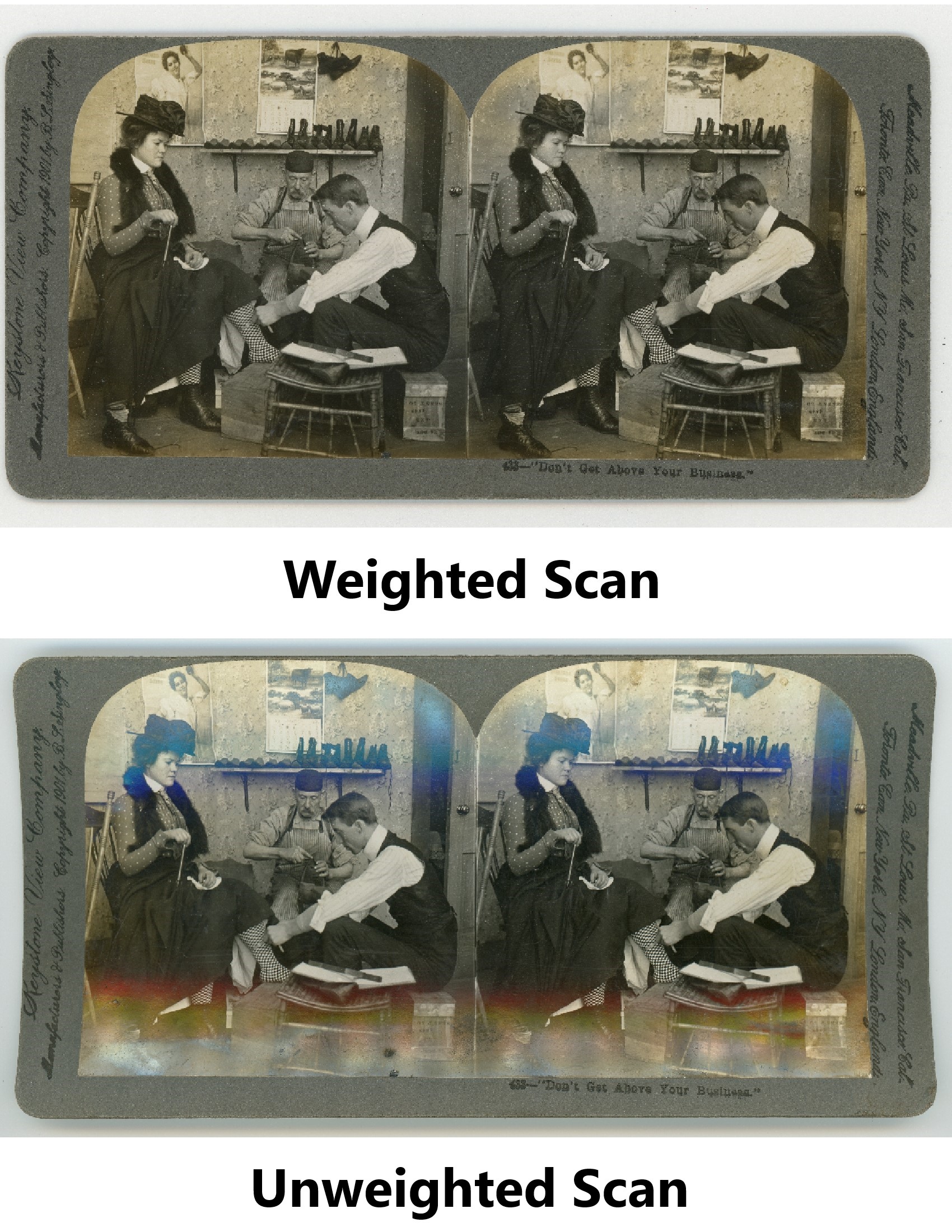

When it comes to weighted scans, I found that an Epson V600 scanner starts to break with 22 pounds of weight put on the lid. The part that breaks is the film scanning component in the lid. I limit the weight I put on the lid to 18 pounds. You figure out the weight limits for your scanner. Don't go by what I tell you, weight your scanner lid at your own risk. And if you do weight the lid, you will need a thick hard foam backer under the lid to contact the original. The lid alone will not do a good job on heavily warped material.

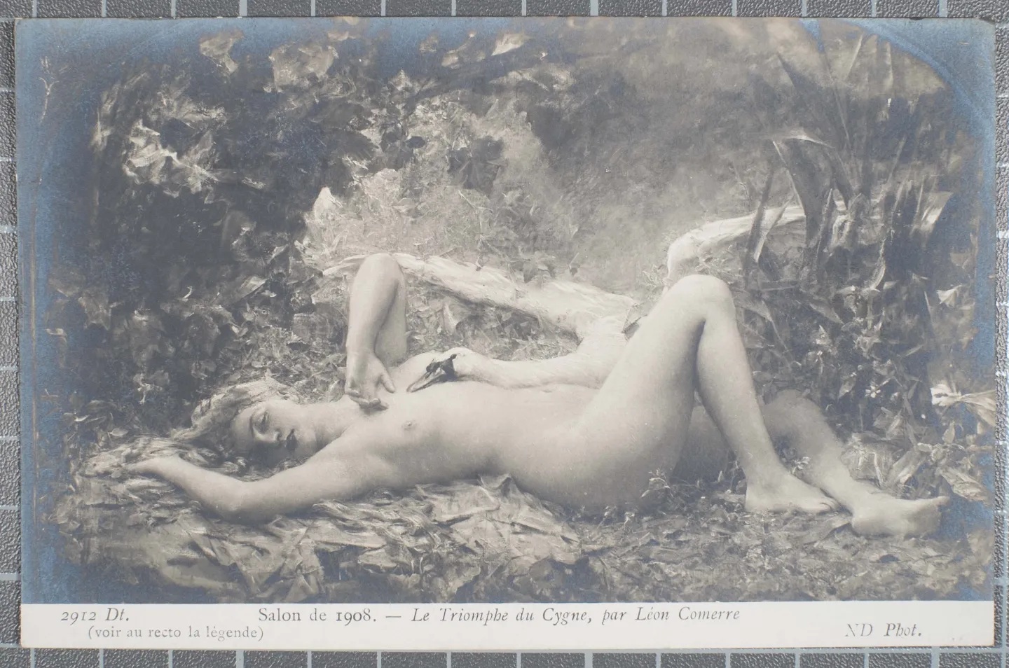

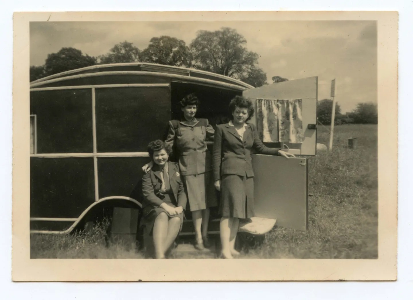

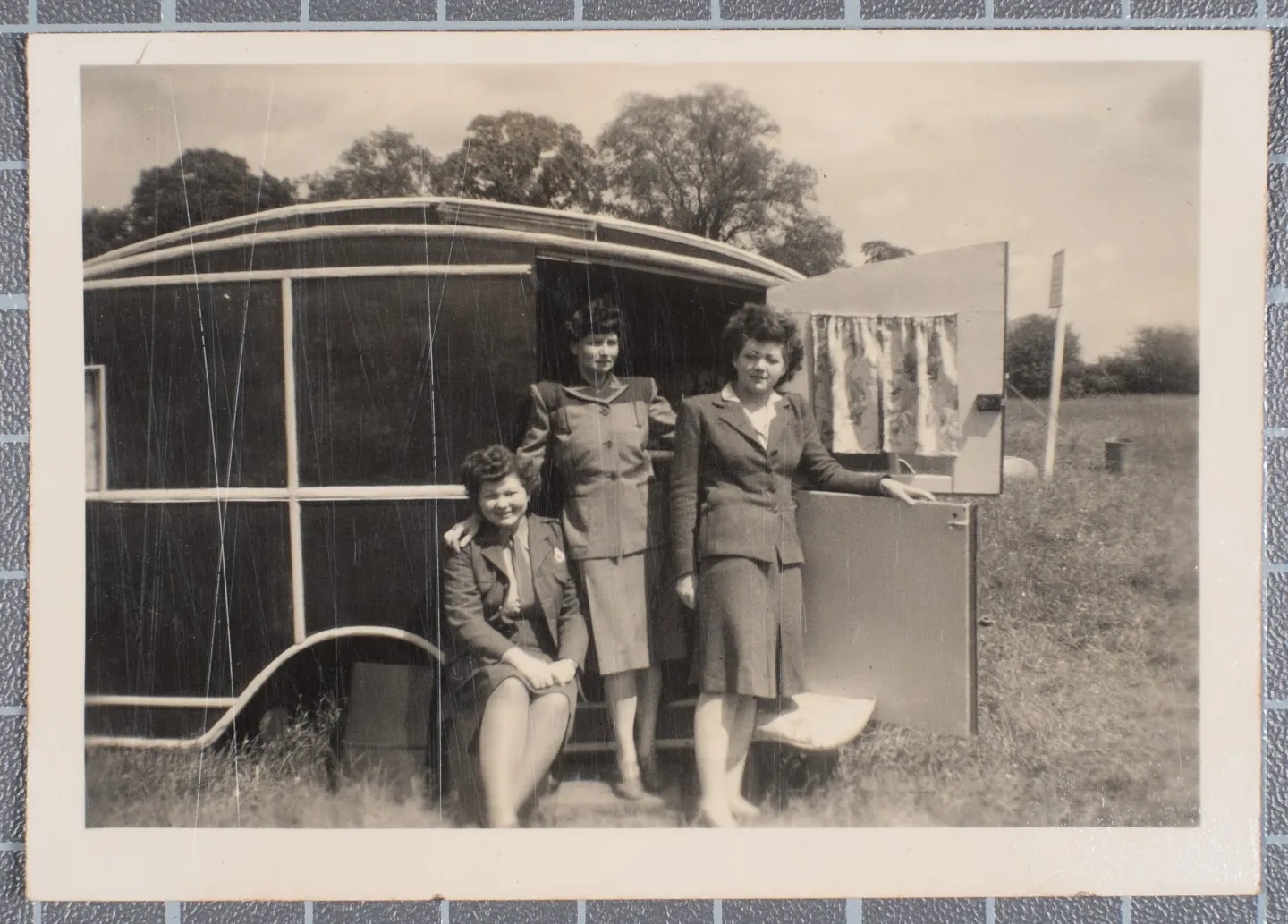

No post processing was done on the copy stand vs flatbed scan photos.
Copy%20stand%20photo%20D.D.Teoli%20Jr.%2
Copy stand photo.
Flatbed%20scan%20D.D.Teoli%20Jr.%20A.C.%
Flatbed scan of the same photo.
Copy stand photo.

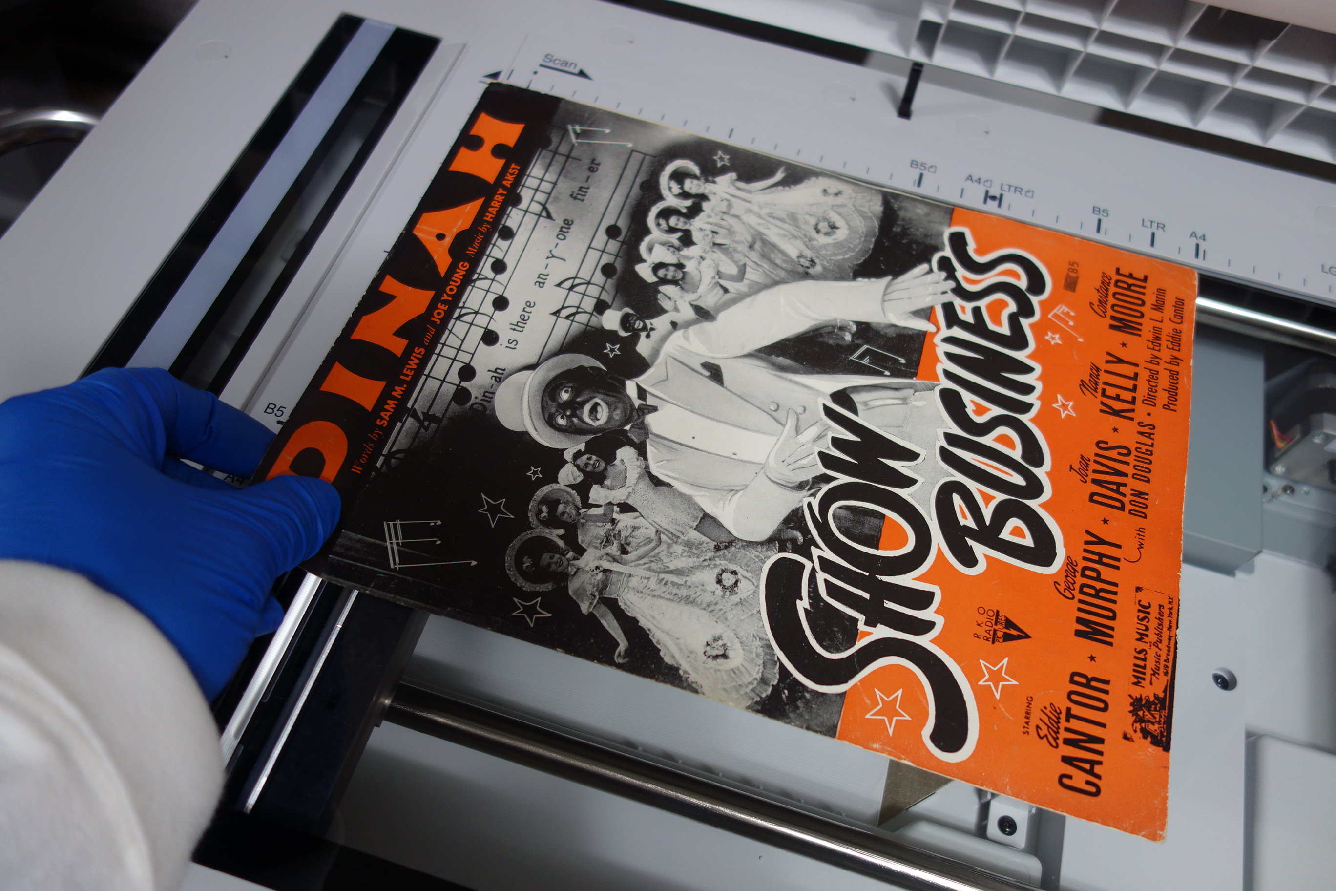

Flatbed%20scanner%20D.D.Teoli%20Jr.%20A.
An example of a flatbed scanner.

Weighted%20scan%20example%20D.D.Teoli%20
Examples of flatbed scanned photos weighted and unweighted.
