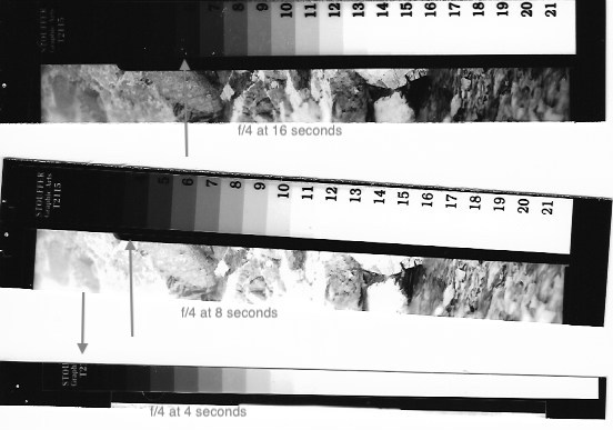

First I set the the lens at f/4, timer at 16s, focused the lens, gave the exposure on a scrap paper with Stouffer 21 step Wedge tablet, then I have lowered it to f/4 at 8s and finally to f/4 at 4s, because each time, I thought I could give shorted exposure. Results are below. Arrows are the steps I cannot see the difference with the following black part.

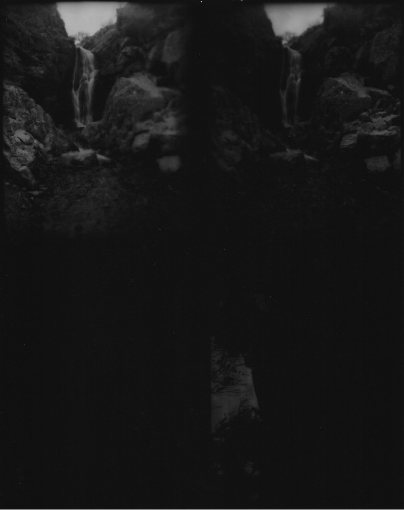

Then I thought, ok because f/4 at 4 seconds should be equal amount of light exposure to the papers with f/8 at 16 seconds (2 stop closing aperture, 2 stops giving more light), I should print my contact sheet at f/8 at 16 seconds. Result below. As you can see it is very dark, not something I have expected based on the above test. Because even at f/4 @16 seconds the image on the top right have some whites.

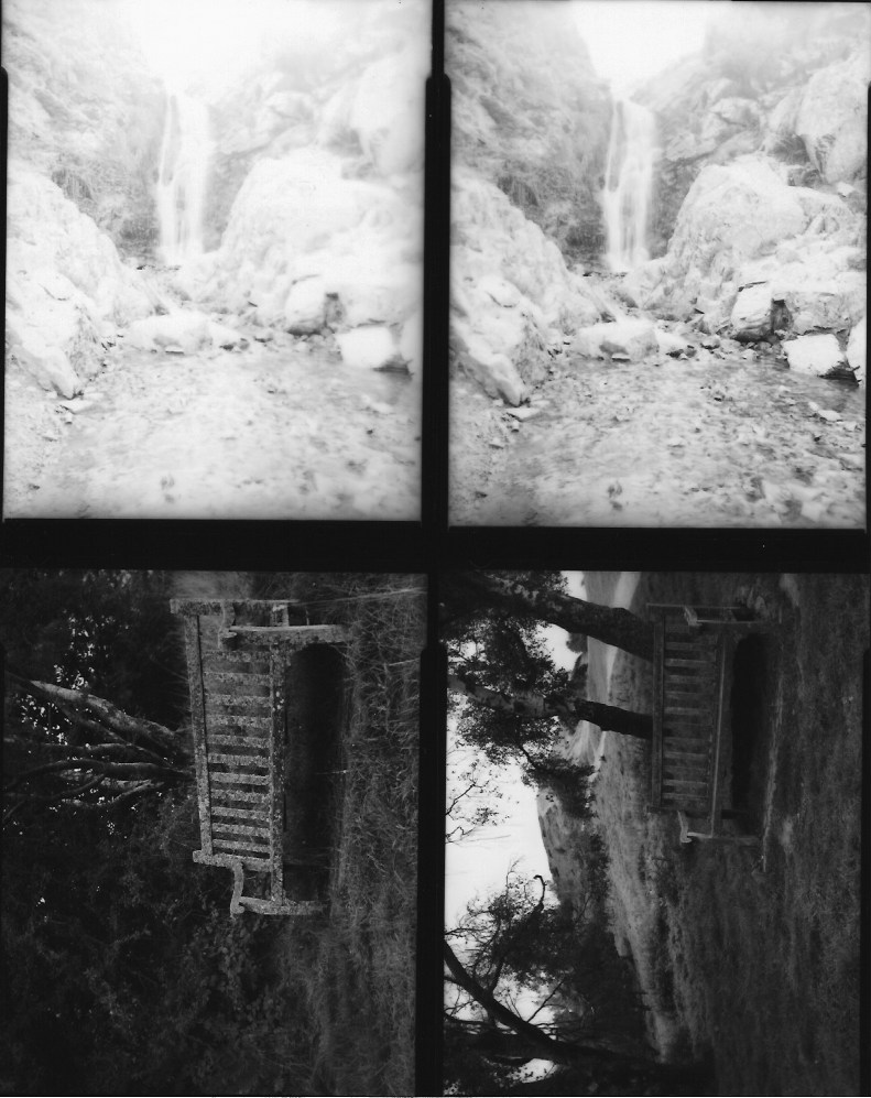

At this point I thought something is wrong so I have printed at f/4 and 4 seconds. Result below. Now that seems more correct. The images on the top are overexposed but the images on the below should be correct prints at Grade 2 (paper is Fomavariant 312, filter setting is 5M)

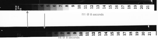

Now I have confused and thought, ok f/8 @16s gives a very dark image, how about f/8 @8 seconds. Then I thought still it is too dark, so I have closed the aperture 1 more stop to f/11 and printed with 8 seconds. Now the result is more or less the same to f/4 at 4 seconds.

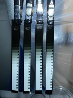

Ok, some news. I have swapped the bulbs with completely new ones, opened a fresh box of Ilford MGRCV, cut 0.5x5” strips and exposed 4 strips as f/4 at 4s, f/5.6 at 8s, f/8 at 16s and f/11 at 32s. I have developed all of them with a single Nova holder to make sure development is consistent as well. Results below;
I’m not going to tell you which one is which but clearly they are equal to me. All have some density at 13, and I can’t see below 6 at any of them. They all read 2.3 at density meter at their darkest edges.
We can see how dense the strip is for f/4 at 4s. Nearly over 2 stop of exposure!
I’m so glad it was the bulb issue but not some very expensive part.
