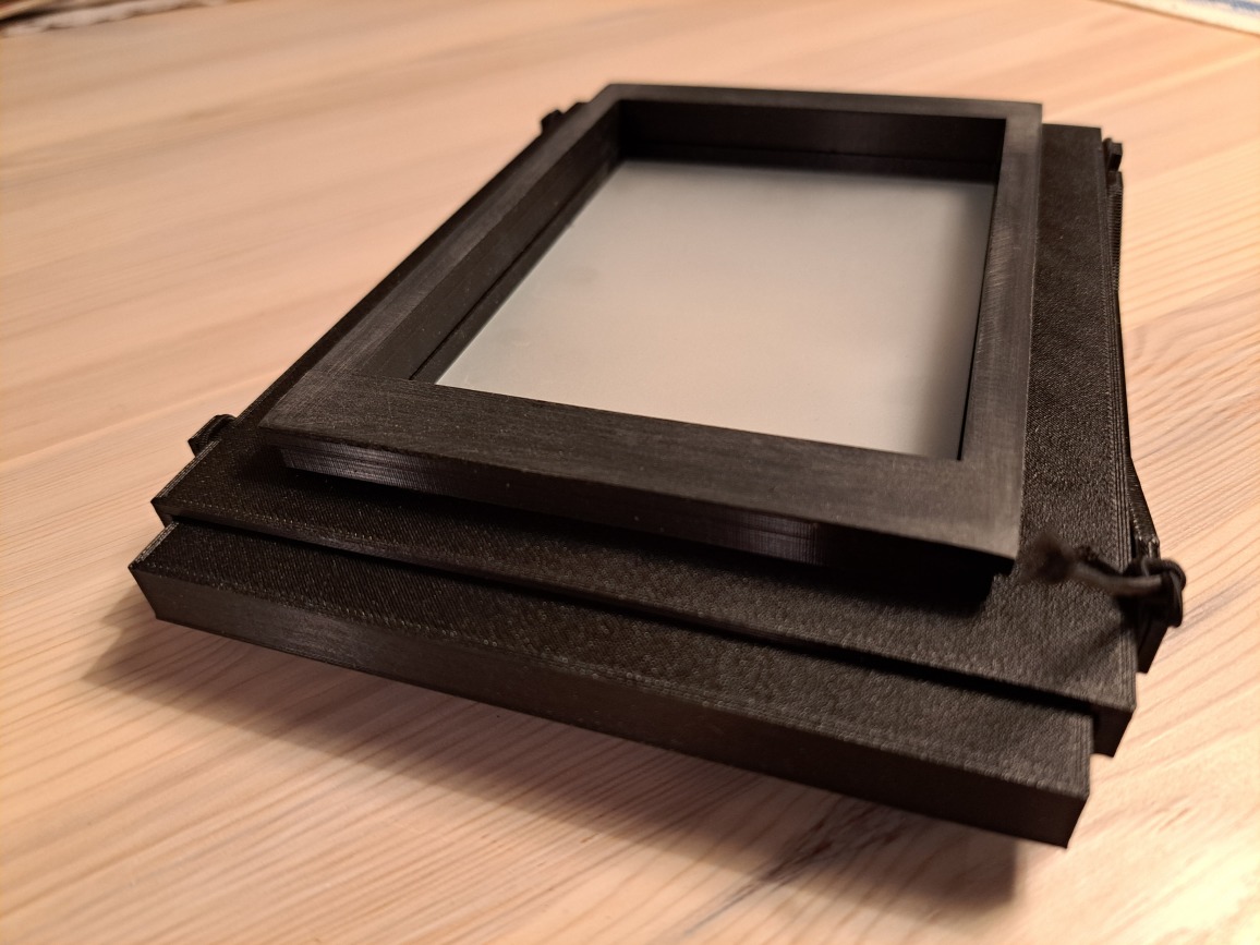

I have been lurking on these pages for a while ever since I bought a Voigtländer Bergheil to have something smaller to shoot with sheet film. I have to confess that the metal plate holders with film sheaths are an interesting challenge, and probably like a lot of people, I have been buying things on auction sites that look like a probable fit. I have a couple of holders that are in the right direction (they had a single narrow fold which I could shim out with something), but for dealing with the short term, I 3-D printed a back that takes 'modern' holders and I already had 4x5 film holders that fit, so I can shoot now. I had to design a holder for the Bergheil but it took only 2 tries and it seems to work.

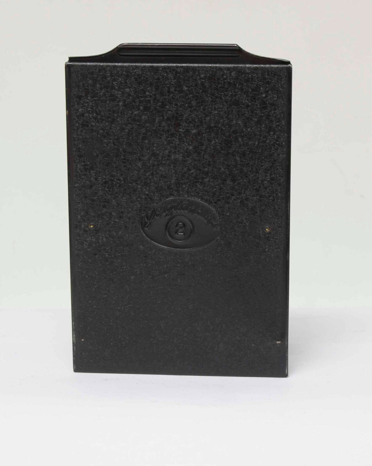

The reason I'm posting this is that my latest 'attempt' to get 9x12 holders resulted in 5 holders seem to be 9 x 14. I can put a 9x12 film sheath in them, but then it is 2 cm too short. I can slide them in the Bergheil, but the red 'plush' shows so obviously this is not going to work. They came with a mysterious camera and I'm not 100% the holders actually fit that camera, and it's pretty tired. It apparently took roll film but if there was a way to attach the plate holders, that part of the camera is fused shut.

Welcome. Those are the European equivalent of Postcard size holders, I have some. I'm not sure what 9x12 plate holders I have left, I had 3 boxes full of metal plate holders. I may have some flat edged holders, I need to check in daylight tomorrow.

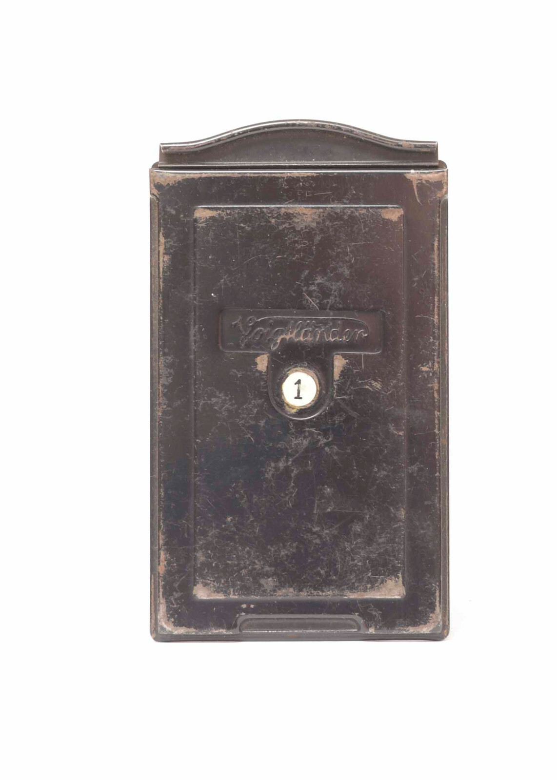

Original plateholders for the various Voigtländer camera's have the name imprinted on the back of the holder. There were different types as you can see below. These holders have a bit more height compared to other makes, like e.g. the ones made for Zeiss and Ica.

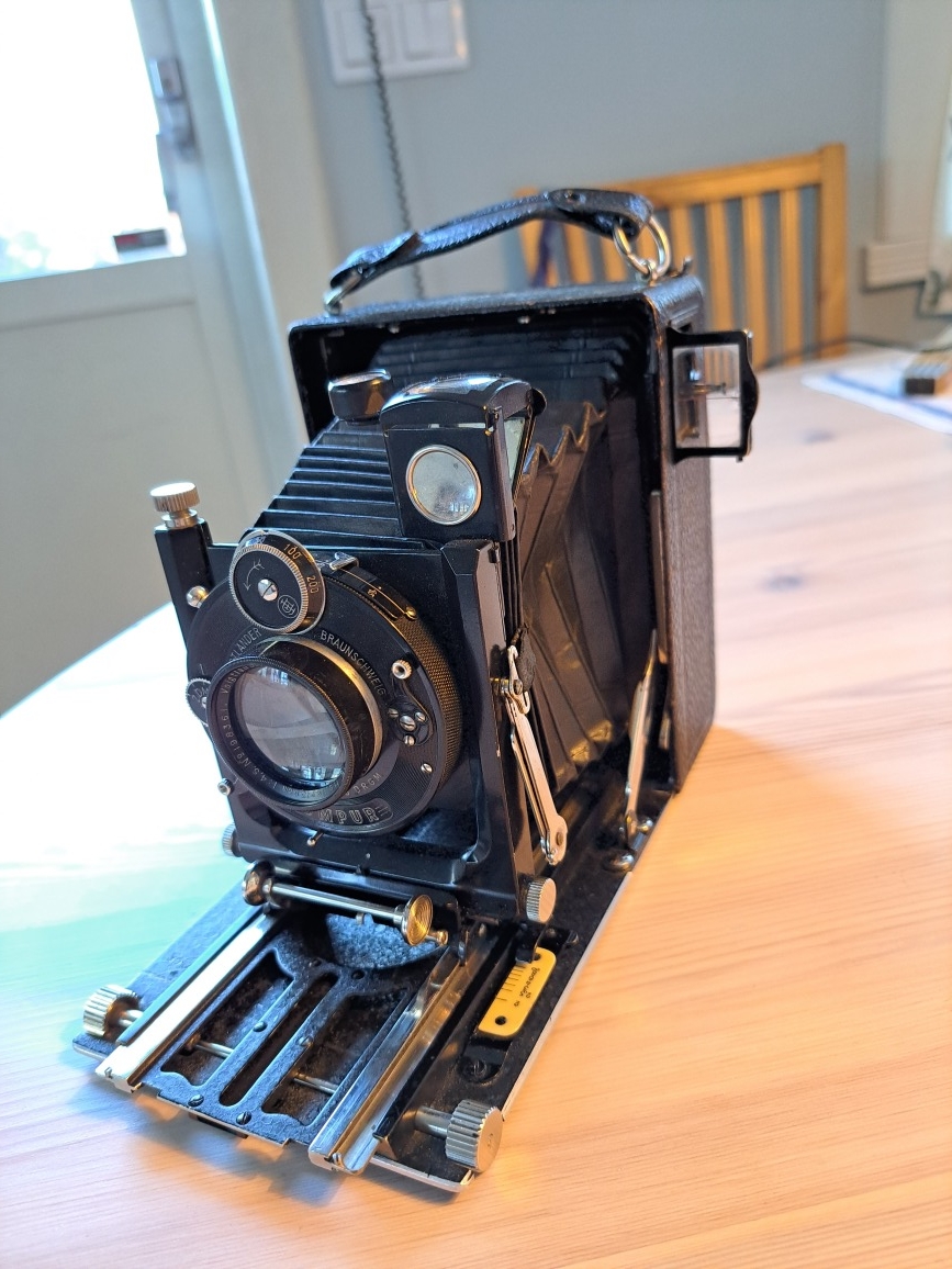

There were many different type Bergheil camera's; it could help if you post a picture of yours

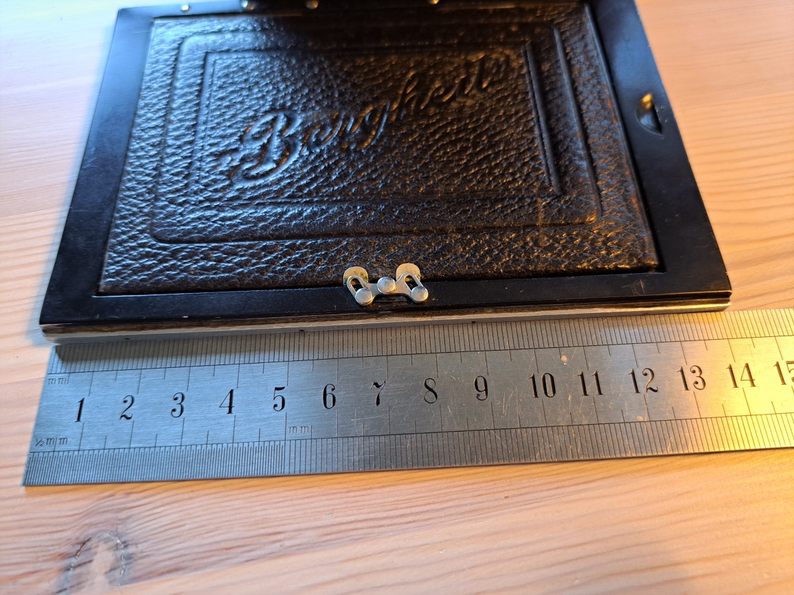

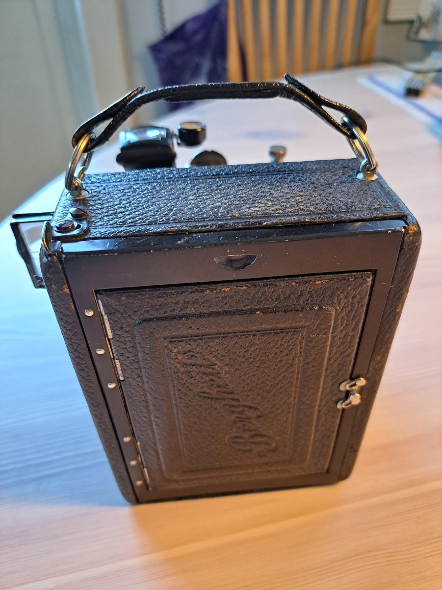

For some reason, I had assumed that the film holders were going to be the same, but I realize that I was being a bit naive. Here are some pictures.
As far as I can figure out, the camera is from around 1922, based on the serial number of the Heliar (45816) and the Compur shutter (720201). It doesn't have the wire frame that swings out by the lens, but a little viewfinder on the side. As far as I can tell, the lens/shutter assembly isn't removable. Slow shutter speeds are sticky but the faster ones seem OK, though I haven't tested all of them.
The last picture is the adapter I made showing the 'camera' side. The part sliding into the camera was printed 143 x 101 mm but it took some sanding to get it to slide into the camera.

I just noticed that on the picture of Bergheil, the bellows are pushed in. That must have happened when I opened the camera because they are usually OK.
Most the 4 x 5 adapter parts were from thingiverse and originally desgined for an Avus. The Avus adapter plate was too thin for the Bergheil and I designed a thicker one in Freecad. Details are posted in thingiverse if anyone else is interested.
I made the ground glass with a piece of window glass and valve grinding compound (which might still be a little too coarse).
