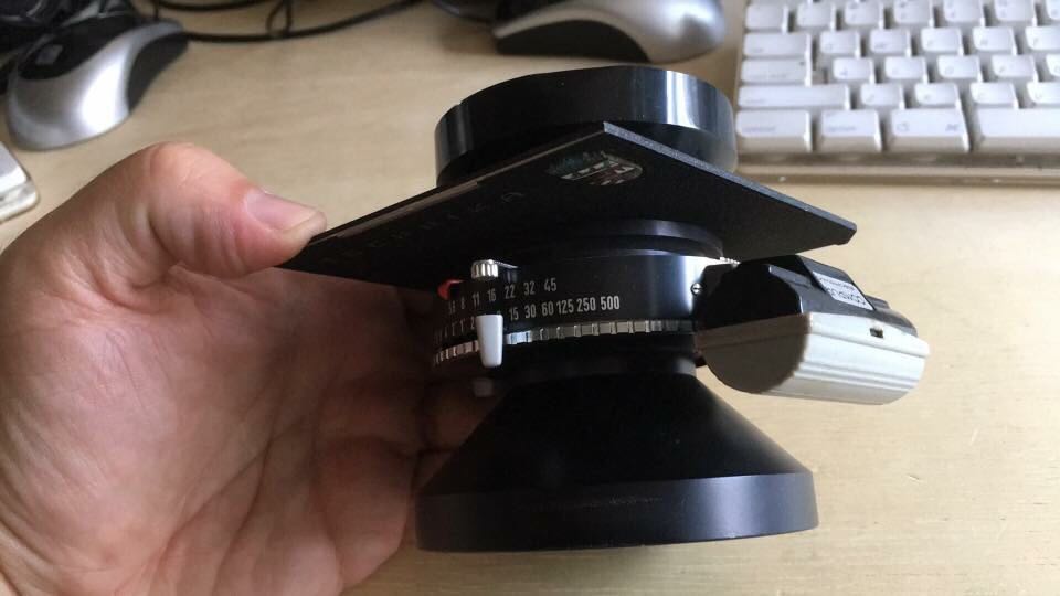

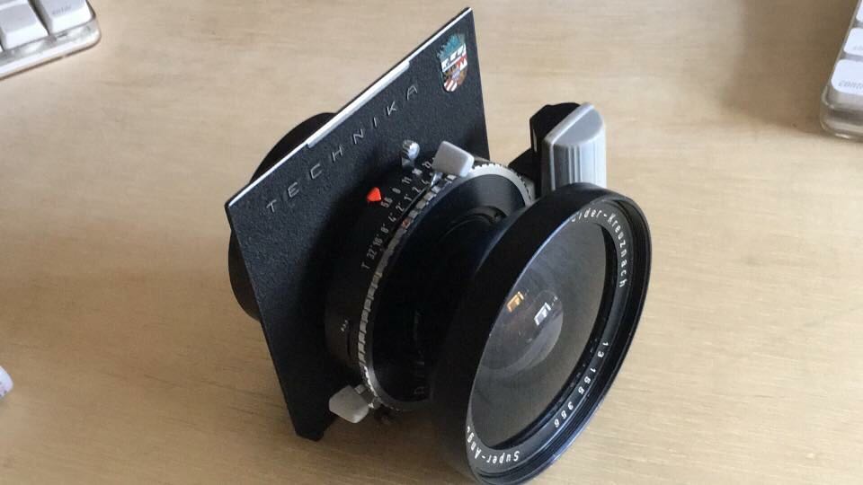

Also, there's a guy I know that's selling a Super Angulon 90mm f/5.6 here in Brazil, in a Copal 0 electronic shutter.

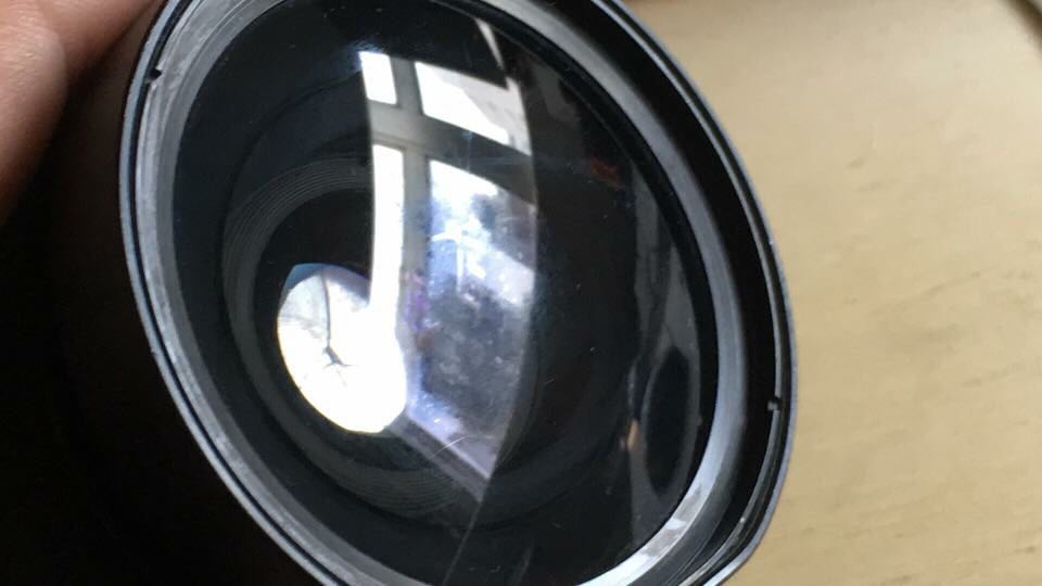

He's asking $312, which would be a good price, considering I can drive there and get it — no fears of junk mail, no exorbitant shipping fees, no wait and no customs fees or taxes! Except that the front element is fugly (see attached images)! :sad:
The board is not included, but an extra battery is.
I don't think it will affect image quality. I was even considering polishing the coating off, but heard it wouldn't perform much (if any) better than the way it is.
I like mechanical stuff way batter than electronics... What do you guys think about this shutter?

Be wary of electronic shutters... repairs may not be possible... batteries may not be available (I don't know).
That price for a damaged 90mm Super Angulon seems high to me, especially one mounted in the unpopular electric shutter.
My suggestion is to keep looking for a lens in better condition.
That price is average (but not on the low side though) for a pre Multi Coated 90mm f5.6 Super Angulon. It's the rear cell that has the ding on the edge of the rear barrel, I'd want to test it first to make sure it hasn't affected the lens sharpness. I can't tell the condition of the rear glass from the image.
It's not a bargain it's a risk.

You guys are really eagle-eyed! I didn't catch that ding (an euphemism, IMO), but now it screams every time I look at it. Wow.
I also didn't see that the coating damage is on the rear cell, which will definitely affect image quality.
All that, plus the uncommon shutter and I agree with you guys... it would be a bad, bad deal. :wink:
