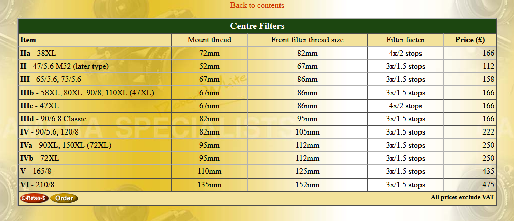

Looks like chart has specific lenses listed. I.E. IVa and IVb exactly same size and factor, but IVb just for 72XL, even if IVa also lists same lens among others, Only Schneider can explain this.
Perhaps I look at it differently, it seems to be more about a lens' angle of view/coverage. rather than focal length, then throw in the physical restraints of the filter thread.
Schneider's XL range of lenses were exceptional and not matched by other lens manufacturers. The screenshot I posted was from a leading UK LF specialist, and from an early 2000s page, other sources state that there was more compatibility than shown there.
