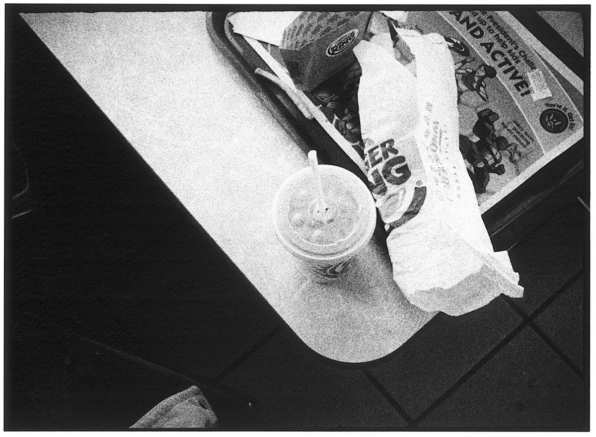

Did you notice any uneven development. I use Jobo reels that were cut down, but the spirals impinge on the development area, so some frames have lines of under-development as shown in this print. It is hard to burn those away while printing.
I still use the Jobo reels because MOST frames come out fine. For example, only two frames away, this one printed fine:
I think there's more to that than the reel -- I see multiple stripes of varying density across that first image. Bottom (presumable top of the reel) is light on the positive, so dark on the negative -- then dark, wide light, dark, light, dark going from bottom to top. Almost what I'd expect with a slow travel focal plane shutter under fluorescent lighting with short-persistence phosphor.
I have some cut down Unicolor plastic reels and I get those bands of weak developing too using rotary processing.

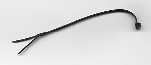

What I have done is make a hole in the negative strip, pass this modified cable tie around the hole and wedge the split ends in the reel so it pushes the film all the way to the center of the reel. What this accomplishes is to force the film base to the outer portion of the spiral so no part of the spiral is touching the emulsion side.
This works 100%, but it is very fiddly to do it in the dark. I gave up doing it a while back, but may start using it again.
The cable tie needs to have its locking mechanism defeated, then the end needs to be split, but still able to fit through the collar.
I'm trying to picture what you're describing, and I suppose if I try to do it I'll eventually figure it out, but I'm afraid the hassle will be too much!

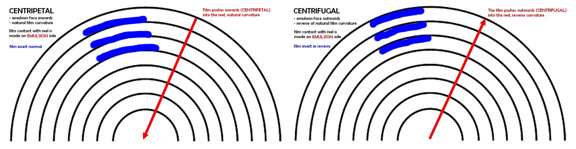

Tried that, didn't work (for me at least). The trouble is that when load the film emulsion side inwards (to the centre of the reel), the film strip pushes itself into the spiral, due to the curvature of the film strip, in a "centrifugal" sort of thing. When load the film emulsion side facing outwards, the same curvature of the film does the same, but in reverse: it pushes into the spiral, only this time in a "centripetal" manner. Simpler put, in one instance the film tightens itself inwards, in the other instance the film expands itself outwards. I hope this explanation makes sense.
I haven't looked into this properly, but processing the film strips in both positions gave me the same results: underdevelopment of the sides of the negative. What is curious is that all the films I've developed with this reel had some frames properly developed, say 3-4 out of 30. This could be due to the film strip staying clear from the grooves at some point.
Could be that the groove vertical separators are too straight, and thus making the film adhere too firm to them? Again, I haven't gave much thought to this entire thing, but it would seem that this issue renders the reel somewhat less usable.
I hope you have good results with your trial, and I wish to hear about this, if possible. Thank you !

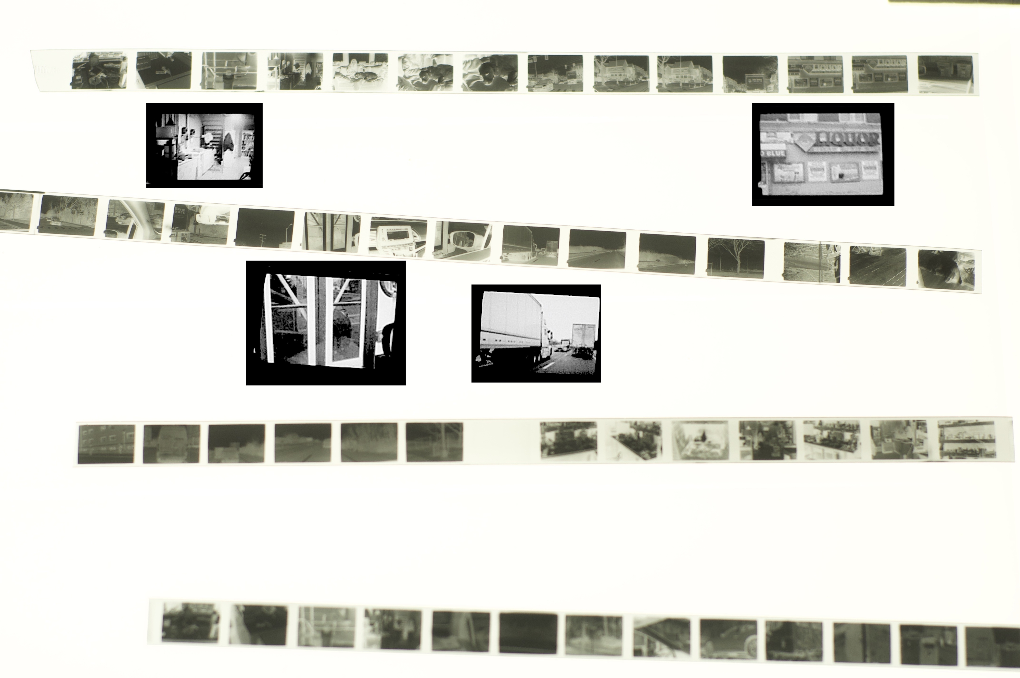

These were just dry and on my light table. I inverted some of them and they look pretty good.
Below is a picture of the film being processed. I'm using modified Jobo reels in a Jobo processor, rotation "P" 24C, 4.5 min T-max developer. I have two reels, so I can do two at a time in a 1500 series tank.
These strips are from the cameras I just fixed. Top two are Yashica Atoron Electro, with the ASA wheel set just past the 200 mark (as far as it will go).
Bottom strips are from the Yashica Atorton non-Electro + Reveni light meter.
That's interesting, thoes don't seem to have underdeveloped edges, at least as far as one can see in the photos. I wonder if it is partly a matter of what type of film is used, too - maybe some curl differently than others when wet?

Granted, some films have softer base than others, like Fomapan is softer than say, Rollei 80s. However, given the curvature of the negatives, it doesn't matter what face you load the film, it always touches the reel emulsion side.
Of course, the constant rotation or more vigorous agitation of the tank could very well create enough flow to make the chemicals go between the edges of the reel and film. Could this be the explanation of your recently developed negatives, which shows proper development?
If the film would be recurved, so it would hug the reel base side, then all would be well. But this is unfeasible, from what I know.

This is what I think is happening. If I load the film with the curl, then the film hugs the reel tightly and does not allow chemistry to the emulsion where it touches the reel at the edges.
If I load it backwards, against the curl, the outward facing emulsion indeed touches the outer spiral, but only very loosely. So the sloshing of chemistry allows can easily get between the film and the reel.
