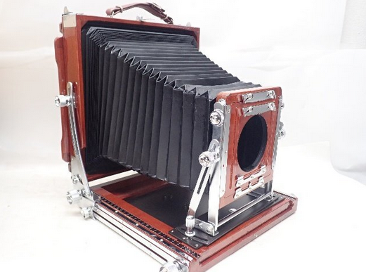

Hi community, I recently received an 8x10 Tachihara camera which i bought. It am totally mew to 8x10. I have a few questions,
The bellows close to the lens attachment part are slightly inverted. I found 1 tiny pin hole around the same area, any recommendations on blocking this without having to change the whole bellow?

Black archival fabric tape used for book restoration or art can patch up pin holes. Possibly with a little help from a flexible acrylic black paint. If they are really pin hole sized, the black paint may be enough.

The cheapskate repair consists of a piece of duct tape or bookbinder's tape, maybe with a bit of aluminum foil underneath. A somewhat more fancy repair is to use some kind of liquid rubber that you dab on the pinhole and then allow to dry.

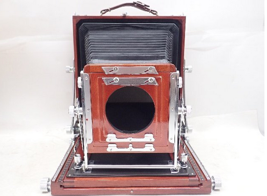

as i am currently looking for a lens for my Tachihara Hope Fiel Stand 8x10. I just want check what is the baseboard compatibility for lenses for Tachihara this Tachihara?
I will attach a photo below

I believe that takes Sinar type 140x140mm lens boards, plus it looks like you have a Wista type adapter installed.

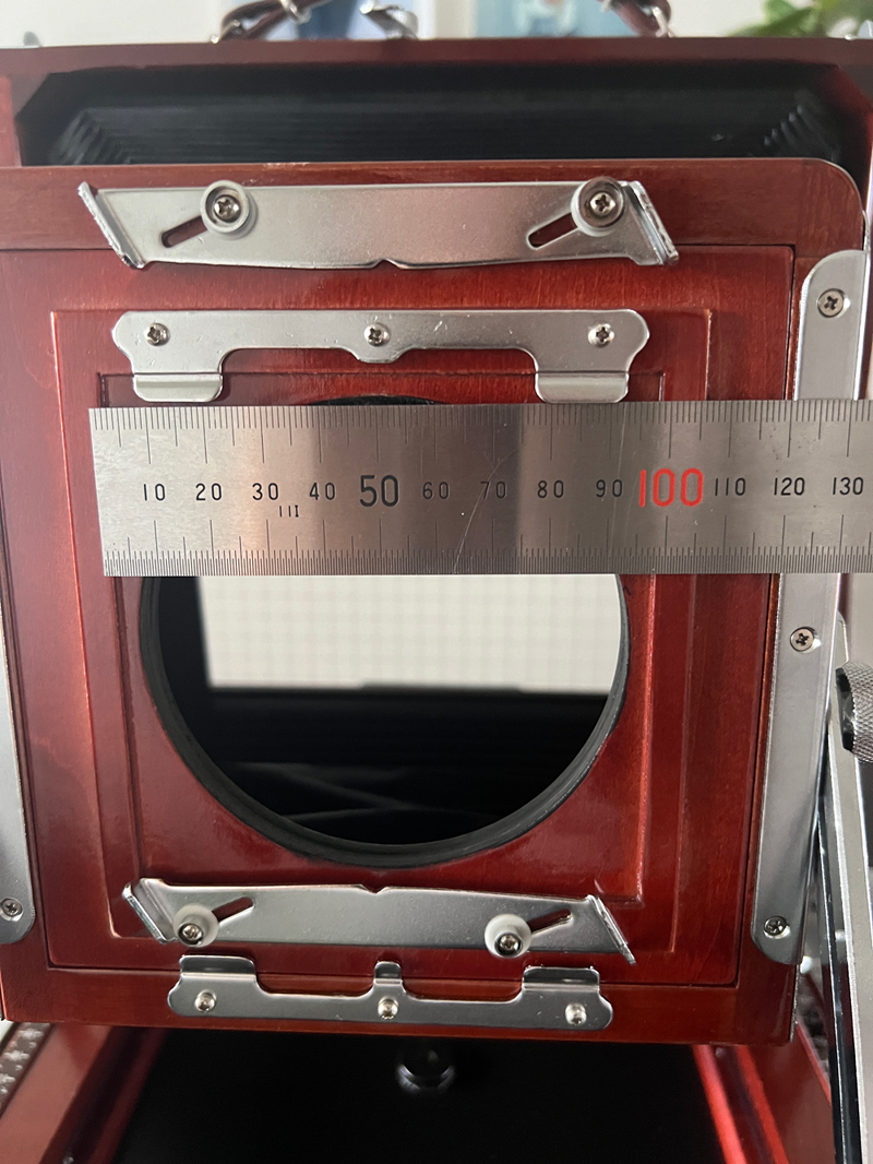

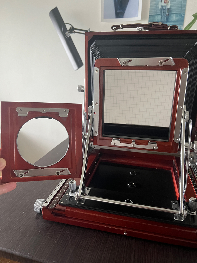

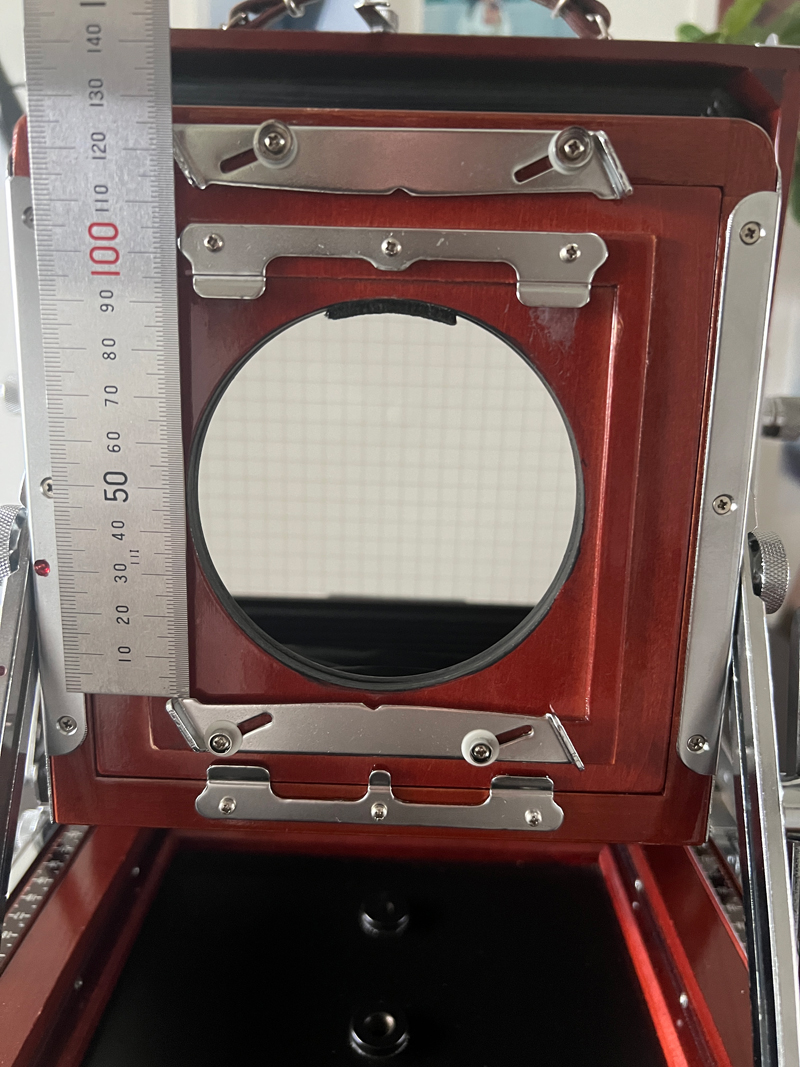

I have taken a few photos with a ruler also, the lens board is removable, not sure if that is the lens board?, let me know what you think.
Thank you

The Linhof lens boards measure 96X99 mm, it looks like your adapter will take Linhof boards. Those are easy to find, either original Linhof or copies. 3D-printed boards are cheap and widely available.
