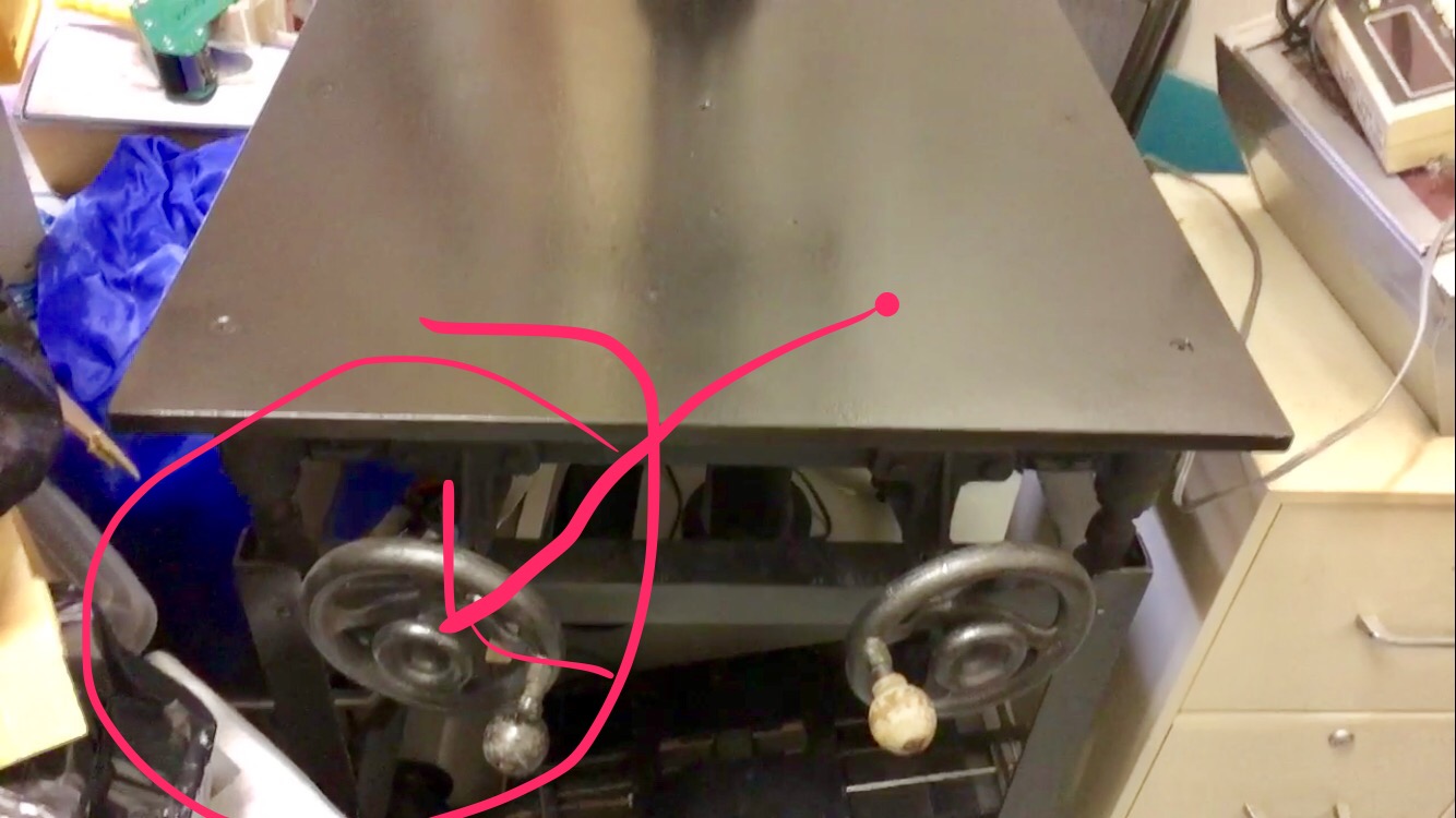

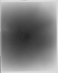

So, I have an 8x10 Saltzman enlarger I've been trying to get up and running for some time now. Life has gotten in the way but suffice to say slowly but surely I've been getting close but have a few snags.
The two big problems are...
1). The head drifts and doesn't lock properly.
2). The light doesn't seem evenly distributed.
Back to part 1). I THINK I'm missing a part of the locking mechanism. There are two smaller knobs in the middle of the larger adjustment knobs that seem to be for locking down, however I suspect something like on an Avenger/C-Stand has that probably back in the 1930's might have been maybe a leather disk? But I'm not entirely sure and I need someone who owns one to show me pictures of their knobs EDIT: or rather BEHIND he knobs that might go between the front knob and secondary knob or possibly behind the second larger knob END EDIT: and the so I can figure out what I'm missing on mine. Maybe even a skype session to figure it out if that's an option?

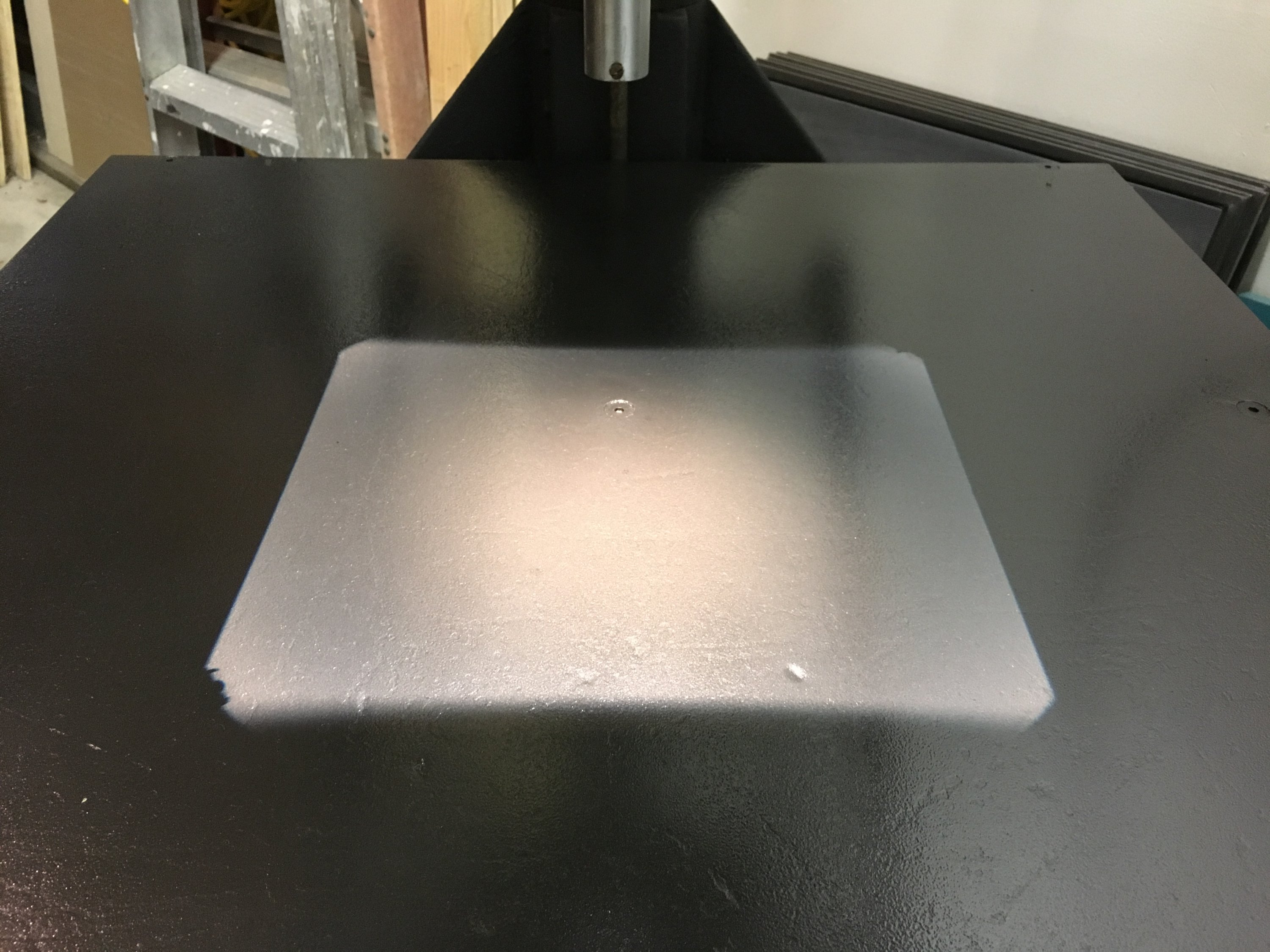

And 2). I THINK there must have been a set of diffusion filters or something that helped spread the light out more evenly. It IS a condenser enlarger, so in theory shouldn't need one, but perhaps because the exposure area is so big something else was needed to spread the light?

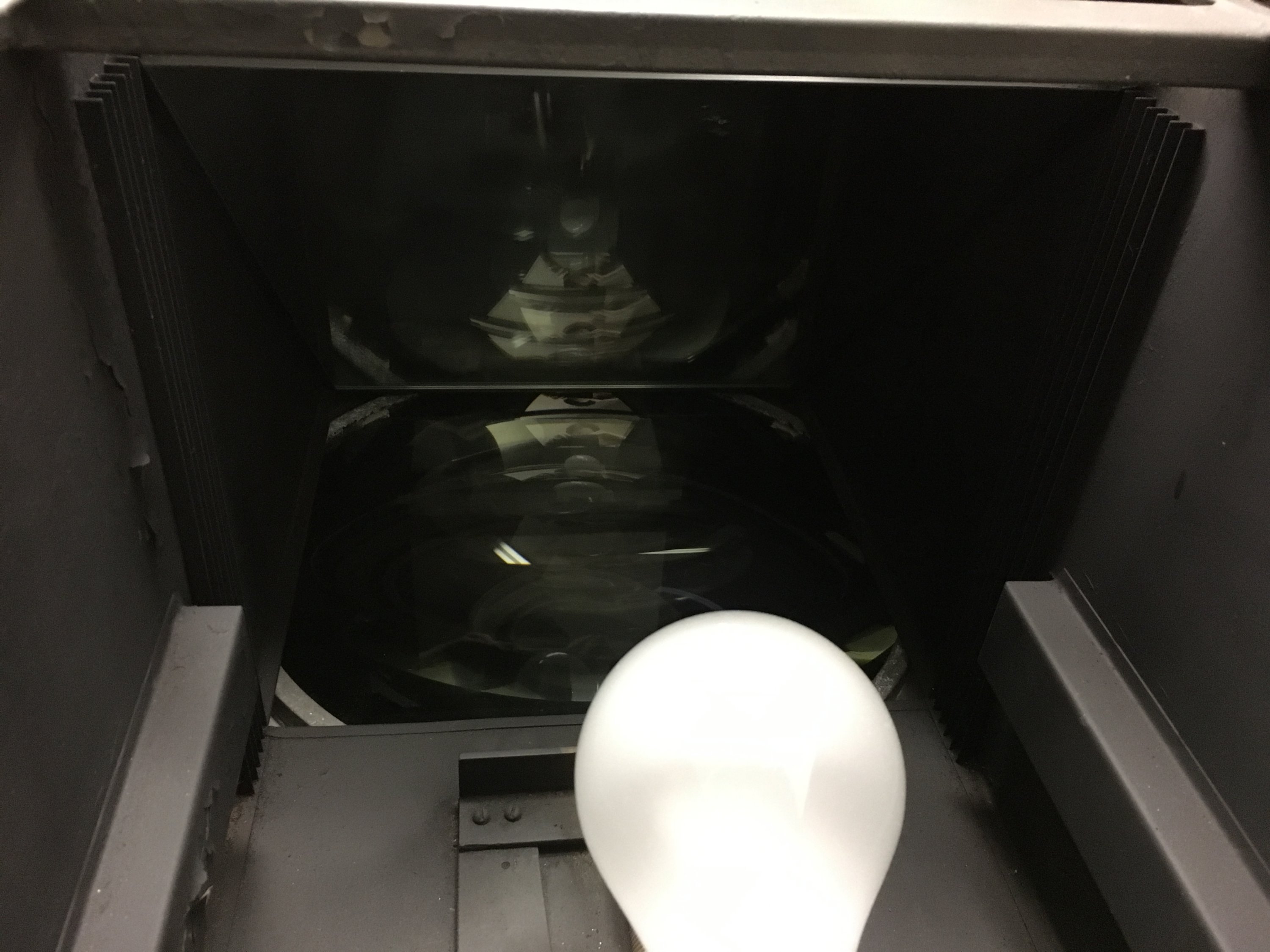

And then the light problem...

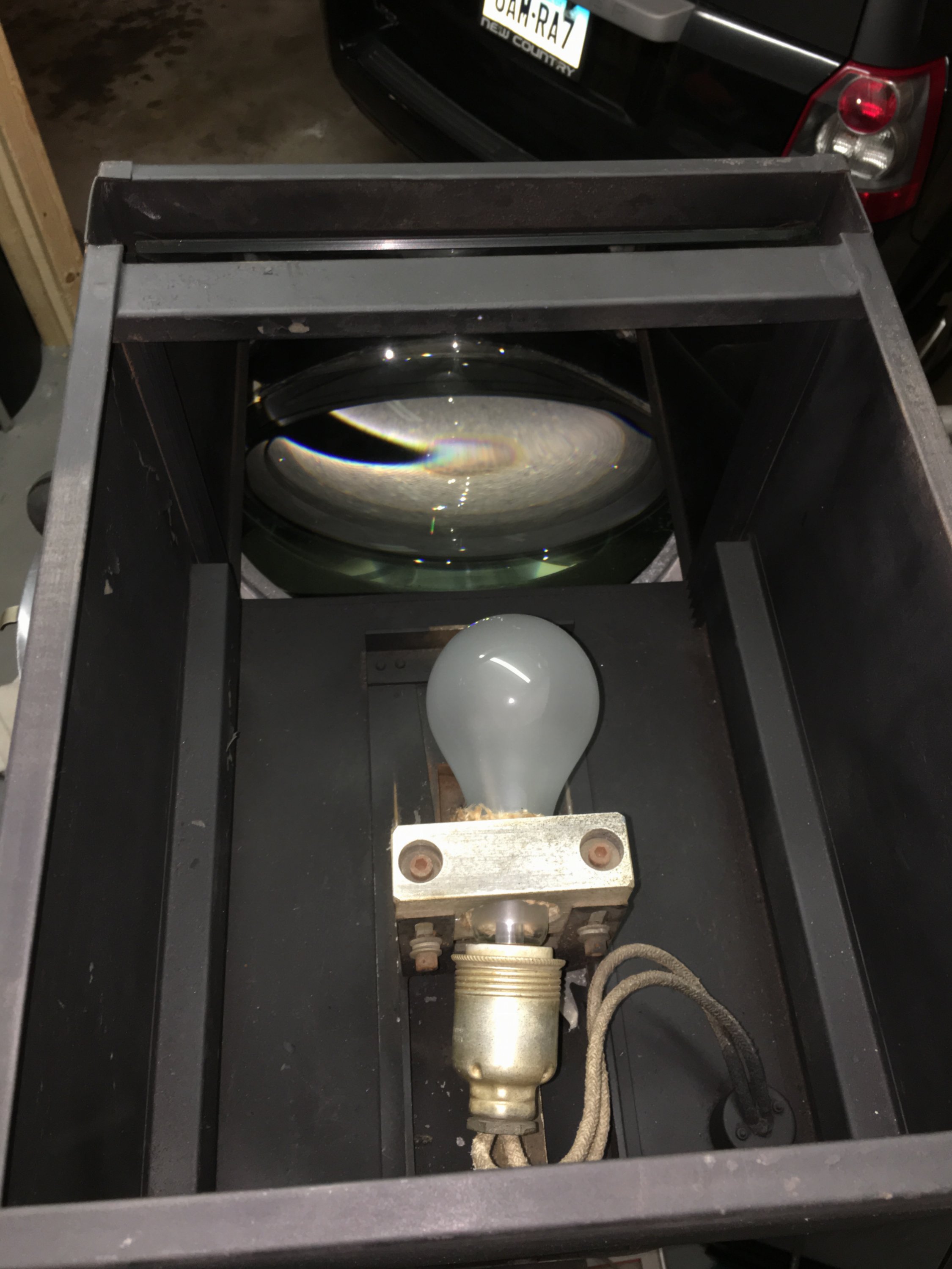

As you can see it's in the center, the bulb itself moves closer and farther from the mirror that reflects down to the condenser lens, but it doesn't pull back far enough so I know there must be an additional mechanism I'm missing.

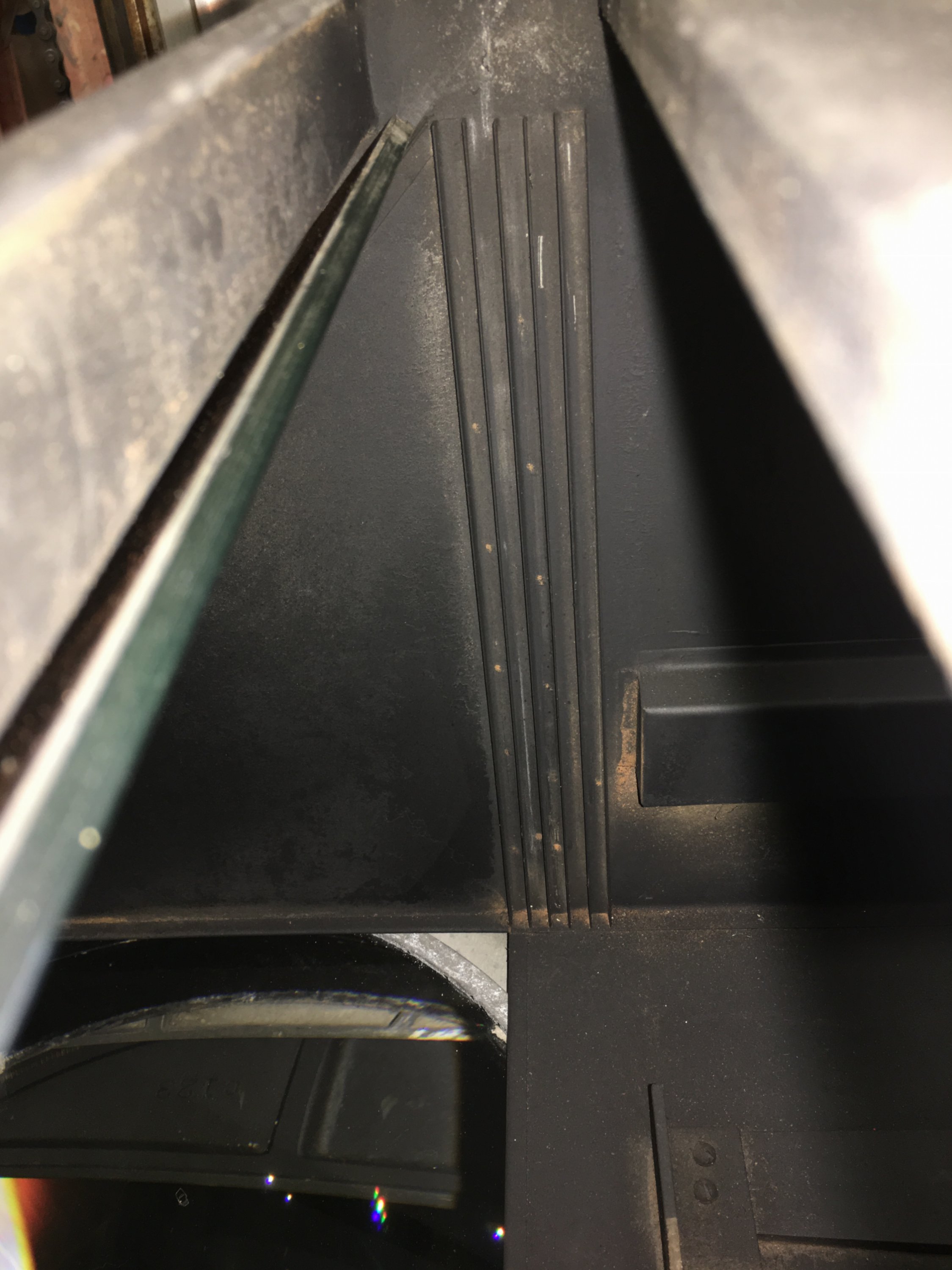

Inside the light housing there is what appears to be 3 slots that SOMETHING must go in. I don't know if this is simply for color printing? Or for diffusion panels? I'm pretty sure they didn't have multigrade papers then, so I'm guessing it's a filter diffusion system but I need to know more to get it done correctly so if anyone has spare parts or even just an example I could see, that would be tremendously helpful!
Inside pictures... (ignore that the light isn't perfectly fixed inside)
And the 3 slots next to the mirror

#2 Socket needs to go into aluminum block. Block is made to go up & down so as to get even light distribution. Use something to loosen probable rust.
#1 can not help Look to see how other wheel is secured.

As far as #2, the bulb does go forward and backward as you said, however it is at its farthest rear positions and still doesn't have a broad enough spread. I know it needs to be fixed in, there's no rust, but as it is in the picture it's actually farther back than it would be if it were inserted properly into the block in a fixed way. So there must be an additional "light spreading device" I'm thinking?

Are you following the basics from the manual?
You have the 14" condensers and they are in the correct orientation?
Bulb is #302 or same size or larger substitute?
Lens is 300mm or 12" at f22 or smaller?

FWIW. when you get an explanation about the lock, if you can't find
leather can try a fiber washer. Those you can find at the hardware store.

I've never seen a manual for this enlarger, do you have one? That would be fantastic! As I said in my original post I would love to have a operational manual or assembly instruction manual, but the only thing I've EVER seen was the buying advertisement catalogue. Do you have a manual?
Yes the Condensers are in a fixed housing, you can't adjust them, the both face inward toward each other (as in the convex faces the other convex and the top and bottom of the entire assembled piece is flat on the top and bottom because the convex portions are facing each other inside the housing), that's how they came and AFAIK they don't go in any direction but the one they are fixed in.
The bulb is an equivalent, the only thing different is the stem circumference (which is skinnier as you can see) but I'll be adding a secondary collar, it's just that this is asbestos lined and I have to tackle that carefully for obvious reasons.
Lens is a 240mm. I do have a 300mm but I was told the modern 240mm lenses would be just fine because they have a wider coverage. Mounting the 240mm was difficult enough, I'm not sure I can mount the 300mm easily, I'll have to take it to a tooler (SK Grimes?) to get it mounted, I also only have a few lens boards, so I have to be careful. But AFAIK I should still be able to use the 240mm? It's an EL-Nikkor 240mm which should cover just fine from specs (and what others have said on the forum). I'm open to understanding why that might not work, but if it covers, it shouldn't matter, if the light isn't covering the full 8x10 surface of the actual negative.
I'm confused about the f/22 or smaller comment. I've always printed only 2 stops smaller than wide open. This has produced the sharpest prints with the least amount of exposure time, any smaller and I'll hit reticulation as well as EXTREMELY long print times. I would never think of doing f/22 unless I were using some tilts to fix a perspective / lines / angles in the image. On top of that, when I'm focussing I have the lens wide open and it always covers the full image evenly just fine, so, what am I missing?
That's a great idea! I'll have to get one from a specialty place, Home Depot doesn't carry any quite as large as the linkage on this thing, but thank's for saying that, not sure why I hadn't thought of that before, that's what they use on my 8x10 and 4x5 on the locking knobs. Thanks!

Hmm... Perhaps it's not a diffusion filter that go in the slots, but a special Center Filter, gah, I wish someone had one of these to let me know. Sigh. Again, you've mentioned the manual, if you have the manual PLEASE send the PDF my way. This thing is from the 1930's so... I'm not sure any still exist...

I'll explain with analogy. Imagine the condensers focus the light to the lens. So your 240mm lens, when focused on the negative correctly for a given enlargement, will not be in the same position as the 300mm lens. Therefore you need a different condenser combination, which does not exist.
Sorry, the MANUAL I refer to is the extensive brochure that I believe you already have. You need to read every sentence and infer what they mean.
For example ( from the last page at the bottom small print)
A 12" lens must be used with pair of 14" condensers for enlarging.
In terms of using the slots for diffusion sheets, I'd try it but the manual always refers to "diffusion sources" as other than the condenser. My reading is the condenser head is "flexible" because it can do point-source and opal lamp.
All enlarging lenses with wide focusing apertures have a horrible hot-spot unless stopped down.
For example the lowest green solid line is a lens "short for the format" at high magnification wide open. The top dotted red line is a lens "equal to diagonal" used at small magnification and stopped down 3 stops. Still showing less than 80% illumination at the corners.
You won't see the effects, in prints, of diffraction, with your 8x10 enlargements until f64.
My usual aperture for 8x10 enlarging is f32.

UGH... I wrote a wrong reply and then by the time I hit "submit" APUG was "down for scheduled maintenance" and I lost it all...
I don't have time this morning except to say I figured some stuff out last night as I spent a lot of time, the substitute bulb that was in there was just slightly smaller in diameter than the original bulb, and the also had a much longer neck/stem so it wasn't far enough back. The second option substitute was much shorter and almost eliminated the problem, the actual original bulb seems almost completely even to the point I'm not so worried. The 300mm is still probably going to be my go-to lens, I'm going to see if someone in the manufacturing section of the community college can fabricate more lens boards and/or at least drill mine.
ALSO everything you said made sense.
I agree with ic-racer that the lens is too short for the condenser combination. The Durst enlargers give different combinations based on focal length, and I once had a Beseler enlarger that had different condenser positions for 135mm and 150mm lenses. If your condensers are fixed in place, you need a specific focal length. If the manual/ad pamphlet says 12 inch, get a 12 inch.
My De Vere 5108 has a diffusion color head with a different 8x10 diffusion box for 300mm lenses than for 240mm. The diffusion panels are thicker in the center than the corners to even out fall off. The panels for each size lens takes into account the amount of fall off they produce.
Thanks, I'm still hoping to figure out what the slots are for. I can easily see it being a center filter of some kind. Who knows... hopefully someone! lol.
