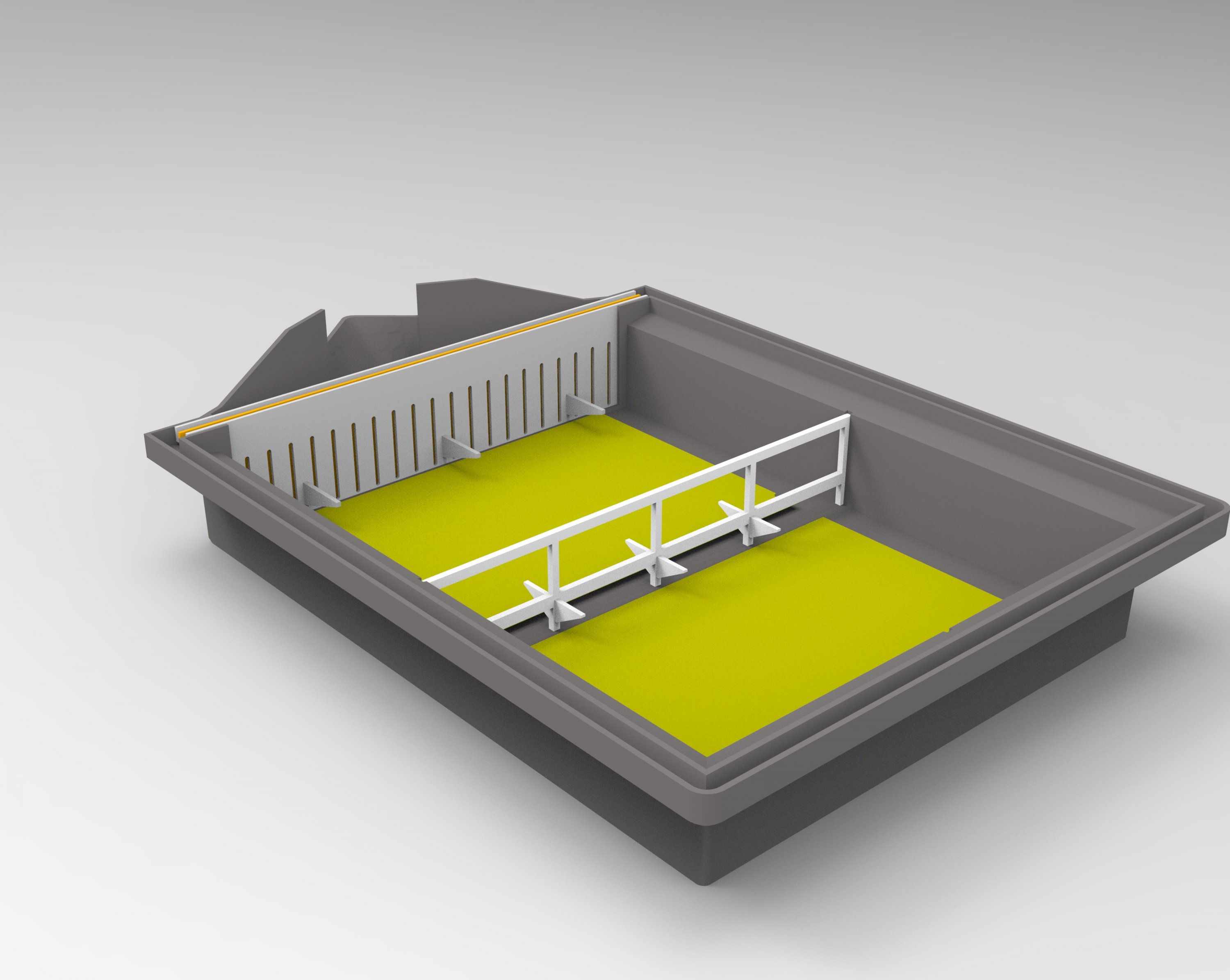

As an 8x10 shooter, I’m happy to see this. For film I have to spend a lot of time blacking out a room, and then restoring it after.
What might stop me from buying your system is that 8x10 film in a 8x10 tray causes overdevelopment along the edges. I also use pyro, which may or may not make it worse. I have to use an 11x14 tray (and 2 liters!) to avoid this. Is there space around the 8x10 sheet in your system? If so, how much?
I also presume that it only takes one sheet at a time. Has there been any thought or experimentation with two sheets at a time? I imagine uneven development is quite possible, but thought I’d ask.

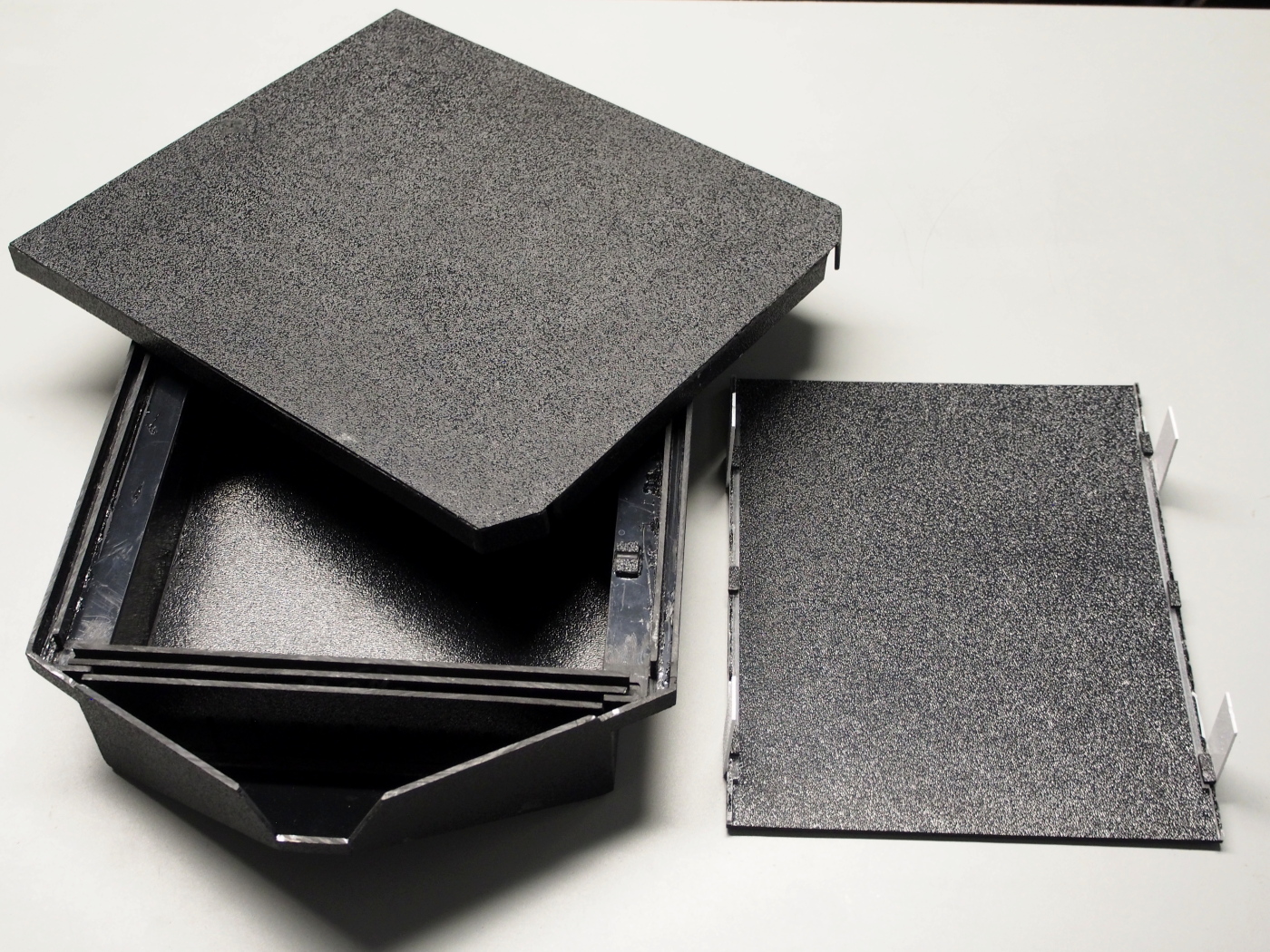

Jarin,
We're not sure tray size is the culprit. I know numerous professionals that process 8x10 in an 8x10 trays. I think agitation is the key. That said, most people use trays much larger than the film size.
The current prototype is about 15 mm wider and longer than the film. We're getting excellent results with about 1100 ml of solution. Oh, that's for TWO sheets at the same time. We haven't tried Pyro yet.
We're still working out the details. Hopefully have more info for everyone right after Christmas.

Hm. Maybe it’s because with pyrogallol, you’re using constant agitation. I lift each side of the tray in succession, working ‘round the tray like a clock, over and over, until the development time is through. Maybe greater frequency of agitation is why overdeveloped edges are amplified.

Artifex may be more expensive but still cheaper than the JOBO stuff. It’s much more sturdy than the large version of the SP445 and it can process 6 sheets at a time. That could make a higher price acceptable for me. I’m really satisfied with the SP-445 but your solution for 8x10 does not convince me yet: one sheet at a time is a tiny surplusvalue above open tray development. The possibility of a second sheet remained vague in the video. But I will certainly follow your developments. I’d say: profit from my feedback, the people that don’t give feedback but won’t buy it are a bigger problem for you I guess.

In terms of simplicity in processing one sheet at a time, three 8x10 trays side by side, catching up on my podcasts in the dark is hard to beat. Agitation is simple, I lift the front edge, side edge, back edge, other side edge each 30 seconds. Move right to stop for 30 seconds, move right to fixer, same agitation, still in the dark, turn the lights on and wash. You don’t even need to have water available where you process.
I’m skeptical of easily managing an 8x10 film back along with this tray and the palette in a dark bag. Mine is not large enough. If I have to build a cardboard darkroom as shown on the Stearman Press blog, I’d rather lay out three trays in the bathroom than find storage space for the ‘darkroom’. If I have to find a light tight room or closet, than I may as well, again, use trays.
At two sheets I’m interested but undecided. At one, not interested.
