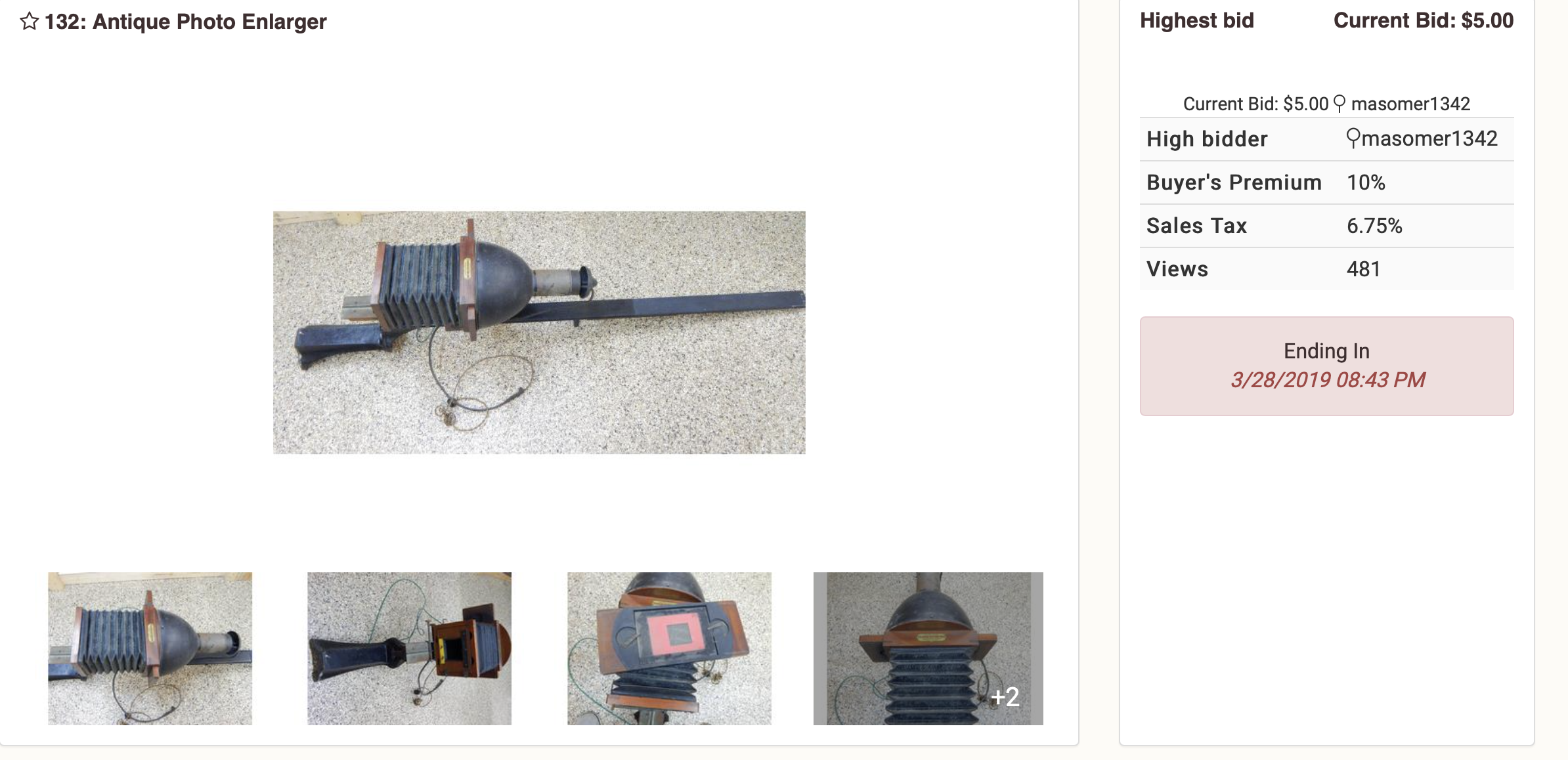

For example, here is an Elwood that was in Akron Ohio that sold for $5 not too long ago: 2019.

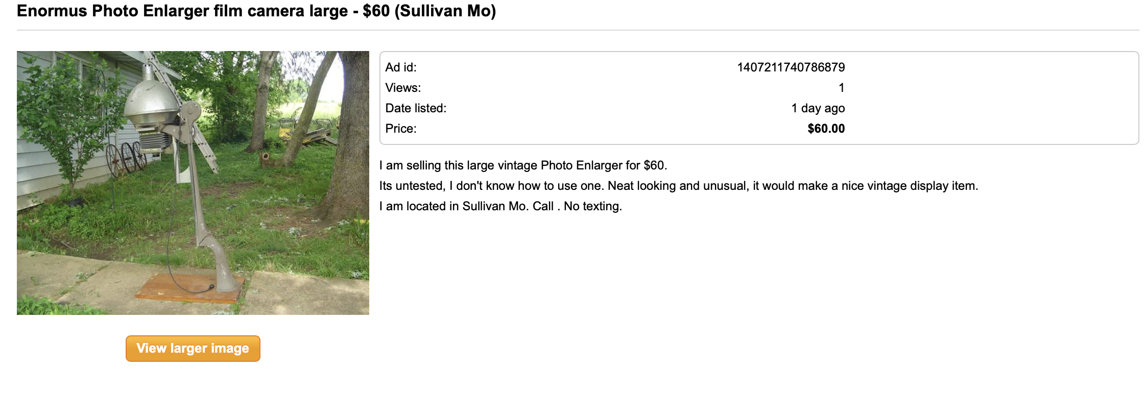

If you can drive to Montana, I think this ad is real. Elwood for only $60! Though this might be the 5x7.

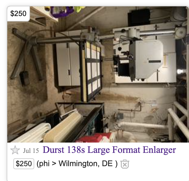

Using 'searchtempest' this is the closest Durst to Ohio, it is another 5x7 but only $250.

Glenn Evans of Glennview.com in Chicago can help you with 8x10 enlargers, but not cheaply. Sadly, I watched over 20 of the real-deal pro ones go to the scrap yard a few years ago, because I only had room for one other big enlarger enlarger in my darkroom. The one I took for free originally cost about $26,000 and was hell to move. So even the best do sometimes turn up with a price tag of zero. It takes timing and luck. If you are open to a conversion, the Durst 138 5X7 model is probably the most solid precise choice for retrofitting an 8X10 head and negative stage. Glenn Evans offers those conversions.
Durst commercial gear was designed to be capable of being tuned up. Unless it had taken a direct bomb hit in WWII, any 138 chassis for $250 is not something you should think about, but drive a pickup toward as fast as you can. Yes, some TLC will no doubt be needed, but even that commitment will giving you an appreciation of the sheer quality of the device.
