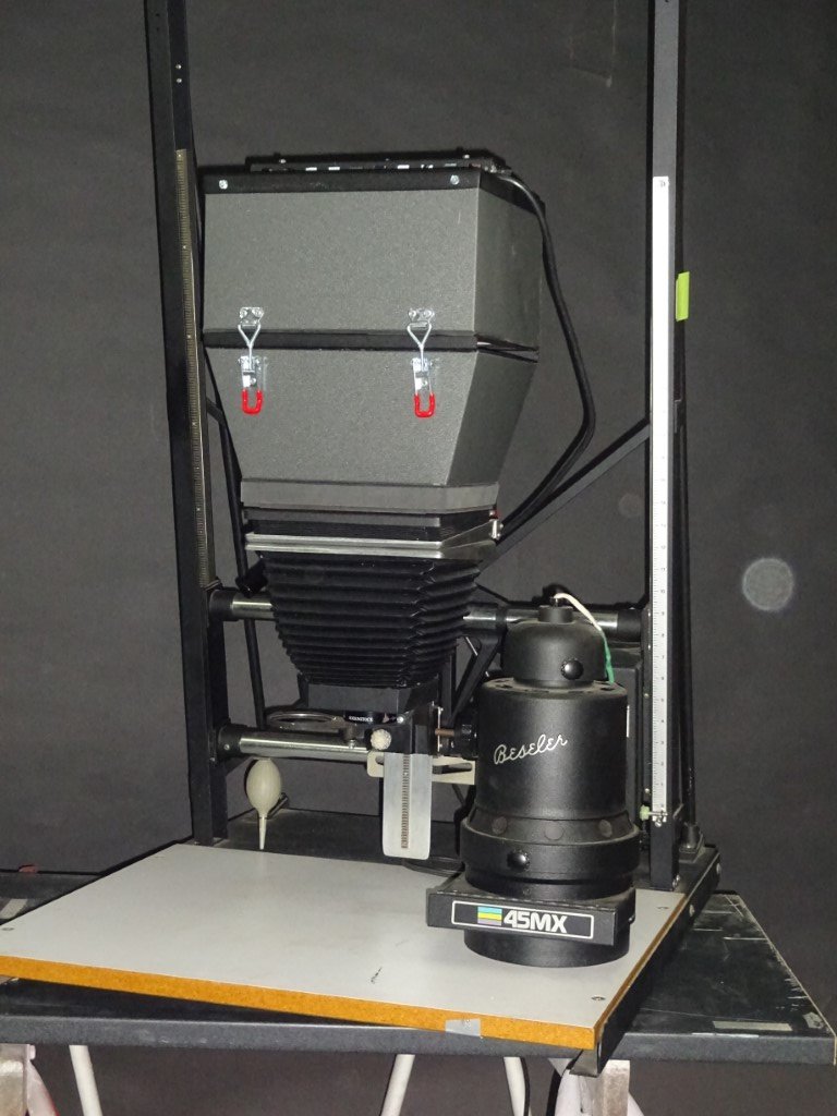

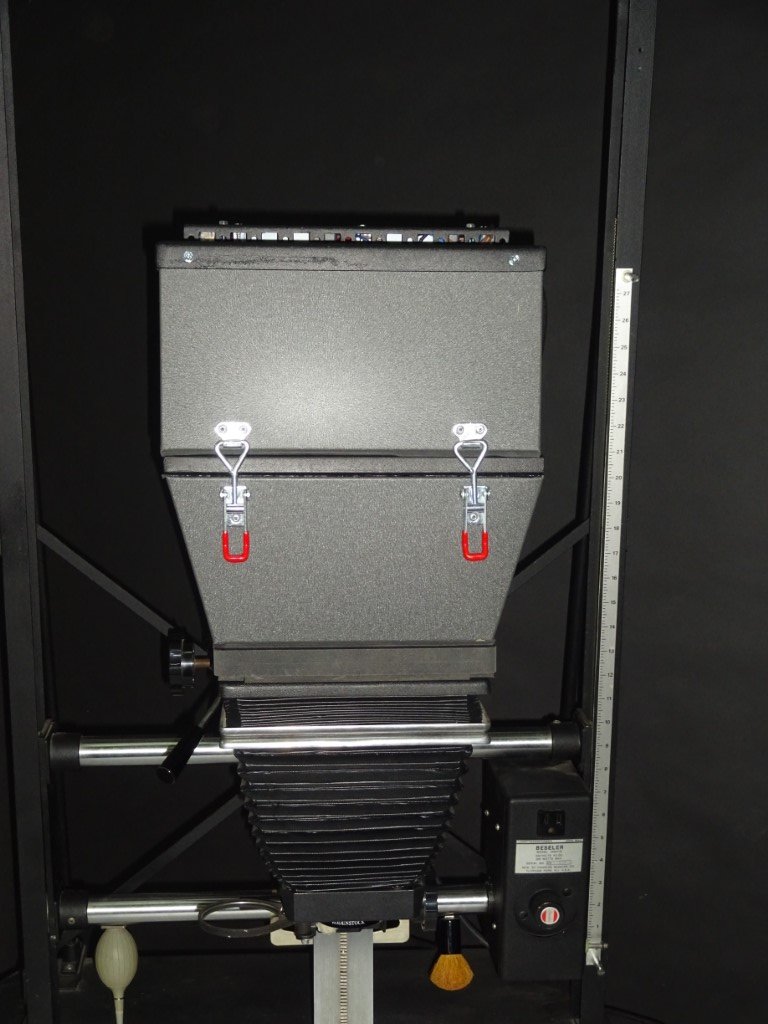

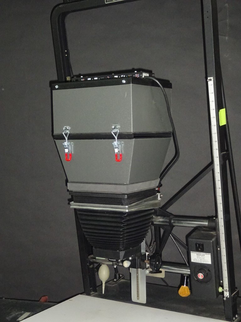

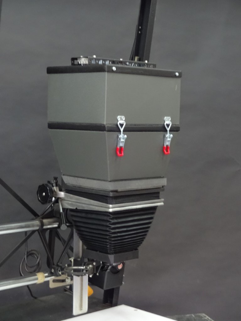

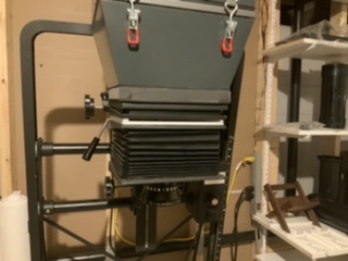

on request i made this conversion for the beseler 45 mx. it fits on the older blue model beseler 45 too.
the conversion is identical to my Durst 138s / G 139, apart from the adapter plate to the enlarger.
this link to the Durst kit has some additional information that covers Beseler as well :
https://www.photrio.com/forum/threads/8x10-conversion-durst-138s-g139.171164/
again i made a few extra kits for sale.
8x10" conversion Beseler 45 :
all parts needed for the set up included !
1 x light head with 53 pcs 3 w leds
2 x led drivers 90 - 240V atatched
1 x pyramidal stub on 20mm fiber mounting plate
1 x negative holder for up to 8x10 neg with 2 x glasses (the book type)
1 x light seal to replace 8x10 filmholder
(when you use original 4x5 holder for smaller formats)
4 x screws for assembling
10 spare bulbs,
1 spare led driver
conversion is made for 240mm lens, Beseler used to supply the APO Gerogon F9 - 240mm lens.
it is 20 mm higher and slightly heavier. my beseler has no problems with lifting it
dont worry on the F9 iris, the kit has plenty of light
vertical enlargemants more than 20x24"on the board
no need for a noisy cooling fan.
all parts of lazer cut steel and stainless material,
finished in Antracit - grey non reflecting paint ( see the darkest photos for reference) and black powder paint
all you you need is a screwdriver
and 10 minutes for first time assembly
thereafter it only takes few minutes ( 4 screws !) to change back to original enlarger head if desired.
for assembling , take off the 2 metal locking sliders for the Beseler condensor head . use the same threads for the conical part. of the kit. ( it is aligned for parralell negative , so do not touch the red marked screws inside)
your Beseler 45 remain 100% original , no alteration at all!

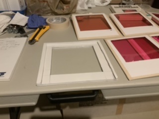

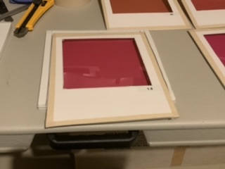

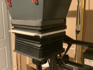

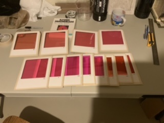

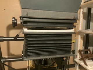

I am loving the unit you built for me previously (before all this lockdown bother)
I am attaching some pictures that show how I am using Ilford 6x6 multi contrast filters
I added a removable seat that inserts into the slot where the negative carriers were originally meant to go
I designed cardboard sleeves for the filters that slide into the seat
And finally an I-pad picture of a print that I created using your modification from a 5x7 negative
I like the way this worked so much, I am now going to try to build the seat out if a more rigid substance
Dan

Hi Klaus!
These look amazing! I am really interested in your conversion kits. I am new to this forum so I can not PM you. Could you send me a message or email me a jenniferg0897@gmail.com?
I am curious if you can make this with an 110v instead of a 220v plug?
You mentioned that. this is for a 240mm lens, would a 210mm not also work?
Do you think it would be possible to wall mount this unit and/or project horizontally on the wall?
Would you sell an extra negative carrier and do you happen to have any plans for a glasses carrier?
Lastly, I am wondering if this is only for the Beseler 45 mxt or if it would also work on a Beseler v-xl?
Thank you!
Jennifer
hi jennifer,
i have sent a mail to you:
yes i have transformers that work on 110 V
yes 210mm lens will work, but as said the sweet pick is 240 mm ( i have some 240 mm extra lenses that fits the beseler)
yes you can wall mount, but i use 2 connecting rods attached between the topframe and the wall.
yes horizontal enlargements is easy, i have the bracket that you need.
yes i have extra film holders of the book and double glass type.
i do not know if it works on v-xl model, i am told by another user that it might ?
klaus

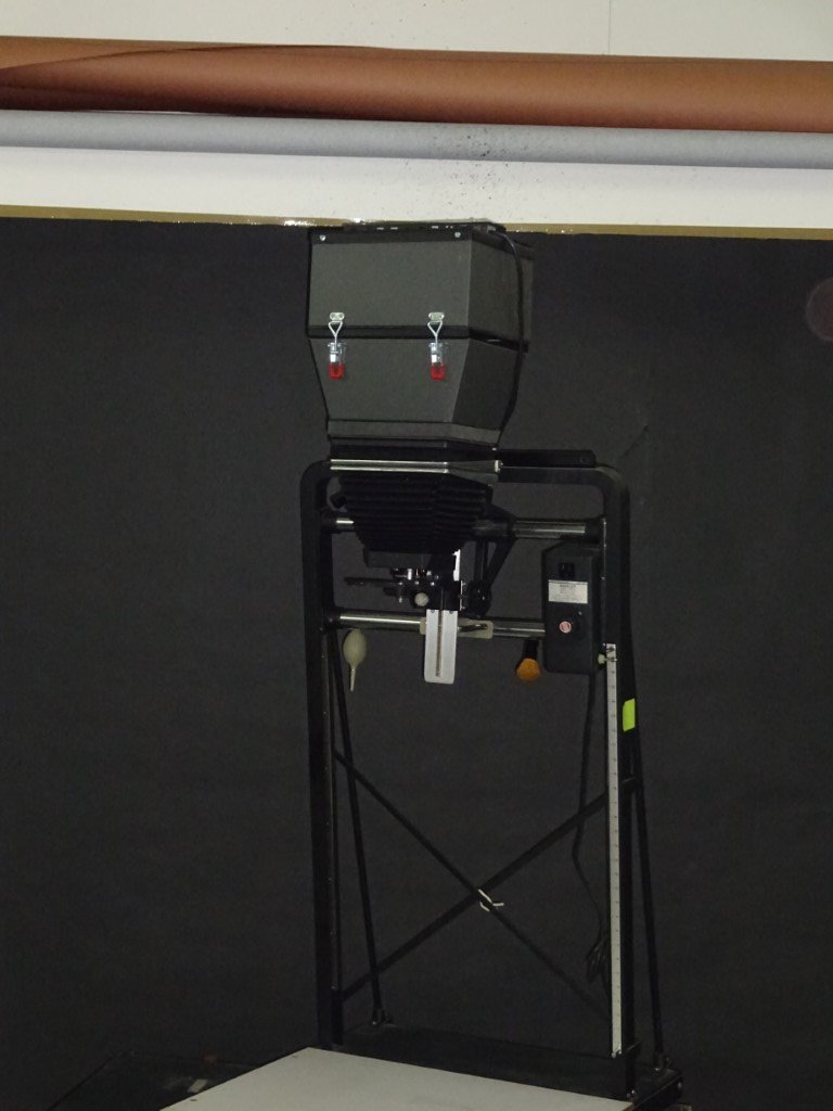

All is fine here . My friend Alan ross will be using my darkroom to give a class using your 8 x 10 conversion in june . i will pass on any comments he has .

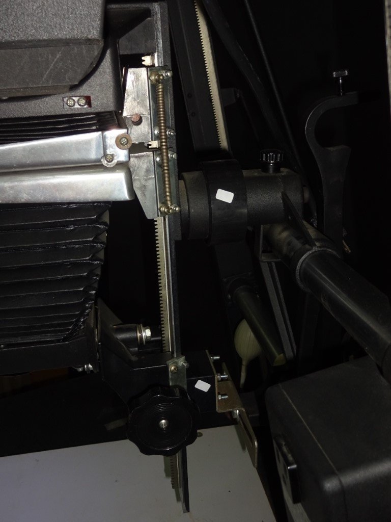

I know on the original Beseler conversion kits, they were different between the MXT vs VXL on the mount extension. Due to the difference in the straight vs angled chassis.

I confirm that the conversion works on a 45V-XL I got mine today and it fits perfectly! Very happy with it!
