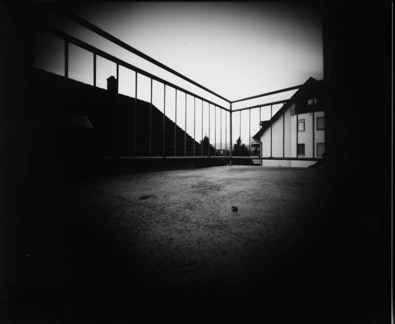

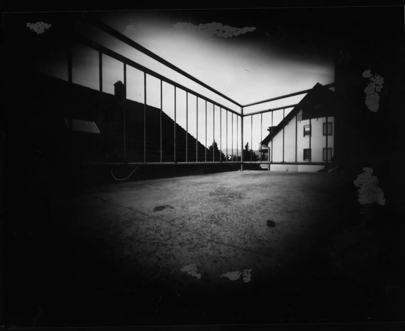

It seems the borders wasn't exposed. Could it be because it is too wide? Or maybe too short exposure?
It has 0.350mm Pinhole Diameter and 88mm focal length.
The image is not evenly circular? Look for an "obstruction"
Burr etc at the bottom and around lens. ?
I got it! I seems to be the tape around the hole. I think because it is so wide angle that the tape is blocking the borders.
I Just gave more room and I am doing a last test today because the sun is going away (30min. exposure ouside).
I show the result later on tonight. :smile:

It is not vignetting due to an obstruction it is because the distance from the pinhole to the film surface is greater at the edges than from the pinhole to the centre and the edges are underexposed. If you curved the film plane or made a centre filter you could reduce the problem. Or it could be done with careful dodging when printing.
Enh, it's true there is noticeable fall-off at wide angles off-axis, but to my eyes the images above show shadows of an irregular "edge" of some sort. The situation you're describing is more subtle and graduated (in my experience).
The soft edges of the image circle and the non-circular shape suggest a pinhole with the edges too thick. The dimple, punch, and sand method usually does a good job of thinning this edge. Also, there will be several stops less exposure at the corners of a pinhole image with such a wide angle.

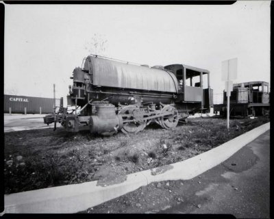

In a quick pass i get the (diagonal) field of view of the OP's camera as 117Âş. That is quite wide, and yes, there will be fall-off. But here's one on paper from my 4x5 with a 103Âş FOV:
(Scanned and inverted)
Mr. Pinhole seems to think this should be 4.69 inch coverage but what you see is actually over six inches. The camera has a 0.30 mm pinhole at 62 mm from the film/paper.
(Further edit):
I've not seen what the OP's pinhole plate actually is. The shot I show here is a hole done by dimple-and-sand in 1 mil brass shim stock -- that's almost a knife edge to begin with. If the hole is made in much thicker stock, the image begins to look like a tunnel view just from the sides of the hole interfering.

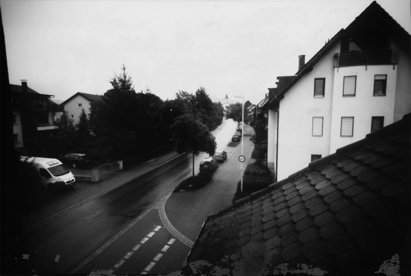

I found a deep box today (180mm) and it is a bit larger than 7x9, which is perfect.
I have being using coca-cola can aluminium to make the pinhole, but in this case I made the pinhole on the box cover and it may be thicker. I will make a bigger hole and place a pinhole made with cola can aluminium to see if it works.
I really like Jimmy's idea to put 5 pinholes. I may try it later on.

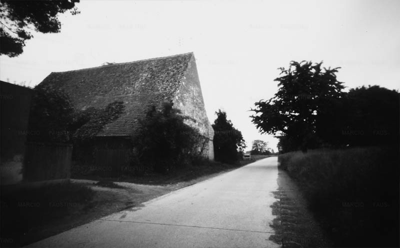

A made an other camera easier to load and now it image seems almost perfect.
I just have to make holdes for the sides bothers because the paper is following off.
It has a little bit vignetting but after cropping the edges it will be not very evident.
It has a 0.410mm pihhole
F-stop: 366
Focal Length: 140mm
I load a 9,5x7in paper in the camera but after crop I guess it will be 6x8in. Not bad. :smile:
