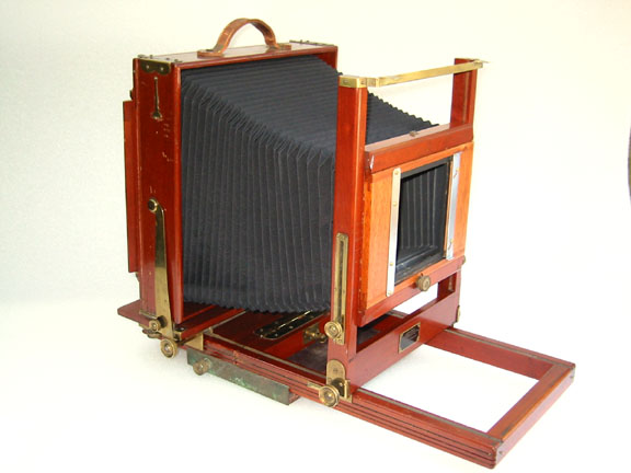

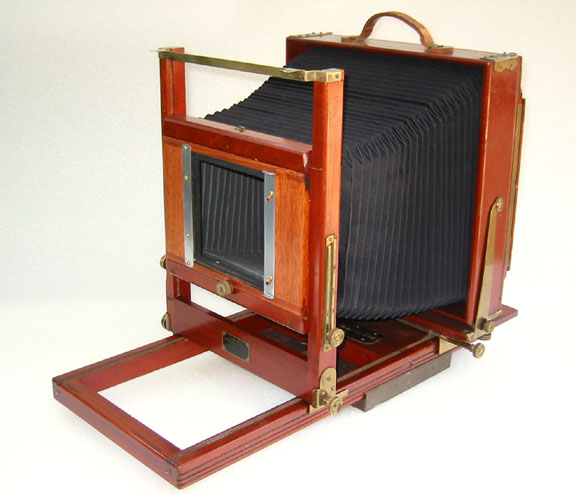

Well about 6 weeks later, and somehow a Eastman No. 2 7x11 ended up on my doorstep today :smile: One very happy camper, 7x11 back, 8x10 back (made for the 7x11 camera) and a home made (it appears anyhow) 5x7 back. The thing is a beast, but not as large as the 11x14 cameras that I have seen (which fits my criteria). A very kind member here made me a good deal on some 7x11 wood holders (yeah compared to modern 8x10's they are light).
Cut a couple of lens boards this afternoon, and mounted the 240mm Germinar lens in one. The view from the 7x11 back is pure joy (IMO), and the 240 seems to cover with a little movement.
The 7x11 back is a bit tight when inserting the film holder, so it either needs to be used or adjusted is my guess. Considering sending the back to Richard Ritter to see if he can fit a bail back to it (which would make it much easier to use - IMO). Since I plan to shoot with this beast and not look at it, the few nicks do not bother me at all (after all it is close to 100 years old).
Kerry (or anyone else) would love to hear some thoughts about lens in the 300-305mm that will cover. thinking about a 305 G-Claron, but wondering if a Fuji 300mm C f/8.5 will cover. Just something in a Copal #1 (no since in adding more weight).
may have paid too much for it but it, but then figure it will make me more than happy. if it becomes to heavy, or a pain to use can always sell it. did I mention how really nice the image looked on the ground glass :smile:

Aha! So it was you!
Virtually any lens which will cover 8x10 will cover 7x11. The diagonal is only six millimeters more. A 10 1/2" Dagor is very nice; it's the "long side of the format", a perspective I like.
The front lensboard arrangement looks very awkward extending as it does beyond the front standard and giving you something else to snag the camera on. What size are the boards? I had one (I think it was a 2D, actually) and replaced the front sliding lensboard with one I made which would accept 5 1/4" lensboards. 6" boards would've been nice, but a bit tricky with almost no clearance left at the top and bottom. As it was, I had to put the lensboard sliders on either side. But a 5 1/4" board will accommodate a #5 Ilex shutter so you can use something like a 10" WF Ektar if you want. But you already have the Germinar... Anyway, something to think about if you send the camera to Richard.
I've attached a couple of photos of that camera which show how I approached the lensboard issue. The bellows is from Western Bellows. Very nice bellows, but it took a while to get. There's also a not-very-good photo of a rather familiar scene taken with that camera. :smile:
It's a great format. I hope Fotoman's efforts with the full plate holders are successful so we might convince him to make some 7x11 holders to the Eastman spec.

Colin - will be using paper negs for now to try it out, but plan to cut 11x14 film down to 7x11. When the next call goes out for a special run to 7x11 will order some then. Also, need to contact someone at Fotoimpex to see if they can provide 7x11 (man I miss JandC).
Will - yeah, it was me!! Thanks for the lens info, thought that would be correct, but try not to assume too much.
The front lensboard will take some getting used to. So far have not figured out how to get the darn thing off. Removed the thumb screw that holds it in place, but there is a stop on each side that keeps it from sliding out completely. Guess it was pretty great idea for making 2 5x7's on one negative and gives some shift (in a strange kind of way). The slider board is roughly 61/2 by 14. This one has been modified (early mod it looks like) to take a board that is approximately 4 3/8 x 4 5/16 - pretty much the same size as my Eastman No. 1 5x7. Think a slider could be cut to fit the width of the front standard (no over hang) and then just not use the slider function.
I have one of the Ilex/Caltar 375mm in a #5 Ilex already mounted on a 5 1/4 board (the B&J and Korona are very close), so good thought about asking Richard about that.
Would love to have picked up your S&S holders, but could not justify the $ plus the camera (though it is a very good deal) - sigh!! Pretty excited about the camera, and can't wait to run some film through it.
One funny thing last night was checking the bellows to see how bad they are (yes there are pin holes, but really nothing I can't repair until later, or use a darkcloth) and the light was just coming out of the front standard. Could not figure it out, then found this hold on the top of the front standard and I was scratching my head wondering why on earth someone would drill a hold there....it hit me later that it was for a Packard shutter...duh!!

Wow!! Thanks for the pics Will! That is exactly what I was thinking about for the lens board. Looks great to me. Good to hear someone that has the Western Bellows, as I know that is coming sooner than later - still have the old red leather on mine right now.
As for that familiar scene looks good to me, think you are a bit to modest. Would be great if we can talk Fotoman into making some 7x11 holders, there seem to be more 7x11 shooter than I thought or they all must post here :wink:

I seem to recall (it's been a while...) that the sliding lensboard on mine had a cutout in the lip where the thumbscrew went through. Removing the thumbscrew allowed it to be removed. Don't know how it is with yours, but I'm sure you'll figure it out.
I have the 375mm Ilex and it's been a good performer for me on 8x10, but with ample coverage for 11x14. It and your 240 Germinar should be a nice kit for the 7x11. The Yosemite shot above was taken with a 16 1/2 RD Artar, just for reference. If your eye is used to 8x10 (or similar aspect ratio), the 7x11 looks wide by comparison, even though it's only an inch more in the long dimension. I remember being surprised when I set up that shot that I had to go so long on the focal length. But it's just a matter of getting familiar with the format.
Look forward to seeing your photographs.
