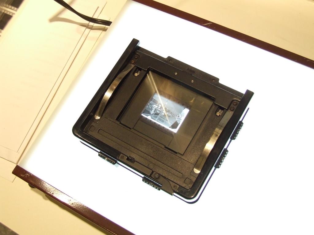

I have a Meopta Opemus 6 with a Color Head.
I wandered around internet looking for the right focal lenght for printing 6x6 and found that 75mm would have been good.
However, this is what I see:

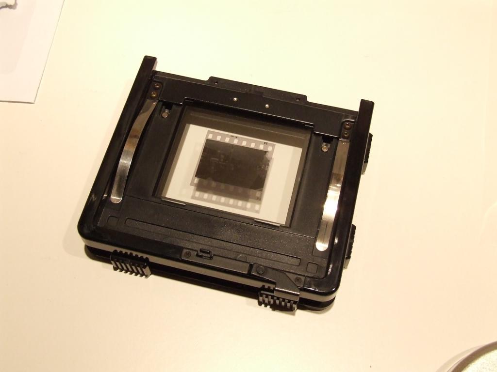

and the negative carrier
So, what do you suggest? :sad:
Is it a 6x4.5 negative carrier? 75 mm should cover 6x6, although 80mm is often used. If the coverage is insufficient for the format, you tend to lose the corners, rather than a strip of the negative.

Just measured... 6cmx6cm

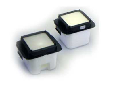

The colour head takes different sizes of mixing box for different formats. Is it possibly a 35mm box?

To me, it looks like most of the image is projected, but there's some some of obstruction partially blocking the image. I can still see the top and bottom parts of the image but darker.
It appears you may have the wrong size light mixing chamber installed for the format desired.
Does this enlarger have an adjustable masking accessory built into the light path? If so, you need to adjust it.

Remove the lens, leave the negative holder out, turn on the enlarger and look up through the lens hole to see what might be obstructing the light path. If it were a lens problem the corners would vignette, it appears that something is obstructing the light path. Perhaps a loose part in the mixing chamber.

You need to set your masks for 6x6 to project the whole negative, unless you are cropping. Do you have the manual? If not, just slide the 4 mask blades out with your fingers. Look at the difference between the two pictures below and you should be able to figure it out.
Read up on lens coverage, lenses produce a round field of coverage. You need to set your masks for 6x6 to project the whole negative, unless you are cropping. Do you have the manual? If not, just slide the mask blades out with your fingers.

Ok, the reason I did not think you had the 35mm mixing chamber is that pictures of the 35mm chamber I found on the web look like it has a square opening like many other mixing chambers that allow horizontal and vertical placement of the negative. I guess, since the negative stage does not rotate, your 35mm mixing box has a rectangular opening, right?
I have the same enlarger and colour-head. You are using a 35mm light mixing-box. When you fit the correct mixing-box it will be fine.
