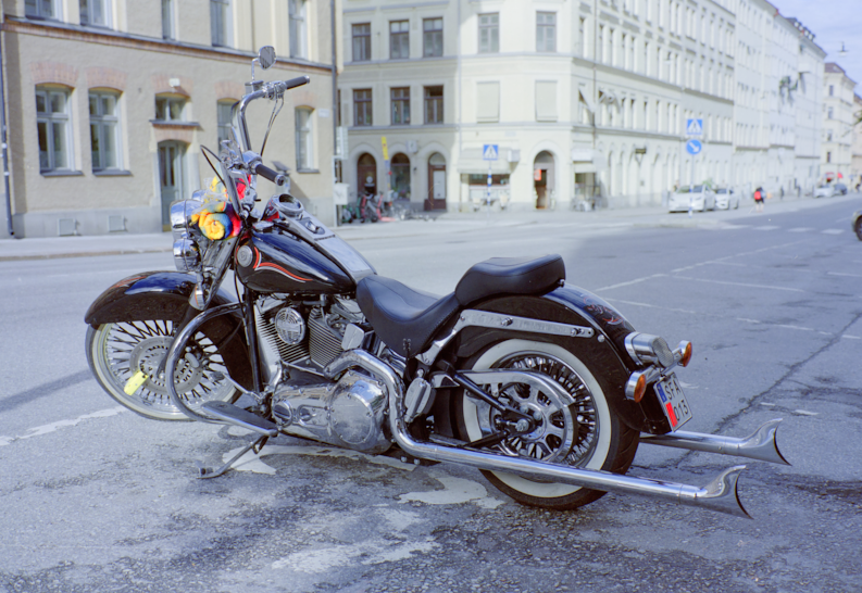

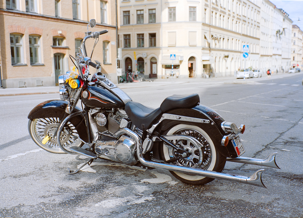

Kodak Portra 800 shot on a Fujica Professional 6X9 and developed in Cinestill 2-bath developer.
My scanning setup is far from perfect, but it gives an idea of the "resolution" in these negatives. Click image for full resolution.

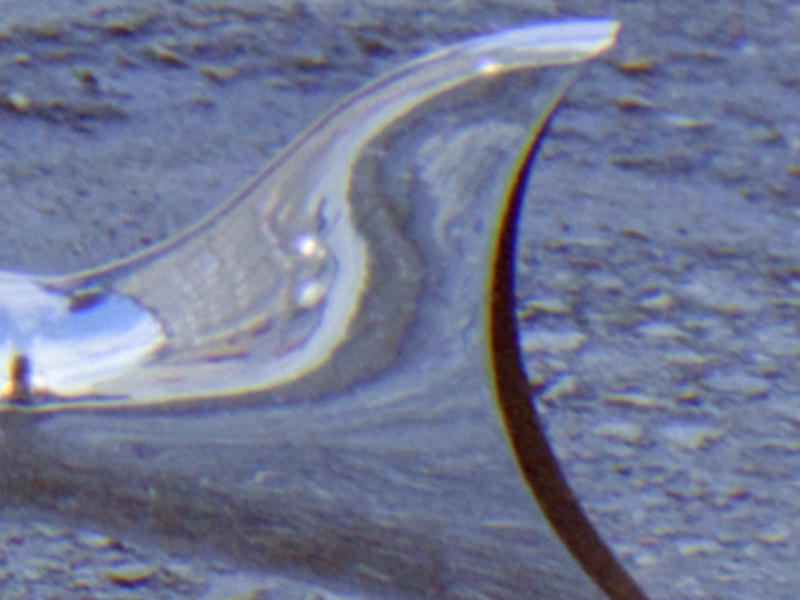

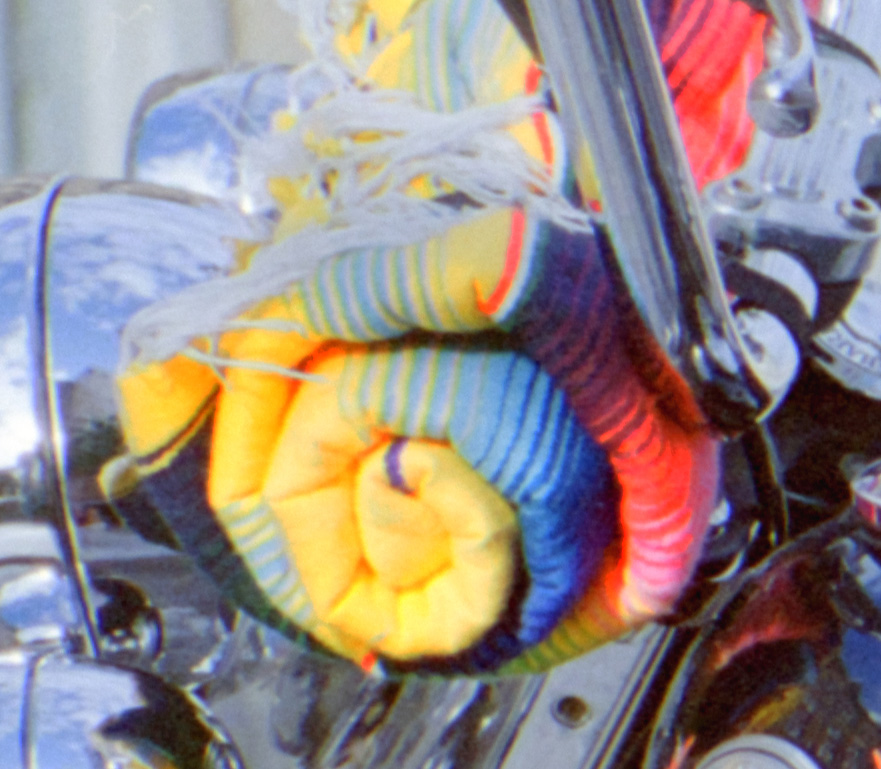

Coincidentally, and not to rain on anyone's parade, but crop #2 illustrates how the colors are pretty badly mangled in some places. There's also a great deal of color fringing (blue/yellow) that I suspect originates in digitization of the negative, not in the original exposure. Of course, we're pixel peeping here - which was kind of the point of the exercise, so perhaps it's OK if I note these issues.
I’ve rescanned and converted this multiple times, and noticed that the reds are unruly every time. Other scans have also come out with certain colors looking over saturated.
I haven’t figured out what causes the problem yet.

It looks to me like what happens when colors are out of gamut.
Certainly so, but where in the process this happens, is not clear to me yet. It might just as well happen during the inversion & color balancing step.

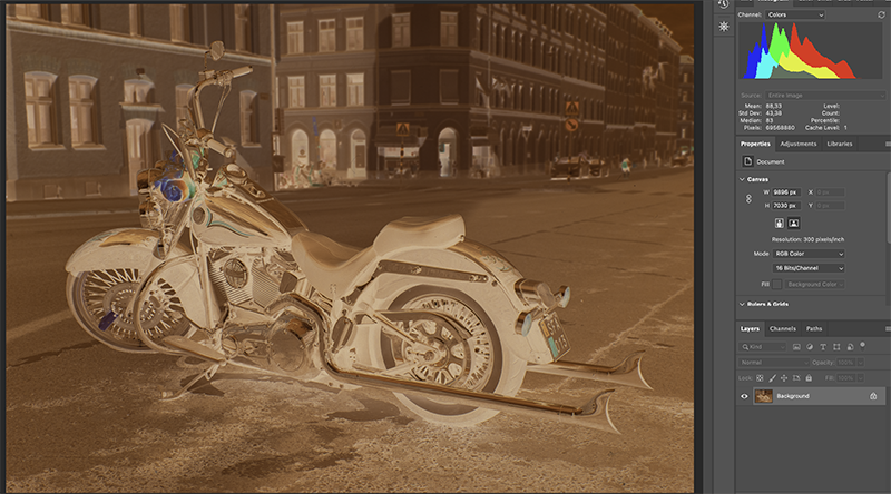

Yeah, these issues can be difficult to troubleshoot. I'd start by looking at the histogram of the original capture, then keep an eye on it as you invert, color balance etc. At some point you should start seeing data on the red channel bunching up towards the extreme edge of the histogram. But like @loccdor says, an ICC conversion step can also cause this and those can sometimes be tricky to identify.
It looks to me like what happens when colors are out of gamut. I don't know your process but sometimes changing the ICC profile from sRGB to Adobe1998 helps with that. The exposure level of the scan could also be playing a role.
This was a good tip, it seemed to tame the unruly reds. Thank you!

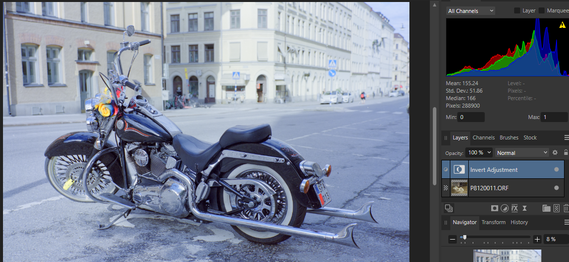

I have it open, but the highlights look really funny. Are you sure the film is properly fixed?
Also, the blue channel seems to be clipped in the digital file; I'm running out of steam on the blue highlights - they blow out:
I think you may need to give a little bit more exposure when digitizing the negatives so you end up with more headroom on the blue channel. I think it'll make color balancing the images easier, the slope-off into the specular highlights will become more smooth and the overall risk of ending up with out-of-gamut colors is lower.

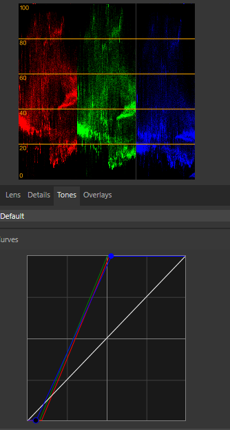

Here's the RGB histogram in my RAW converter:
Note how the blue channel is all bunched up to the left. You've got some room on the right on both R and G, so I'd suggest using that in order to give blue a little more room. Dial in 2/3 stop more exposure, see how that goes.
I also have to admit that I have some doubts about the Cinestil CS41 developer used. The colors are just...wonky. I can't get them to balance out, and what I need to do to get close to OK, is very non-linear:
What certainly doesn't help is the uneven illumination of the negative, that throws the color balance into different directions across the frame. Look at e.g. the sunlit tarmac along the left edge of the frame vs. the center of the frame above the saddle of the bike. Here's a sample of both areas:
I balanced the light-midtones to give a more or less neutral hue on the tarmac, but then it goes lavender in the left and right of the image.
All this doesn't show up very clearly in the original image posted in #1, but that's mostly because it's very desaturated. Crank up the saturation and the same problem pops up, so it's not something to do with my RAW converter etc. (Also note that Portra 800 isn't all that desaturated if you optically print it onto RA4 paper. It renders quite a rich palette in my experience, so I wouldn't consider it a 'flat' film or something along those lines.)

Oh, I think I got the gist of it. It's an adjustment I never find necessary on color scans, but here it saves the day. It's along these lines:
I didn't have to do anything special, really. As always I used libraw (dcraw) to process the raw file to get linear tiff file. I then used my standard routines for inverting and nothing seemed to be off.
I now used Adobe raw processor and still the inversion is... uneventful. Not surprising, since the histogram of the image area looks pretty decent.
It may have something to do with how Rawtherapee handled the raw on my end. I had to desaturate the blue channel dramatically in post to get a similar result to yours, which is something I never need to do on my scans. I suppose Rawtherapee somehow adjusted the white balance in such a way as to compress the blue channel; see the histogram it showed. It's very different from yours.
The color balance variation across the frame is present in your version as well, so that's really part of the capture.

We're also dealing with at least three different softwares, and three different methods of converting I think.
@koraks my histogram looks more similar to yours.

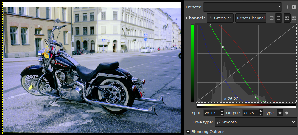

After I set the white balance to the film base and select Adobe RGB profile:
I then crop, because I don't want the film base in the histogram data, and adjust each individual RGB curve to just before they clip:
I then do fine adjustments to the curves using the RGB parade to gauge how even they are:
Then I I leave RAW developer and add an Invertion layer
Then I use the curves to fine tune again:

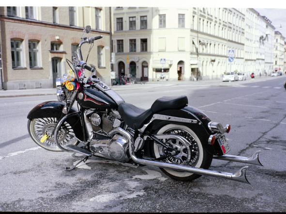

Here is a quick go at it using the Negative Lab Pro plugin for Adobe Lightroom. Normally, after making the basic conversion to color with NLP, I would work on it some more in Lightroom. Specifically, I would probably select the upper right quadrent with a linear gradient and try to warm it up a bit to better match the color temperature the rest of the scene. And those blue traffic signs might need a bit of taming as well. I can post the Negative Lab Pro settings I used if anybody wants to see them.
Edit: Compared to @brbo's version, it looks like I got my color balance a little warm -- except for that right side which is too cool.
That looks good too. The traffic signs actually look close to real life.
