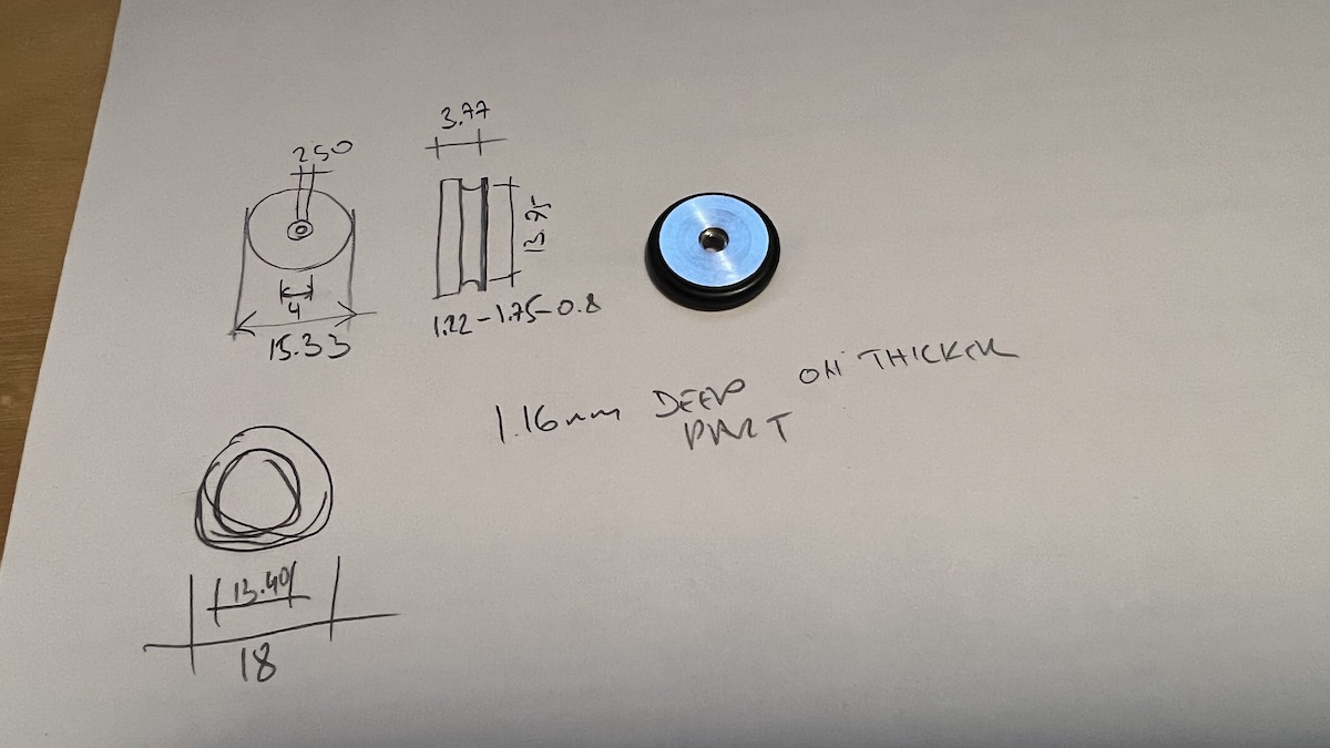

OrientPoint, Dan ( Nokton 48) was very generous to sell me his last set of rubber wheels for A70 magazine. Before that I was talking to machinist and those can be machined fairly easily, if you know right dimensions. Let me know if you need measurements?
Yes please on the dimensions. I'd love to have an A70 back working with non-perf film, as most of what I have is not perforated. It looks like it's easy enough to install the wheel once you have it.

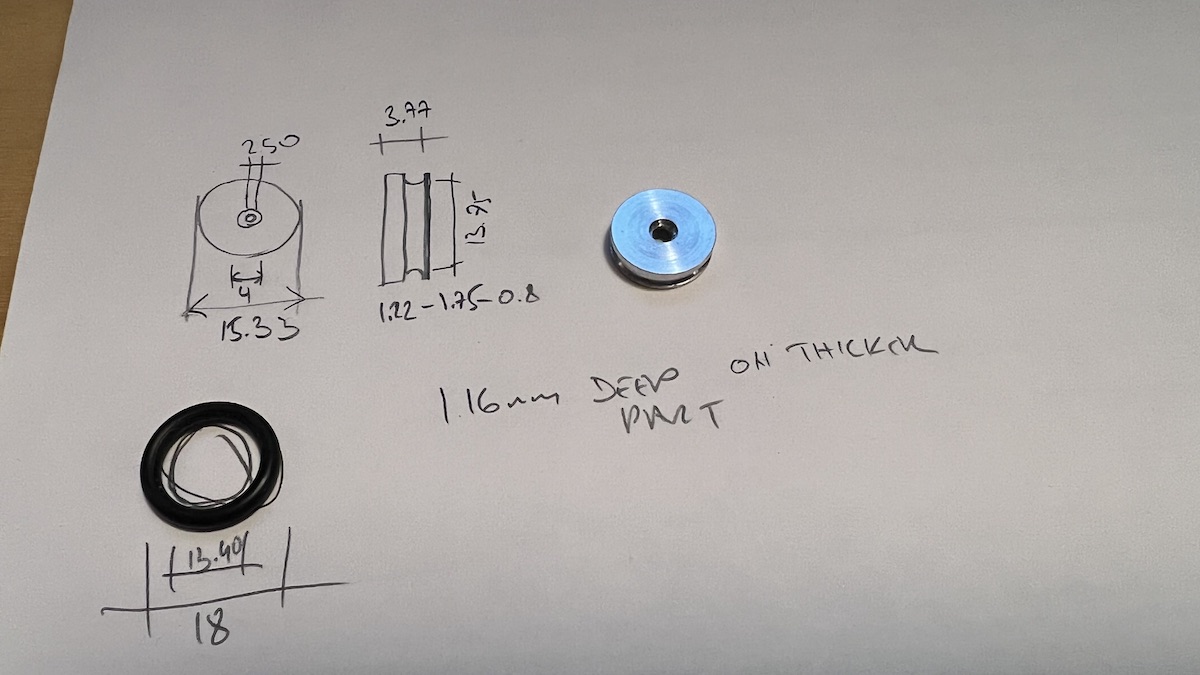

Hi OrientPoint, sorry for "technical drawings", as you see it's not my strong point. All in mm. That 2.5mm central hole is threatened. Most likely metric? Your machinist will have to measure screw that holds gear wheel you are replacing with this one.
Please let us know how it goes? It's not big deal for machinist to make a few pieces at the same time.

Thanks! Now I need to find a machinist... maybe SK Grimes can do it?

Definitely check with SK Grimes, maybe they even have some alreaready in stock? Back in the day one portrait photographer from East Coast with Mexican last name (sorry??) was making those wheels and selling them. That was what I was able to find a few years ago when I was looking for them.
I'm sure any machinist can make it, it's not complicated part at all. Now, there is question of the price you are willing to pay for it?

I wrote to SK Grimes. If anyone can do it it would be them. Price-wise, we'll see. Thanks again for sharing the dimensions!
